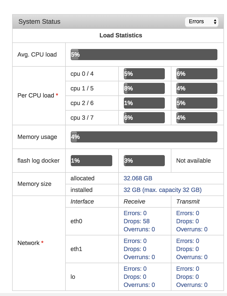

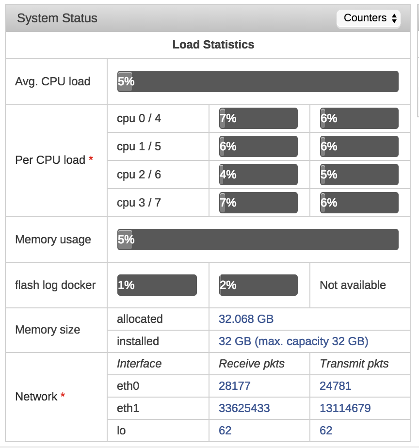

I can't see that particular setting -- I can see the Network and system status... but that's it. ...and I think that doesn't work for me since I just reset the server, and it's since last reboot... so I'll run some more tests and see if those errors appear. 5a6611ae7206f_ScreenShot2018-01-22at8_11_00AM.thumb.png.98884f741f12efad493a3986a466705e.png5a66119f0c366_ScreenShot2018-01-22at8_10_48AM.thumb.png.47762368aa93038e3106348d3b0dcf05.png

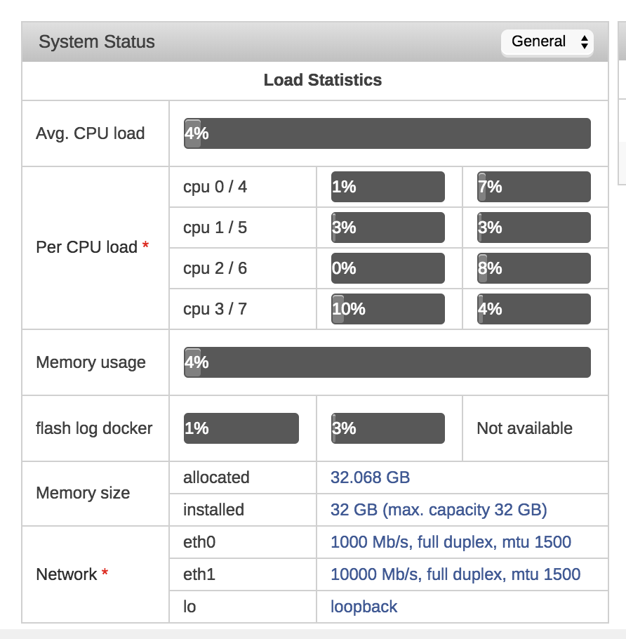

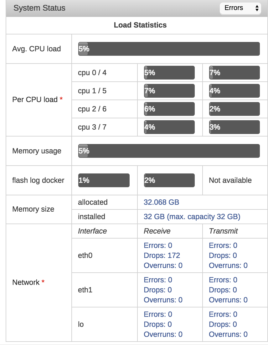

Update: Been watching the server remotely via our VPN... and interestingly the built-in Gigabit Nic is having issues, not the 10GBe.
Anyway no error found. So, I don't think problem on ethernet cable.
