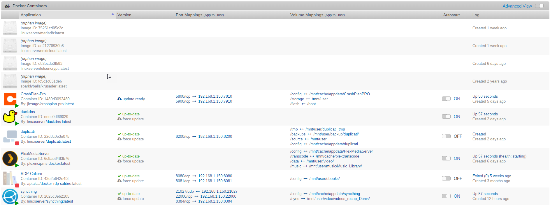

Now if I click on the "advanced" button in the docker view, I get this:
Why are my otherwise perfectly working dockers gone? And why are the others just fine?
No amount of rebooting will help there unfortunately. So as it took me weeks to get them running OK to start with, and as 6.4 changes a few things, I thought I'd better ask for advice first, before trying to reinstall or mess up with the existing settings. My gut feeling was to leave the settings in appdata cache and try to reinstall... but if I can get them back with something simpler, I'm all ears!

Delete the orphaned images.  Reinstall them from the Apps Tab, Previous Apps.  No changes to the template will be necessary.
If when installing, they return errors, then probably there's an issue on your flash drive, or you entered in information previously into the template that is no valid on 6.4

I'm gonna try that and report back. However, those dockers were running on 6.4 for 2 days before magically "getting orphaned". Nothing was done on my side, only autoupdates from the CA update plugin.
