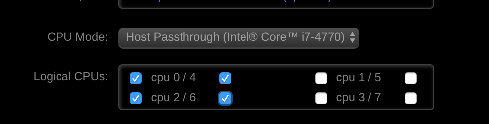

Other suggestions for VM performance, always leave one core free for Unraid don't pass all cores to the VM.
If you are passing only 2 or 3 cores make sure you pass through the Hyperthread cores, in 6.4 these are now grouped together it will say something like 0/4 and you tick them in pairs.
As seen attached.
