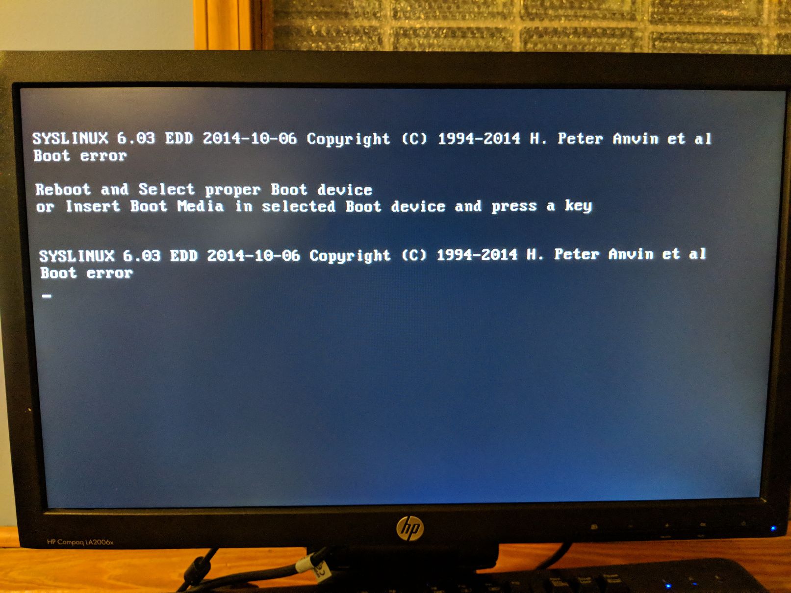

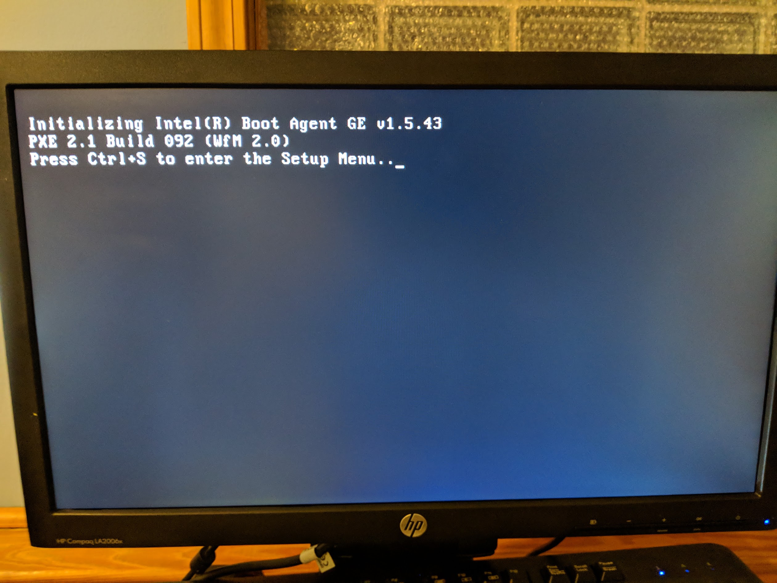

Here is the Error as it displays after power up, with any SATA disk plugged in and powered.

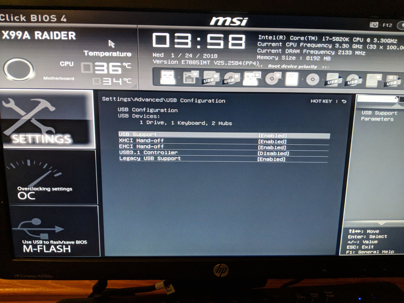

Boot order

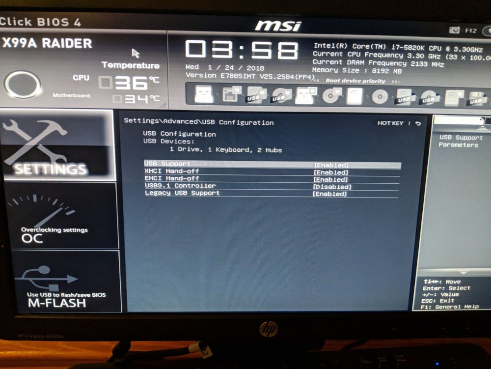

USB Config in BIOS

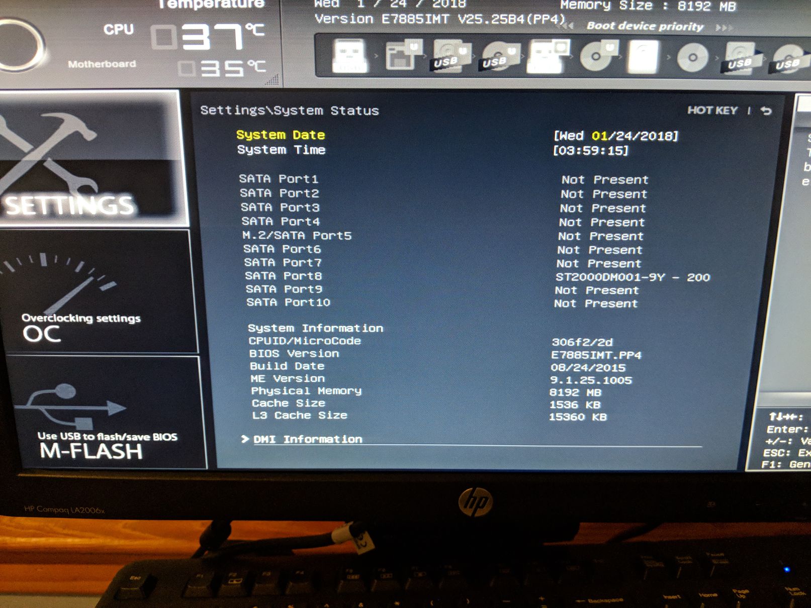

The one SATA drive that is plugged in, have tried it with other drives and multiple drives at ones, same error.

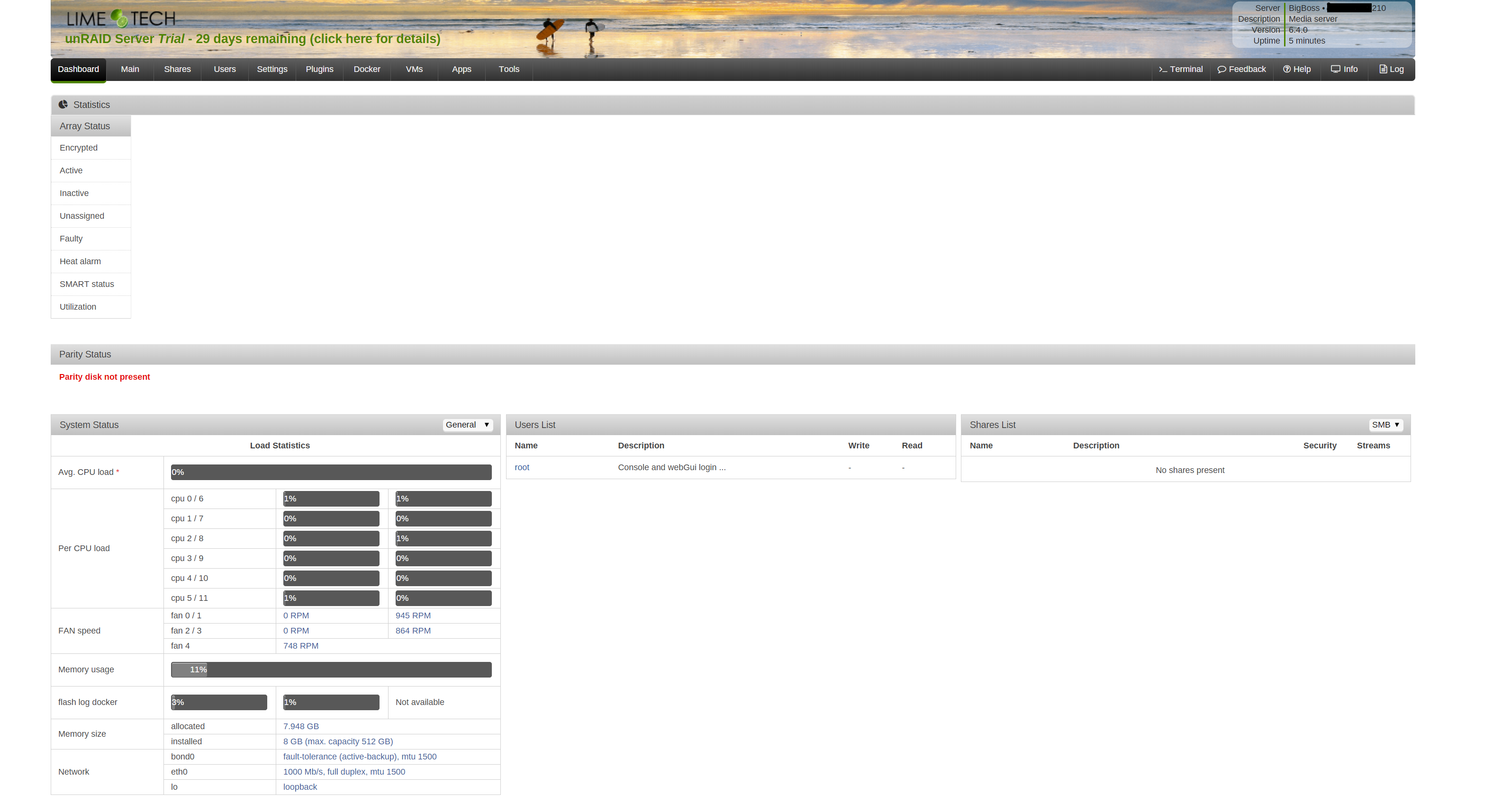

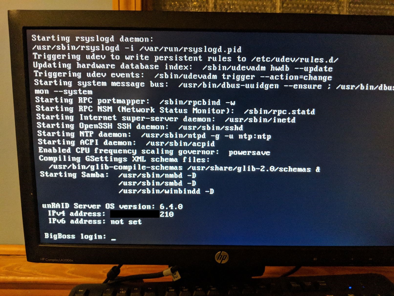

Successful Boot Up
Logged in UnRaid on local network machine.

Still wonder if it isn't trying to boot from the wrong device. Usually there is a key you can press when it first comes up that will let you manually select the boot device instead of relying on the BIOS setting. Have you tried that?

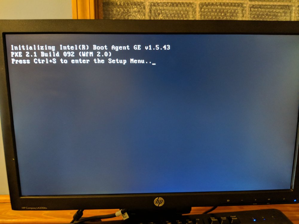

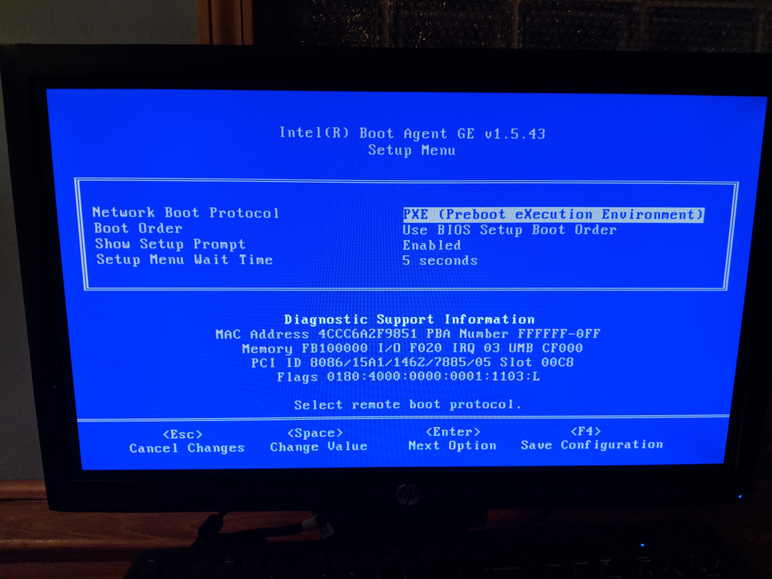

I was able to get to this menu before boot up..
Quite the mystery.  A few more things to try:
a) Usually you see XHCI handoff enabled and EHCI handoff disabled.  Also a little strange your USB3.1 controller is disabled.  You might try changing those settings.

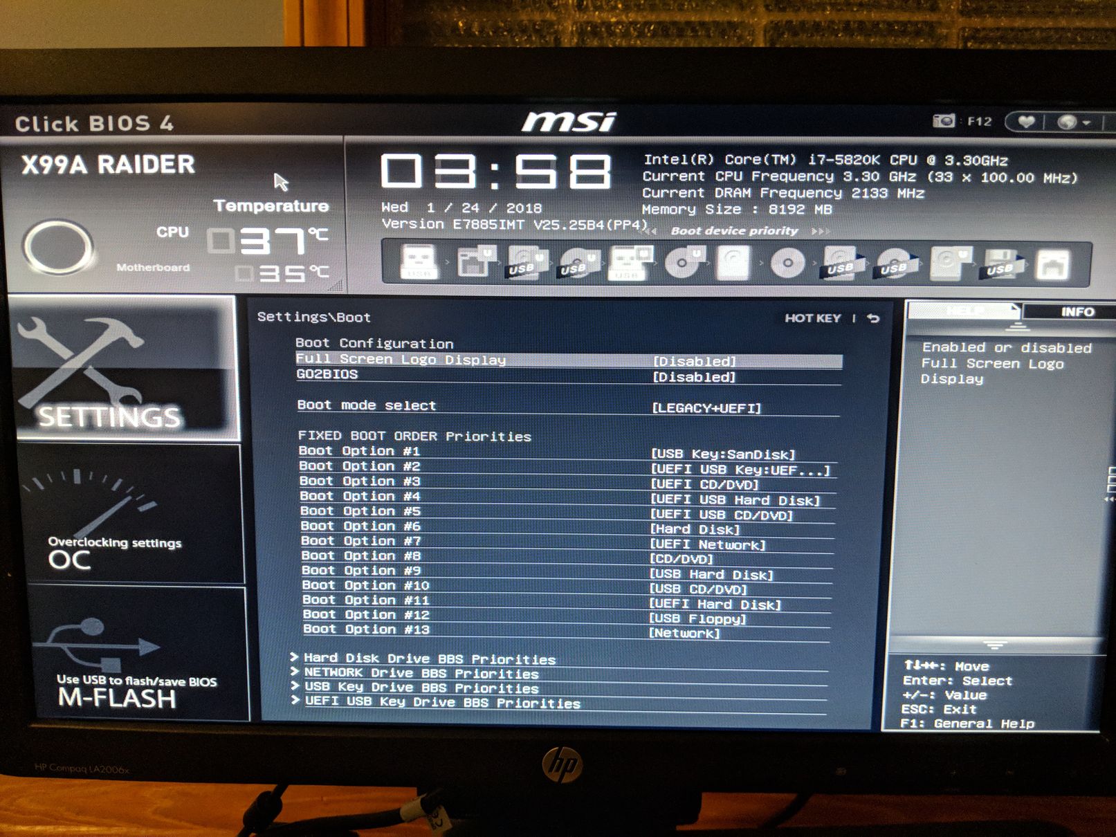

b) Maybe try UEFI boot.  To do this you can use our USB Creator tool and select EFI boot.  Alternately you can boot unRAID without and drives, then go to Main page and click on the Flash device.  On that page you will see an option to enable EFI boot mode.  After changing that, click Apply and reboot.  Get into bios and change the boot order so the "UEFI Key: SanDisk" is in first position.
c) Boot unRAID without drives and then after it comes up, hot attach a drive and see if unRAID detects it (it should).
Have you tried changing any of those? The way it seems to me that screen should work:
The left column is naming a setting, and the right column is showing what that setting is set to. At the bottom, it tells you what keys to press.
Currently,  the setting for Network Boot Protocol is selected. I'm not sure it should be set to PXE. Maybe it is defaulting to that because none of the hard drives are bootable. Can you change that to something else by pressing <Space>?
If you press <Enter> it should select the next setting, Boot Order. That setting is currently set to Use BIOS Setup Boot Order. If you press <Space> maybe it will let you change it to boot from a specific device. Could be a popup selection, or maybe you will keep pressing <Enter> until the one you want is selected.
Then, I guess <F4> to save and exit?
PXE and Boot order: There Are no other choices for this option.
Only thing that is changleble on blue menu is Show Setup Prompt and Setup Menu Wait Time.

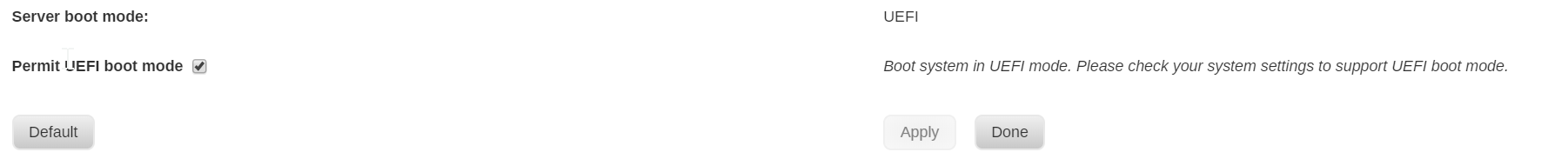

THAT WORKED!
I am currently clearing the two drives I had ready..
I followed your "Alternative steps" and went to main page, clicked on flash and at the bottom I saw this, in the image below.. While your post mentions EFI boot, something I did not find. UEFI and EFI same thing?
I set my BIOS to match that and BOOM!
I also tried various versions of option A, but no luck, after that I reset the BIOS settings and tried option B.
Hopefully everything is right and things go smooth going forward as I add disks to array.
