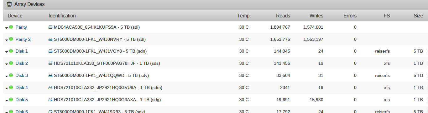

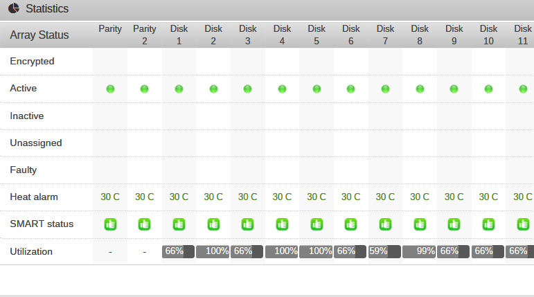

1. Temperatures on the main page always show as 30 degree Celsius regardless of the real disk temperature.  The real temperature is available on the

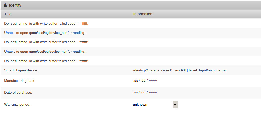

I understand all the nuances of using smartctl and it's command line, and yes, under each specific disk, if you put in the controller slot and the controller address you can get the smart listing under each disk. The smart default page for all the disks only helps with inputting the controller address (which changed between 6.3 and 6.4 btw from sg25 to sg24). This enabling does not help for any system alerts (especially for temp) or any preclear reporting. The emhttp is the source of many of the main smart config interests, and it doesn't use the drive config options under each drive...it is hard coded to use generic smartctrl commands and not the special areca, 3comm...etc...switches. The most obvious limit to this is that the main page will always be stuck at 30degC regardless of the actual temps.
The bad or missing sense data is a pain in the butt on the console, but 6.4 may have changed some of that (not sure because all of my drives have to manually be reset to the new controller address...fun, fun)

My issue, as originally stated, was having the main page support (emhttp) reporting the correct smart temperature instead of the default 30 degrees.

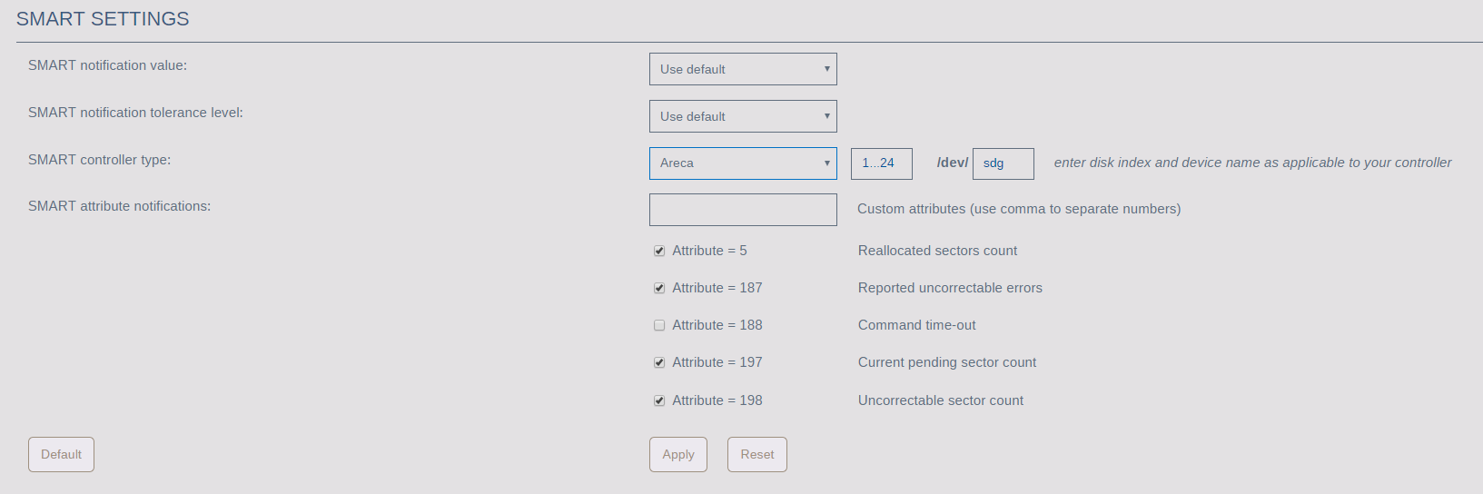

What I wrote in https://lime-technology.com/forums/topic/56820-bad-missing-sense-key-scsi-data/ was an attempt to start a discussion on future unraid full support of non-generic controllers since smartctl has been supporting them since something like 5.3 (unraid 6.4 now running 6.5)

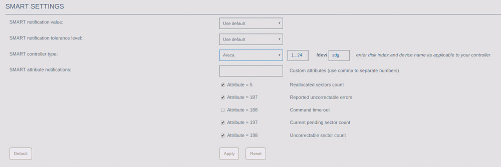

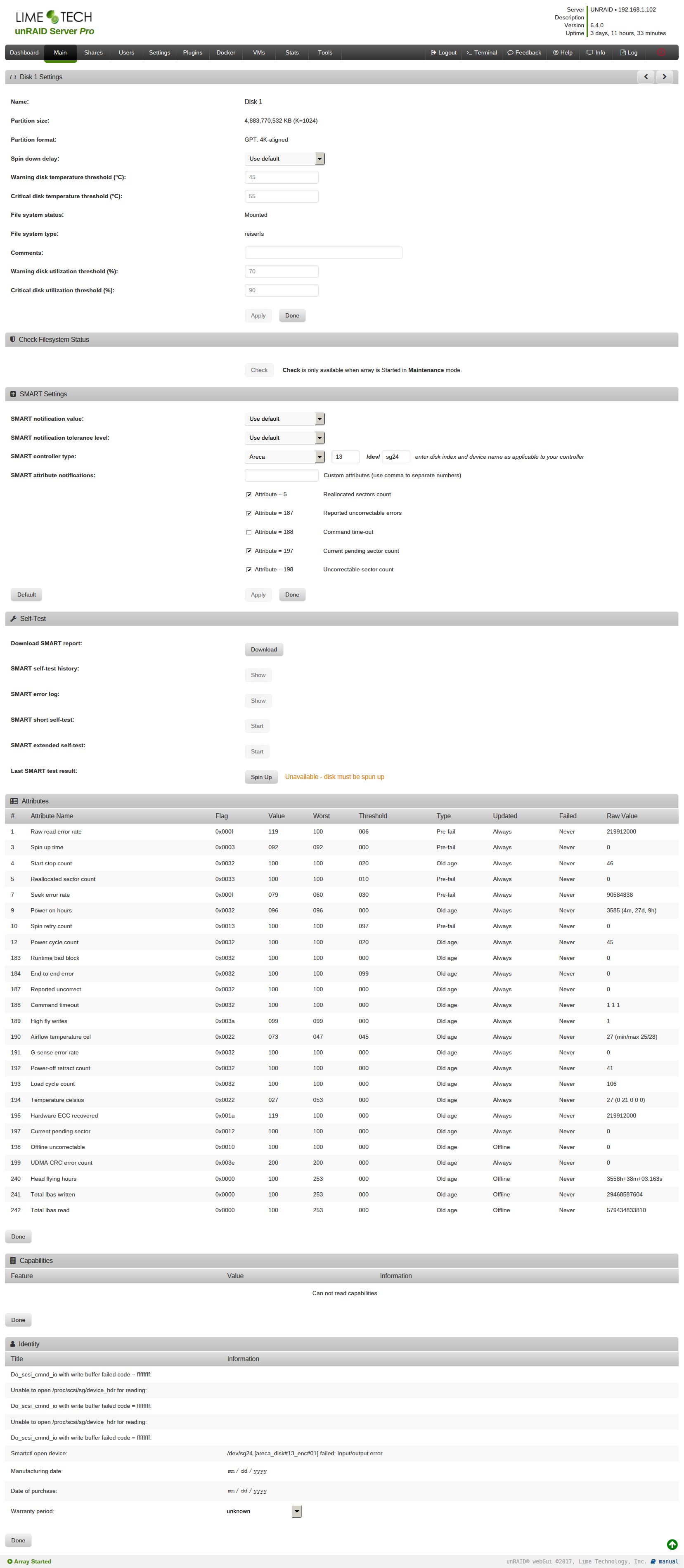

The GUI does support specific controllers. From the Main page click on the desired disk and look at SMART settings.
Each disk needs to get the correct parameters (index and device name).
With the correct settings in place you will be able to generate SMART reports, monitor temperature and allow notifications when disk temperature exceeds thresholds.
The dashboard and the main page (emhttp) are the primary places of non functioning smart.  I'm not going to enter each drive page to verify temperature of each drive when I have a dashboard/main page that displays the data front and center incorrectly?

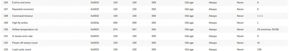

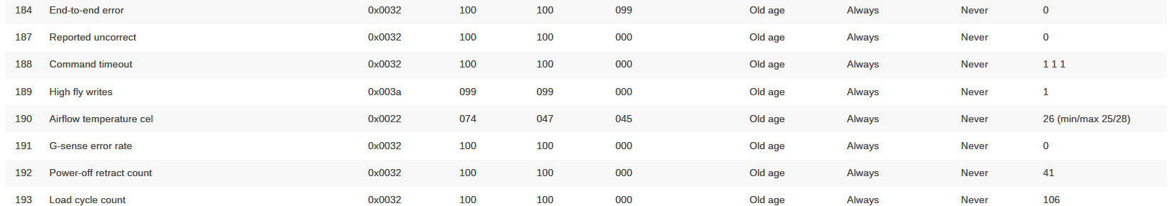

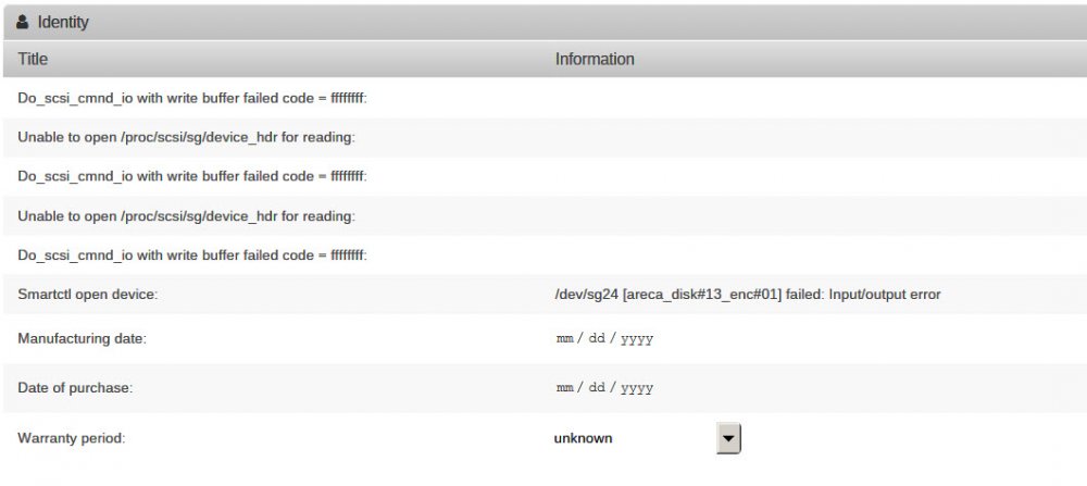

Also, it looks like the second half of the smart information page seems to pull some sort of corrupt data?

The first box after specifying areca would be the port on the areca card the drive is on, first number counts, second one ignore...pain in the butt to connect with the actual drive...you have to pull a manual smart report and correlate with serials...I use this for each of the 24 slots...
echo -n "01" ;smartctl --all --device=areca,1 /dev/sg24|grep "Serial Number:"|cut -d ':' -f 2
echo -n "02" ;smartctl --all --device=areca,2 /dev/sg24|grep "Serial Number:"|cut -d ':' -f 2
the second box would contain the address from lsscsi -g|grep "Areca"

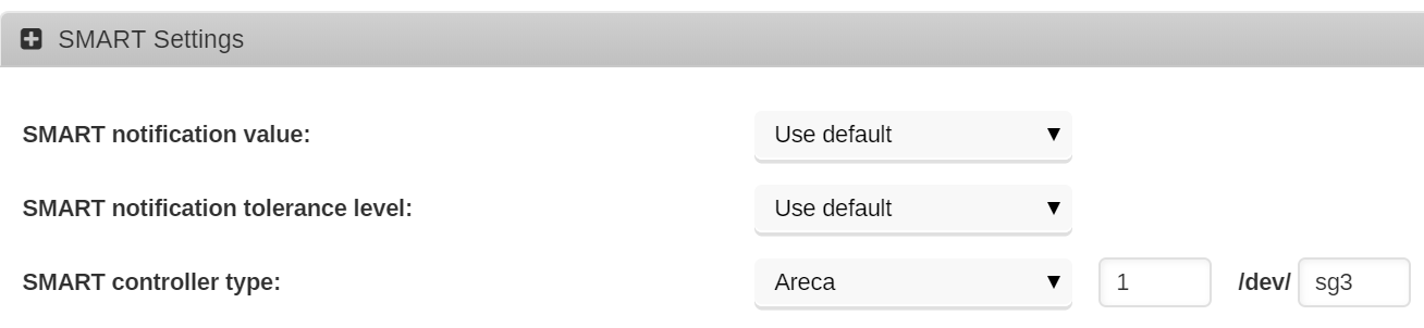

Yea - I had the /dev/sg3 and the areca number 6 in my command.
But looks like there has been an update since rc6, as I have 4 boxes not 2. And putting the 6 the right place didn't help. Will try again after I upgrade.

smartctl --all --device=areca,6 /dev/sg3

I think there were 3 or 4 boxes for 6.3.5 as well, but only two were pertainent...now with 6.4 only the two boxes are there.
6.3.5 and 6.4.0 use different versions of smartctl. Setting fields are based on the latest documentation of smartctl.

On disk settings, set the controller type options:
5acb7806101a6_Capture-ArecaConfigSettings.thumb.PNG.d2bbe5b5387f59b3b28ea652b73c34a0.PNG

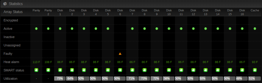

@bonienl may be able to advise. 86F = 30C, and I think Areca reports 30C as the temperature when running a non-Areca optimized smart report.
The temperatures displayed on the Main page and Dashboard page get their information from SMART reports generated by emhttp.
Can you post such a smart report? These reports are located in the folder /var/local/emhttp/smart.
