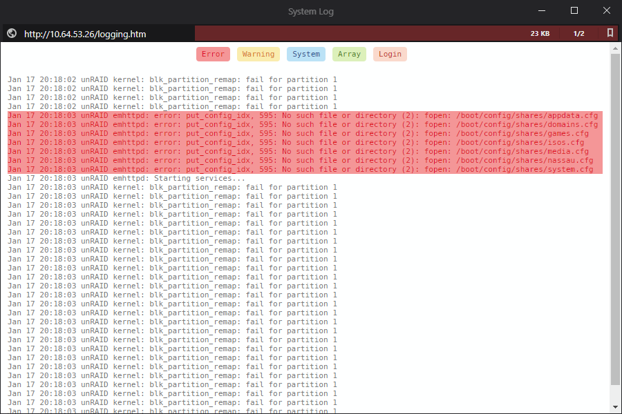

This has been happening to me for a few weeks now. It started when i was on 6.4 rc10, but not right when I installed that, because I used that for months. But it started a few weeks ago and has persisted on into 6.4.0 stable. Seems to happen a bit after the server hits a day of uptime, more or less.  If I visit the WebGUI its back to all the default theme settings, and is full of errors and only partially working. All of my shares are publicly visible, even hidden ones, and ones that are not shared period. The only way I've found to fix it is rebooting the server, but it happens again when get a little past a day of uptime. I'm attaching what's in the log when it happens, its just full of this, it scrolls on and on with the same error over and over and over.
Any ideas what the heck is going on? I'm tired of restarting every day.
Thanks.

But these are definitely flash drive errors:
Jan 24 03:11:16 unRAID kernel: FAT-fs (sda1): Directory bread(block 29896) failed
Jan 24 03:11:16 unRAID kernel: blk_partition_remap: fail for partition 1
Jan 24 03:11:16 unRAID kernel: FAT-fs (sda1): Directory bread(block 29897) failed
Jan 24 03:11:16 unRAID kernel: FAT-fs (sda1): Directory bread(block 29898) failed
Jan 24 03:11:16 unRAID emhttpd: error: put_config_idx, 595: No such file or directory (2): fopen: /boot/config/shares/domains.cfg
Jan 24 03:11:16 unRAID kernel: FAT-fs (sda1): Directory bread(block 29899) failed
Jan 24 03:11:16 unRAID kernel: FAT-fs (sda1): Directory bread(block 29900) failed
Jan 24 03:11:16 unRAID kernel: FAT-fs (sda1): Directory bread(block 29901) failed
Jan 24 03:11:16 unRAID kernel: FAT-fs (sda1): Directory bread(block 29902) failed
Jan 24 03:11:16 unRAID kernel: FAT-fs (sda1): Directory bread(block 29903) failed
Jan 24 03:11:16 unRAID kernel: FAT-fs (sda1): Directory bread(block 29904) failed
