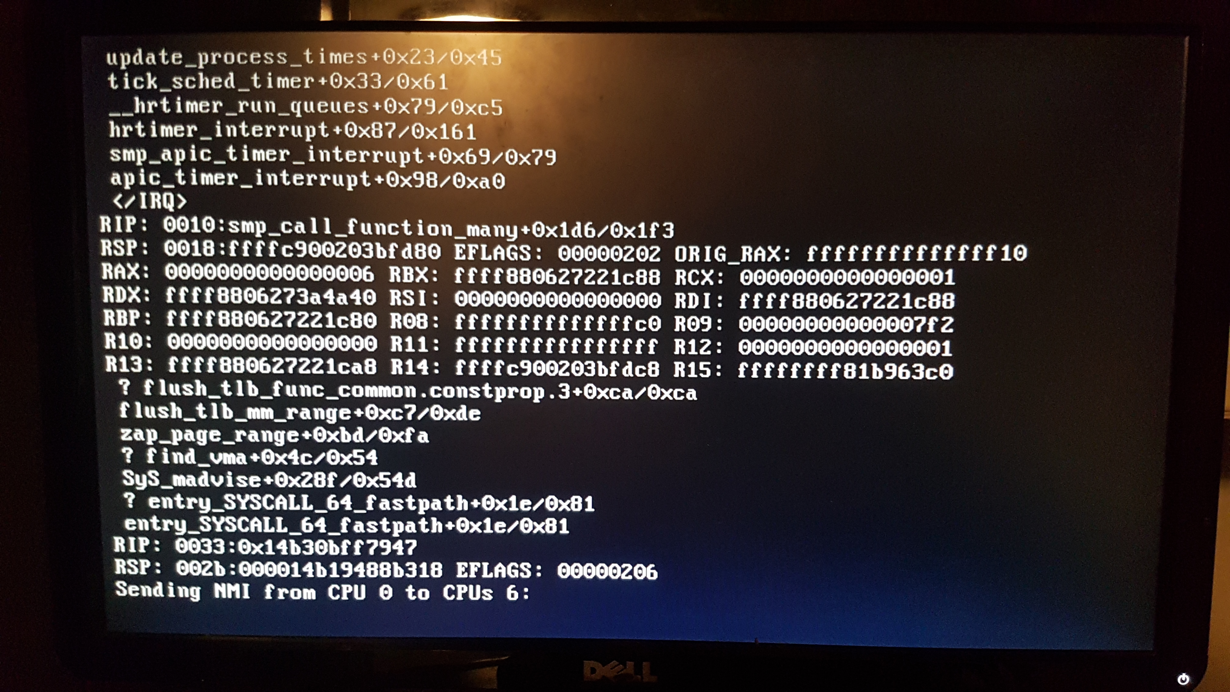

The second issue happened a day or 2 ago where my VMs went down I got my PRTG alerts and I went to take a look and the web interface was down. I looked at the monitor hooked up to unraid and I had the following message on the screen. Sadly I did not have FCP in troubleshooting mode to get log files20180228_224530.thumb.jpg.d65907e3dffb87be6d33a8d07e389897.jpg
