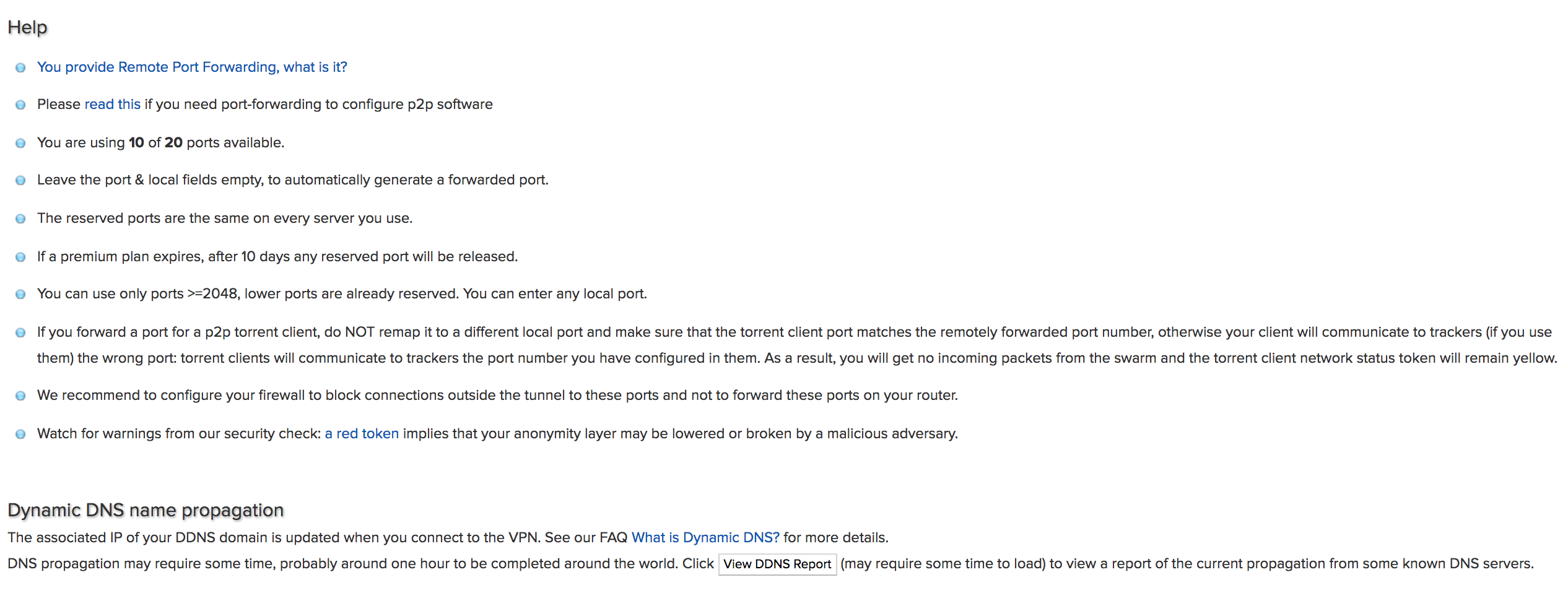

Fyi, here is the help for AirVPNs port forwarding:
