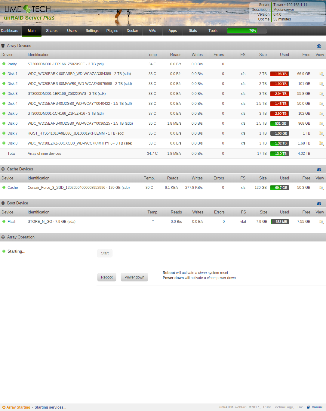

Recently I upgraded to 6.4.0 and also installed a new HDD, though I'm not sure which happened first. I have since been having a few problems.

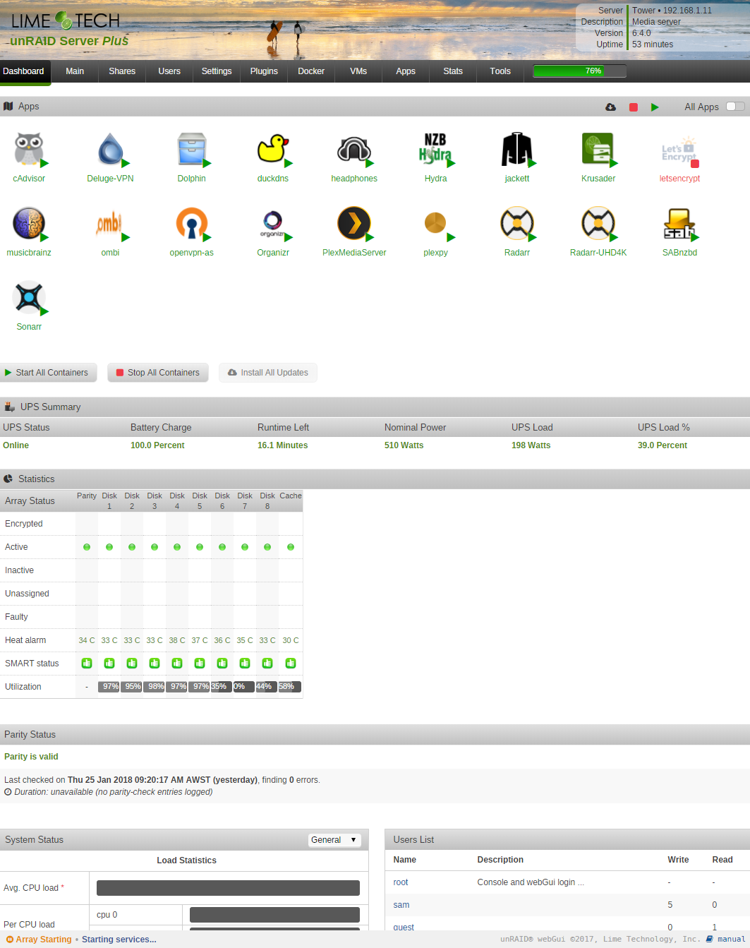

The main 'scary' one definitely showed itself directly after the 6.4.0 update/reboot. The array is taking forever to "Start", and I put that in " " because for all intents and purposes it seems to be started, ie , all my shares are available in windows, and my dockers are starting and working (mostly, I think something is up with LetsEncrypt). There just seems to be nothing to access in 'Array Operation' on the Main tab. It does seem to come up eventually though (...

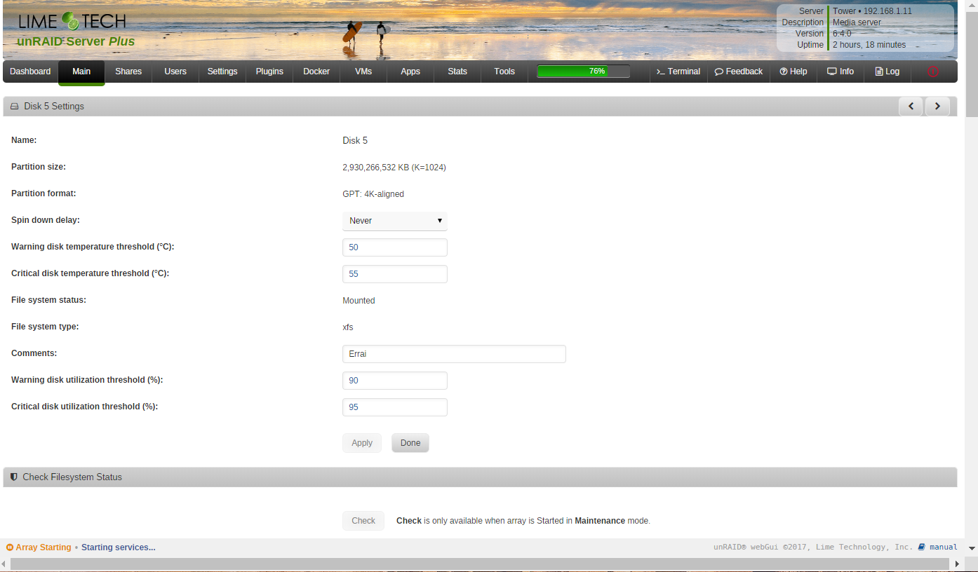

Thanks for pointing me in the right direction, but what exactly is telling you its to do with disk 5??
Also, that link says
You should see a page of options for that drive, beginning with various partition, file system format, and spin down settings. The section following that is the one you want, titled Check Filesystem Status. There is a box with the 2 words Not available in it. This is the command output box, where the progress and results of the command will be displayed. Below that is the Check button that starts the test or repair, followed by the options box where you can type in options for the test/repair command. The options box may already have default options in it, for a read-only check of the file system. For more help, click the Help button in the upper right.
But, I've have had to reboot since the first post, but still 2+hrs since this boot and my Array still hasn't started. 20180126_1701002.thumb.png.a0f93d670ca16a192ecdc6b1cafa5d86.png
Jan 26 12:20:47 Tower kernel: XFS (md5): Unmount and run xfs_repair
md5=disk5
It won't start until you fix disk5
Forgot to mention, since you have array autostart enable you need to disable it first by editing disk.cfg on your flash drive (config/disk.cfg) and changing startArray="yes" to "no", reboot and then start the array in maintenance mode and check filesystem on disk5.

Is it weird that my file shares and dockers are working now without the array started?
It might end up starting and you'll have your shares but the data on disk5 will be missing.
