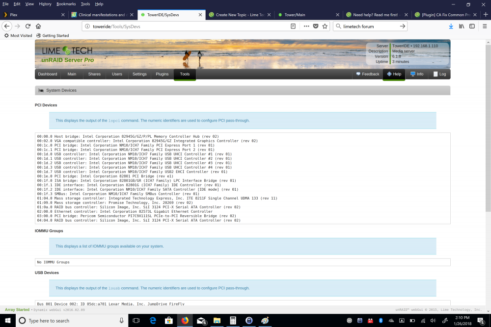

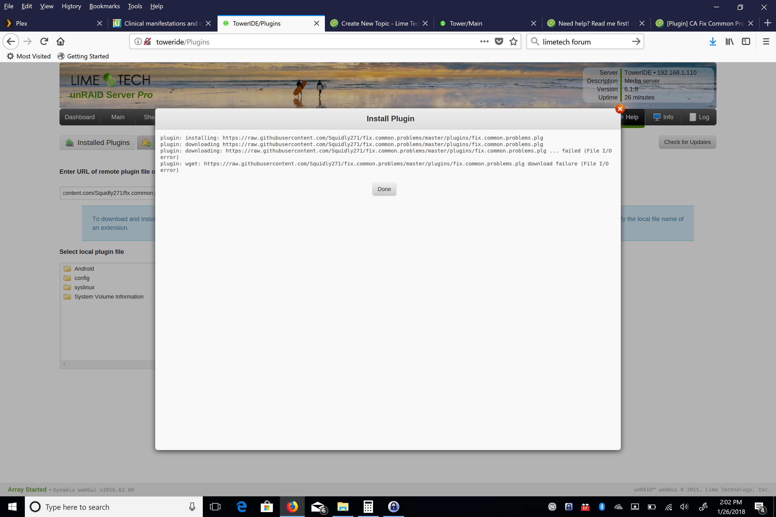

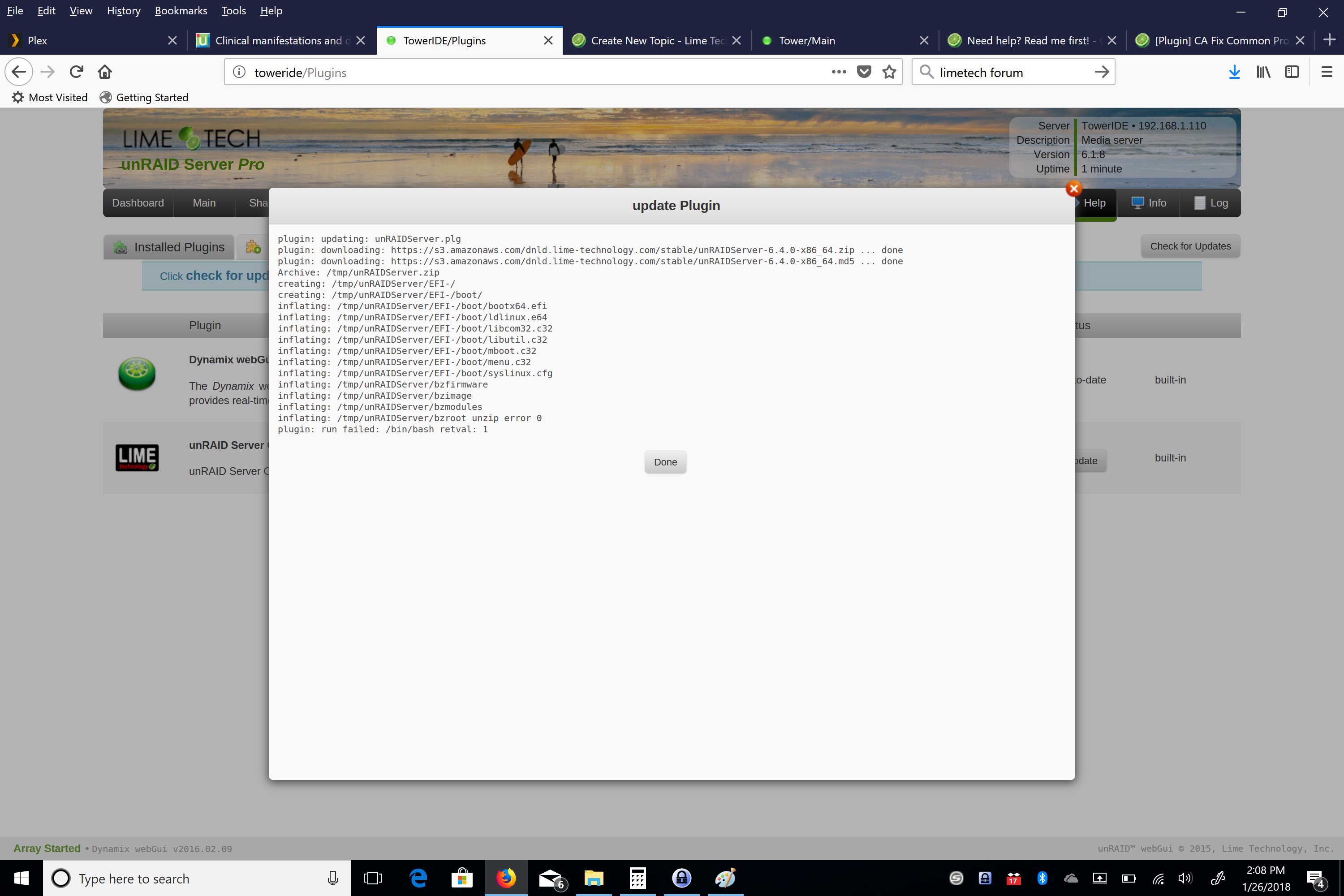

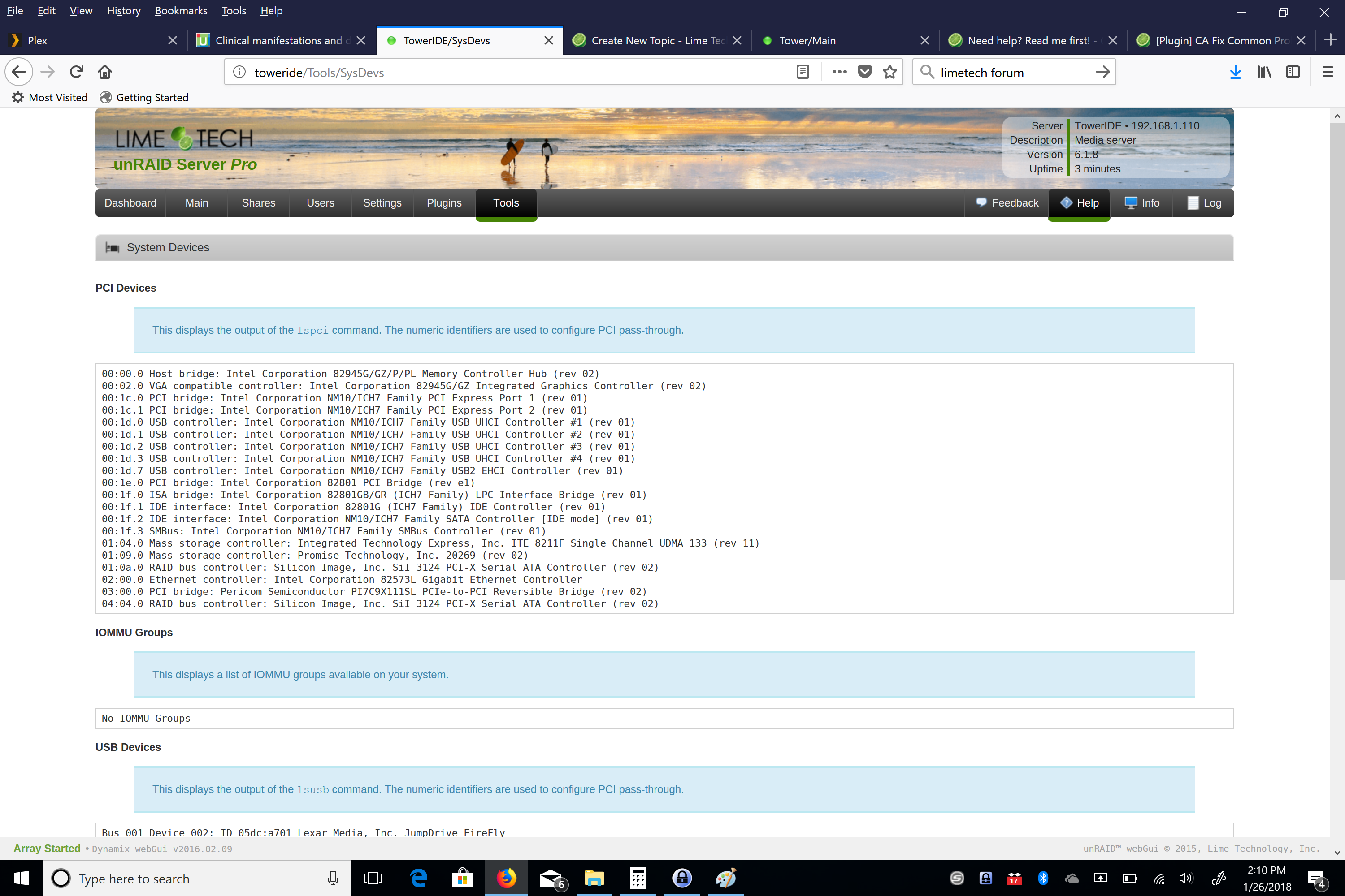

Apologize in advance that I have only rudimentary understanding of unRAID, but have been satisfied user for many years.  Currently running unRAID 6.1.8.  Have no plugins other than those built-in (Dynamix webGUI and unRAID).  Everything has been working normally for more than a year (and still is, except for upgrade failure).  Attempting to upgrade to 6.4.0.  Plugin page shows this update as available, but when I try it fails (see attached screenshot).  Tried to run diagnostics, but all I get is "404 File not found."  Attempted manual upgrade by copying 6.4.0 bzimage and bzroot to flash drive, but could not get system to come online.  Tried installing Fix Common Problems plugin, but get another error (see attached screenshot).  System devices screenshot and portion of system log created after reboot and repeat attempt at upgrade attached as well.  Any suggestions on how to successfully upgrade would be greatly appreciated.

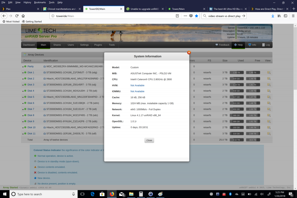

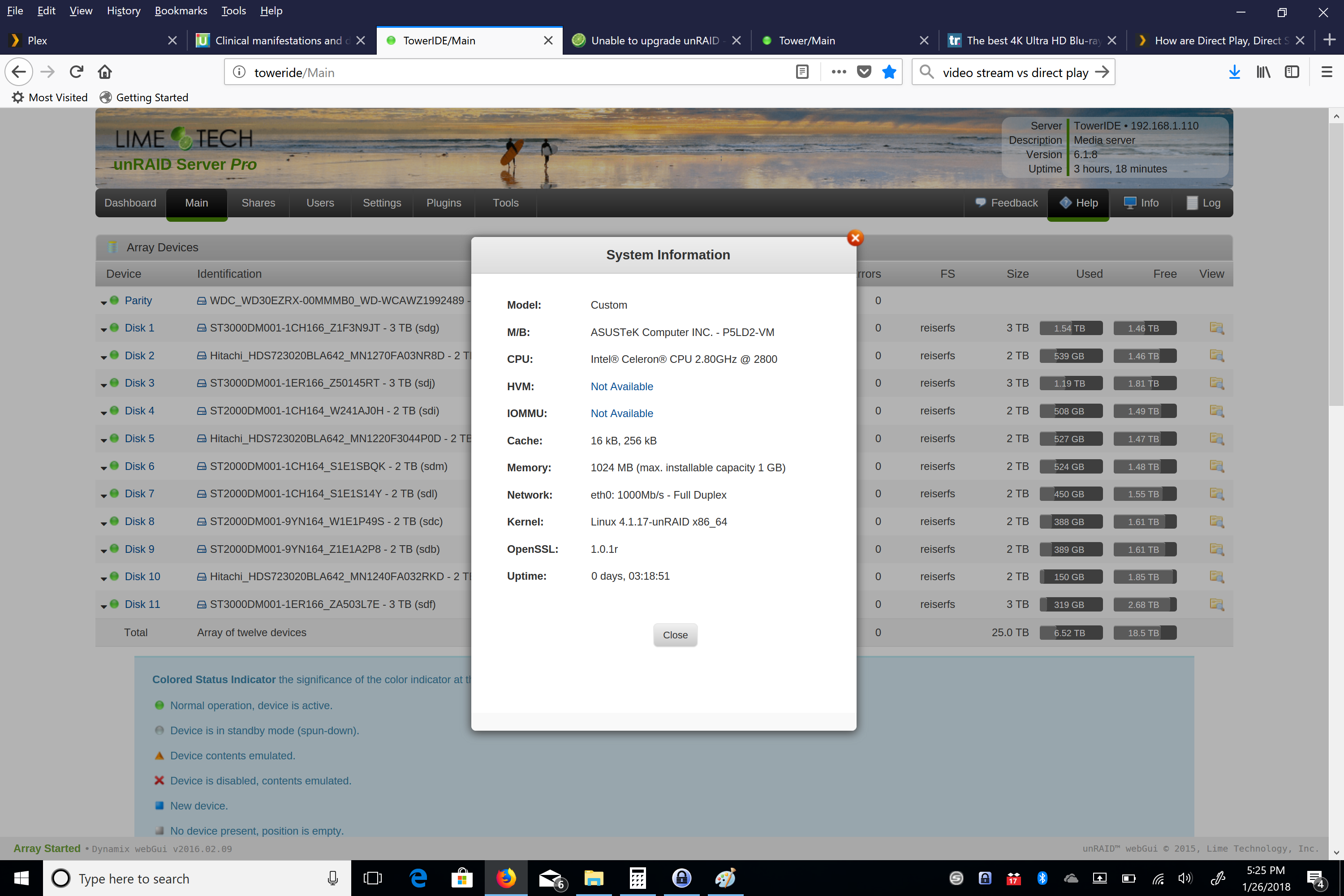

Can you click the Info button in the menus on the main page and post the results?  It should show the system specs.
Despite the statement in the popup above, the specs for that board say it can take up to 4GB.  For next steps, I’d check the current BIOS version and see if there is an update available (it might be necessary to support more memory).  At the same time I’d check and see how the memory banks are populated (all full, any empty?).  You should be able to see that in the BIOS, but if not you might have to crack the case open.
