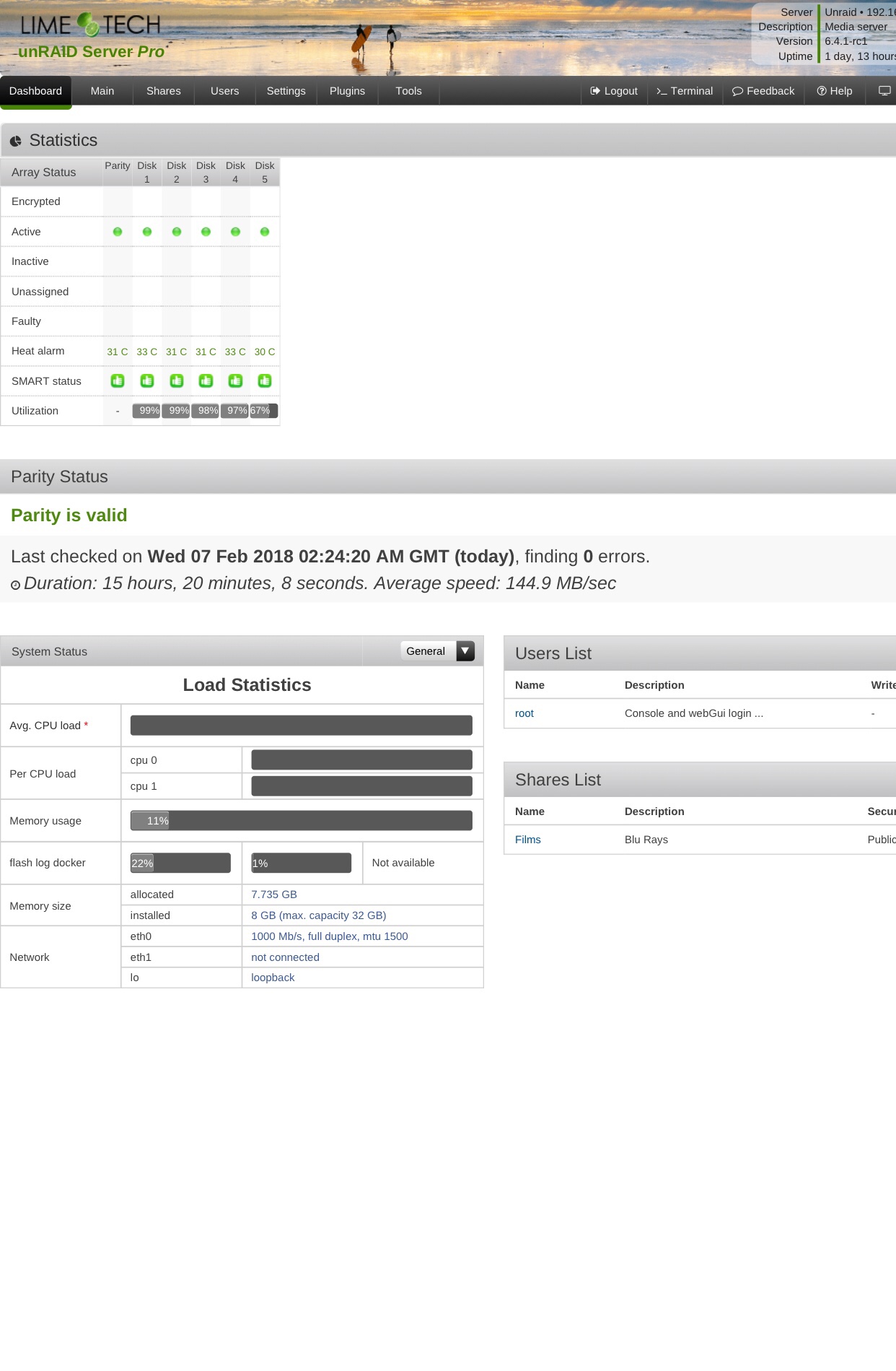

I finished the rebuild and went to dashboard and saw that it seems that a parity check occurred whilst doing the rebuild and no errors were found. Does this actually mean a parity heck occurred?
No, any rebuild or disk clearing is reported as a parity check, it's an old bug.
Thanks all. The drive rebuild and parity check completed without errors.
