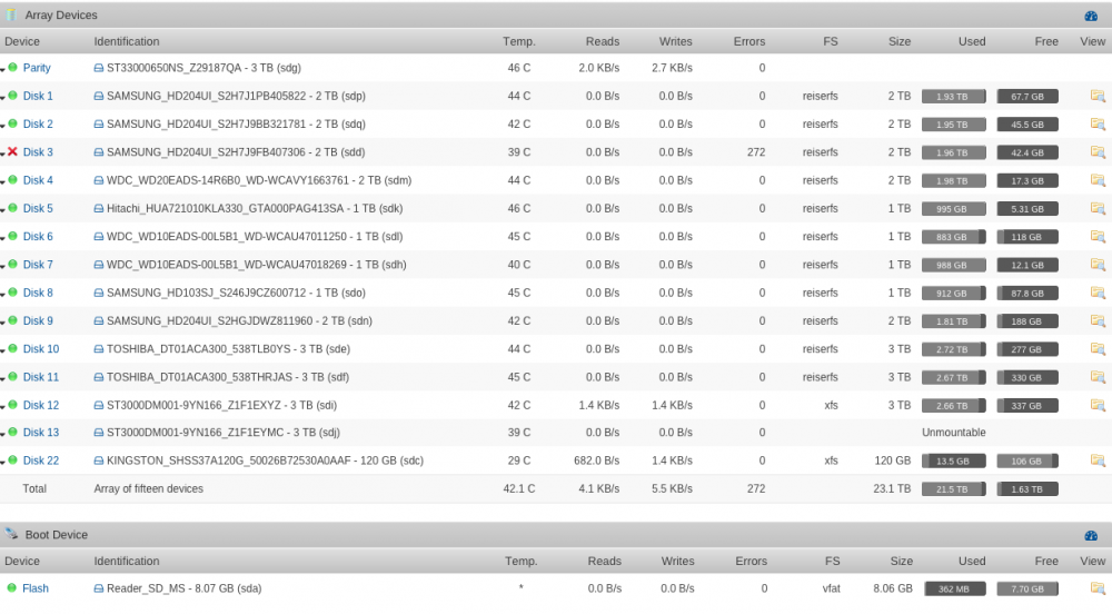

Since a few weeks one disk after another is having problems.
Now three disks have problems..
I am clueless about what is causing this.
I pulled all disks and changed some of the cabling but still the same disks come up with these problems.
Does anybody know what to do next?

I think all disks are fine, should i do a new config?
You have 2 invalid disks with single parity, so both can't be emulated, disk13 has filesystem issues that should be fixed by running xfs_repair.
As for the two invalid disks, any idea if any of them was written to after it was disabled? (disk12 will have some damage since it was rebuilding until you stopped it).
As for the reason for the issues, you rebooted meanwhile and the syslog doesn't cover what caused this, but disk2 has pending sectors, disk13 shows some recent reported uncorrected errors, you're also using a SAS2LP, they have known issues with unRAID v6 and all disks with issues are connected there.
Your best bet is probably doing a new config, then run an extended SMART test on both disk2 and disk13 and try to fix the filesystem on disk12 (and 13 after the extended test).
Any more errors grab the diags before rebooting.
Thanks for the reply guys. Ok wait maybe i am not totally clueless. The ST3000DM001 are bad drives and they keep crashing (mainly during heavy load) and i keep rebuilding them. I thought i was not going to get myself into trouble but here i am...  I will do a new config and report the outcome. Thanks!

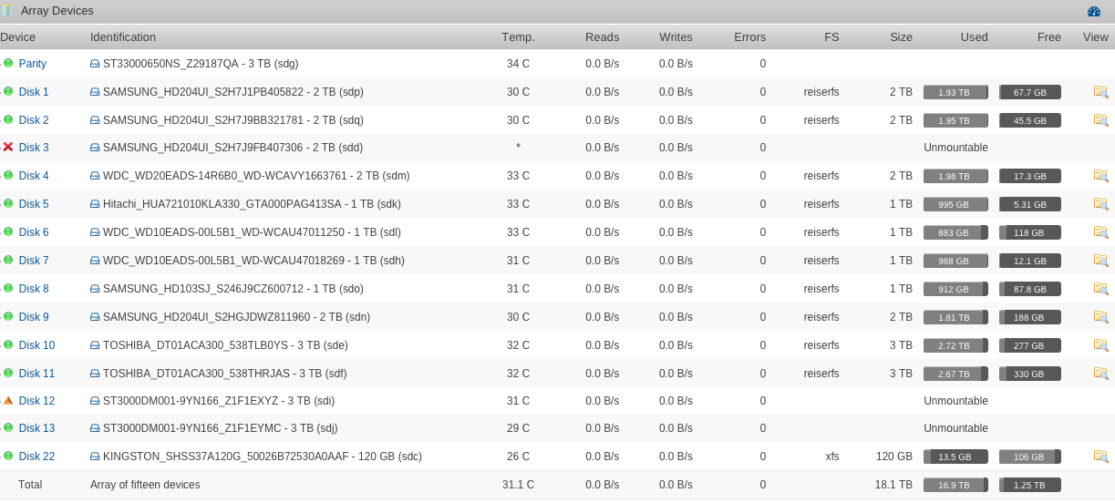

Ok, now we have this.
Disk12 is ok and all data seems to be there....

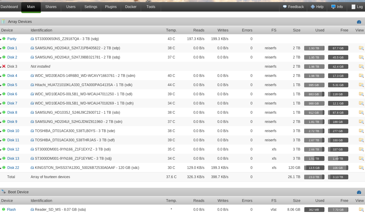

Ok were getting there...
Repair was successful it seems.
Had to do a -L...

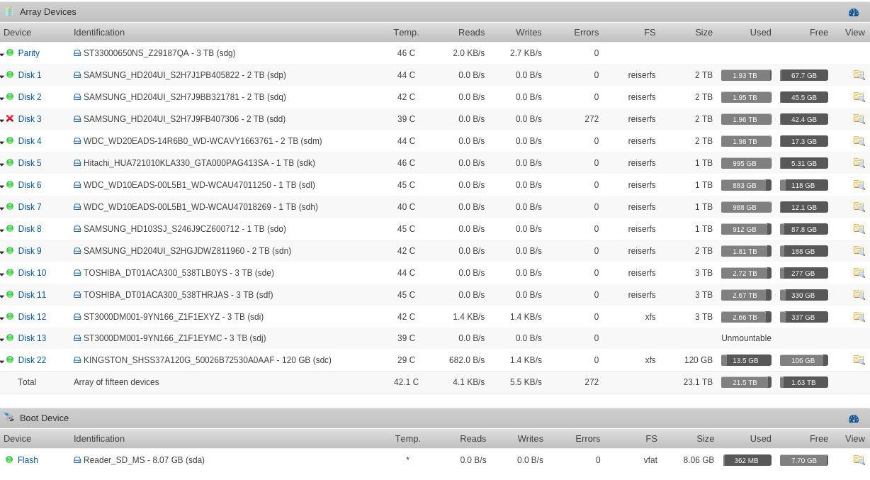

Disk2 is disable again, with errors, so this appears to confirm the pending sectors and that it should be replaced.
Yep, tried some other stuff but i can't get it online.
I can't even do a smart test from the web interface.
I will replace it asap.
