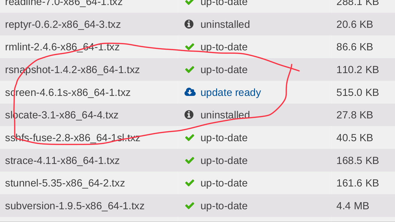

Mine is showing that version but also shows that it is old and has an update ready. Tried updating but still shows “update ready”.
If you've already clicked on the 'Update Ready' bit, ensure that the toggle on the right is 'On' and then hit 'Apply' at the bottom of the page and it should "reinstall" all the packages and that would ensure the update gets applied.
Must have something to do with using a mobile browser. I’m guessing its because I can't click the done button at the bottom of the popup window (not visible). I have to just wait until i think the update has probably finished and then close the window. Remoted into a desktop on my home network and used that browser and everything worked.
Regardless, it looks like updating fixed the screen issue (at least with the built in terminal).
