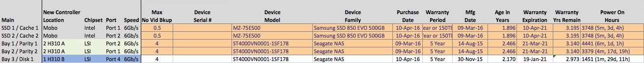

True. In general, I also think its a good idea to have each controller, cable and drive identified and logged somewhere. I keep a spreadsheet for mine. Here's an example:
