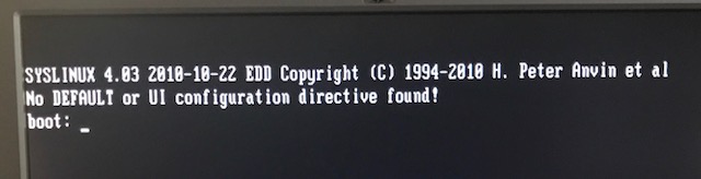

Hi there, I just upgraded to the latest version of the unRAID but on reboot, I found there was an error at the BIOS level that says no boot device.
I have gone into the BIOS and set the default boot to be USB. It still has the same message: no boot device (see screenshot). I suspect the USB may be faulty.
I unplugged the USB and place it in a Windows PC, and managed to copy the data off it, it kept disappearing and then coming back. I was prompted that it had errors and advised to scan. I scanned it and it says it has errors. I suspect it's a faulty USB.
1) Shall I reformat the USB, and copy the files back to it?
2) Buy a new USB stick & request for a replacement key?
Any advice will be helpful. Regards. cL

Indeed. I thought it was the boot sector corruption, so using the old USB I made it bootable again. It fired up but failed at the login screen. At least I was able to bootup. Again it kept disappearing and coming back when plugged in the Windows PC. Tried reformating the old USB - it says cannot reformat it, so confirm it is DEAD.

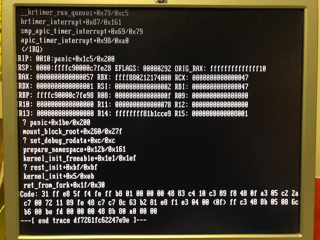

Using the new USB, copy the existing files across and on boot, it had the problem with booting up. Next I tried to run Make_bootable (as administrator), but it just disappeared without the DOS window. I then copied the downloaded latest version of the unRAID and copied Make_bootable into the USB stick, and also SYSLINUX directory. This time it was able to boot up but stuck at this screen.
I tried earlier running a clean install of unRAID and was presented with #Tower login. When I looked at webgui, all disks were unassigned (of course!), I decided to wait for your expertise with the above. New USB + original files + new syslinux. What shall I do next?

Yeah, you are right. Please read my latest post. It looks like when I was upgrading to the new version 6.40 (before the start of my problem), the USB died, and some files became corrupted. So it appears I may need to use latest unRAID download and rebuild my current disks array with a new install. Can you point me the way?
Edited by cliewmc
OMG, I copied the root files from a previous install & it works - so it must be one of the primary files, either bzroot or bzimage file must be corrupt. I am now able to boot into the login screen!
Went on to Replace Key, and Installed the new key. I am back in business. Thank you for advice given. Closed. cL
