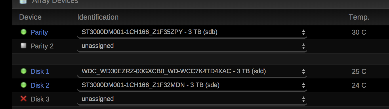

It freezes almost instantly, so have copied up the diagnostic without attempting the parity check (dumb thing to do?).  Also copied up a screenshot of my drives.

unRAID v6 allows 2 parity disks. You only have one assigned. When the array is started and you don't have parity2 assigned, it isn't listed, but when the array is stopped it is shown with a dropdown to allow you to assign a disk to that slot.
There is no need to be in maintenance mode. The basic problem is it is missing disk3. Why is disk3 missing?
