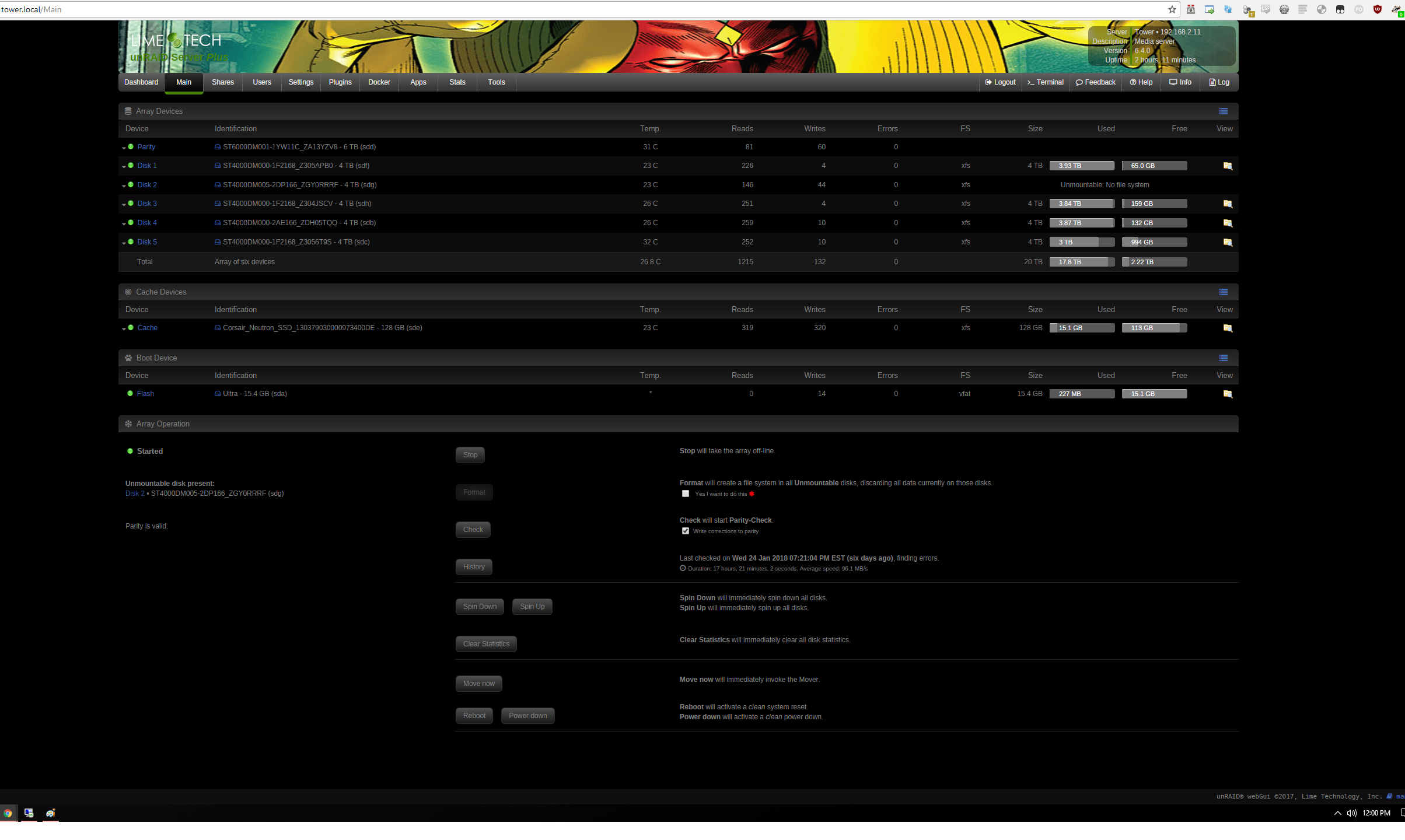

When I tried opening my /Media share just browsing the network in explorer I only saw my 'Movies' and 'TV Shows' folders when normally there are more, like 'Music' 'Audiobooks' 'Sports' etc. (Since my initial build, I didn't add those ones until later; it used to be just Movies/TV Shows. So that makes me think it wasn't mounting files from all the disks? Since I've had it set on highwater allocation some of the disks only have files in /Movies and /TV Shows while newer disks have the other folders.
Anyway, it's my disk 2 which seems to be the problem, it showed there was space in use on the disk, but when I tried viewing files on it, it just seemed to say there weren't any directories. I stopped and restarted the array, and now it says it's unmountable. Since restarting the array I now see my other folders again properly, but nothing seems to actually run properly due to the missing disk. Docker apps would appear to start but won't actually run or connect if I try accessing the WebUI. Right now I see the shares 'appdata' and 'Media' (although I seem to recall at some point there was a 3rd called 'Applications', could just be mis-remembering). These 2 shares seem to show the correct folders in them, but nothing includes disk 2 as a location.

2 hours ago, ShamanIG said:
No modify flag set
You need to remove -n for xfs_repair to attempt to fix the filesystem.
Thanks, is that all I  need to do? Then my disk2 should mount correctly?
You will probably need to use the -L option to the xfs_repair.
Thank you! That seems to be all I needed. After starting it up again my array appears to be functioning normally now.
