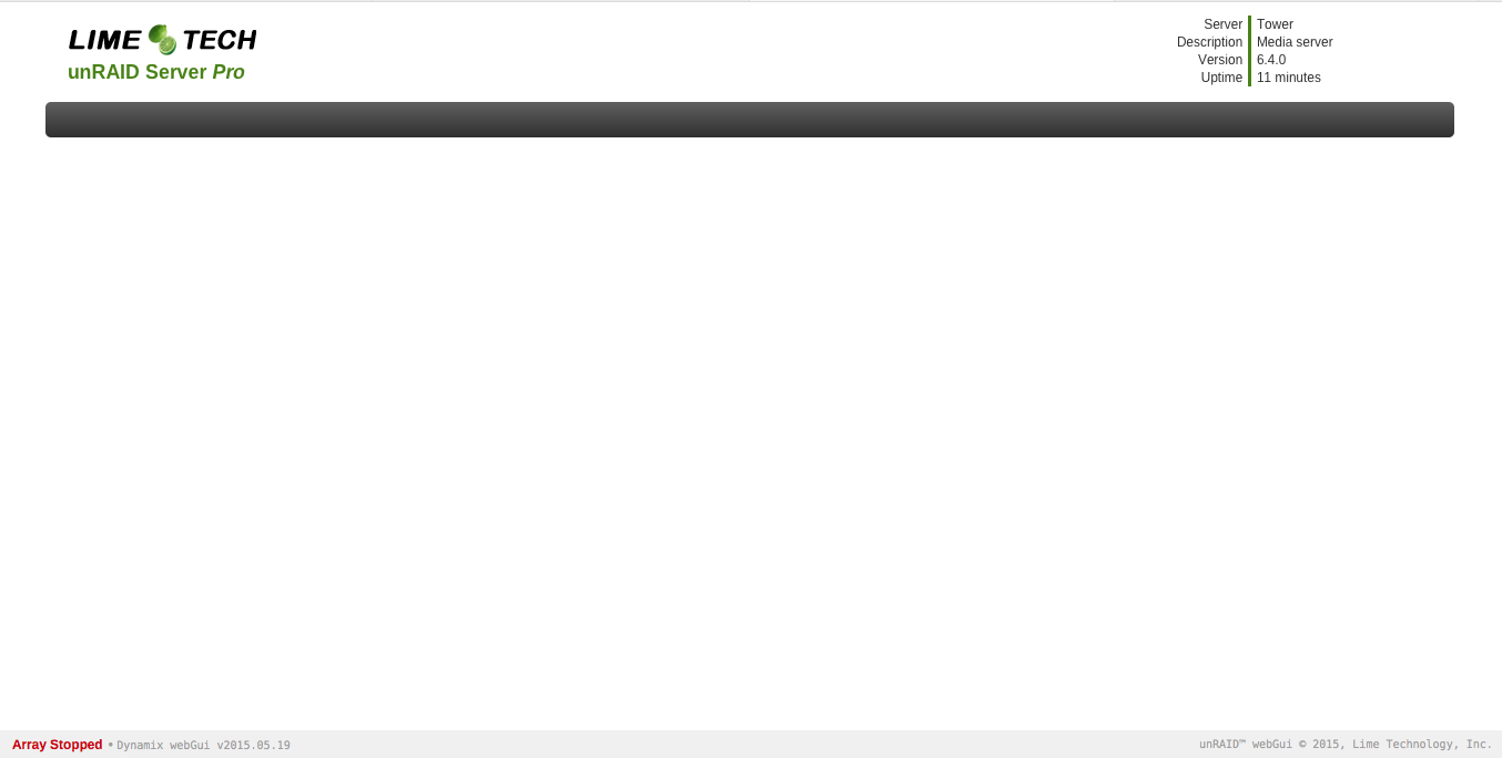

okay, did the reboot. The dashboard says I have version 6.43.0, array is stopped, but that's it. Nothing appears in the window (see attached). I also went to the console and there it says:
sh:  /usr/local/emhttp/plugins/dynamix.docker.manager/scripts/dockconfig.php: No Such file or directory
sh: /usr/local/emhttp/plugins/dynamix.vm.manager/scripts/libvirtconfig.oho: No such file or directory
I found a thread with some of this info but it doesn't seem like it would help me.
The boot dir has several fsck000?.rec files and I see all the appropriates folders and files along with "previous".
Can you point me in the right direction? Should I just replace the super.dat with the original?
That would point to issues with your flash drive, format it and restore the last backup, the one done with the update done but the array stooped, don't forget to execute the make_bootable.bat (in admin mode)

After the fact, but your problem was that you had a very old dynamix.plg file in your config/plugins folder on your flash drive that wasn't checking for OS version compatibility.  Make sure that you've deleted dynamix.plg from /config/plugins on the flash

It doesn't hurt, as dynamix.plg isn't currently used at all.  Issue though is from upgrading very early 6.0 to 6.4 as back then dynamix would upgrade separately from the OS and some versions of the .plg didn't check the OS version to see if they should install or not.  2 Different threads I've seen about this.  You can tell if you look closely at that screen shot, as the dynamix version is listed in the bottom left with a date of 2015 even though the top right shows 6.4.0/6.4.1
EDIT: Issue would also happen from any 6.1.x / 6.2.x / 6.3.x as the bad .plg would still install but remain compatible.  IE: just delete the file and you're good to go.
