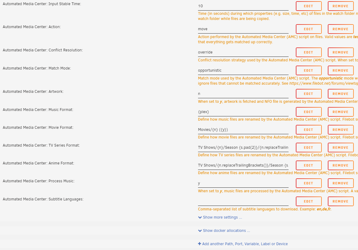

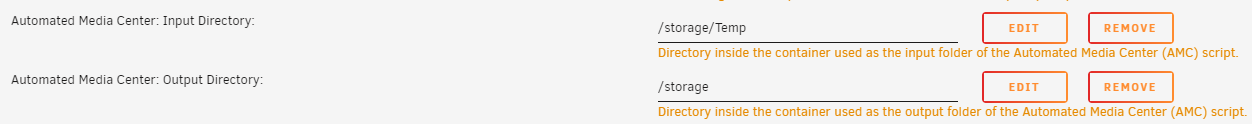

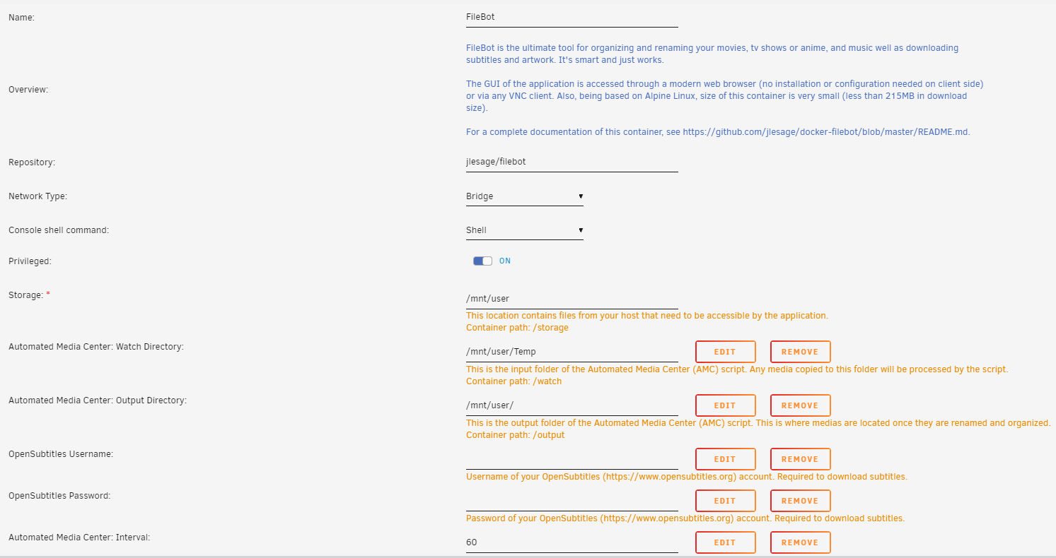

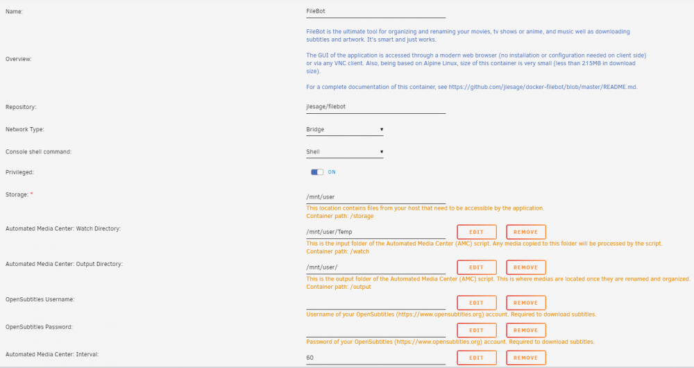

I'm hoping somebody can help. I have Filebot setup and working perfectly. I download files from my seedbox to a temp folder (mnt/user/temp) and then have AMC rename and move the files to where they belong (mnt/user/Movies or TV Shows) because I don't need the files in the temp directory after they're renamed/moved. However I've noticed using the move command requires reading and writing the entirety of the file, which seems odd to me since it's staying on the cache drive (until unraid's mover runs and moves the files to the array). Usually it's not that big of a deal but a lot of times I'm downloading 60GB files and that's a lot of unneeded wear and tear on the disk, not to mention time consuming. I've gone into Midnight Commander and manually moved a file from mnt/user/temp to mnt/user/Movies and it was instant so there must be something wrong in the Filebot docker permissions or setup that's causing it read/write the entirety of the file when it performs a move.
I've attached pictures of my Filebot Docker setup

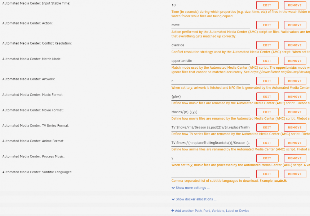

read some pages backwards, i was in the same trap but got it solved and posted a config picture with working move instead copy/del as move.
Thank you!!!
I updated my AMC input and output directories using storage as shown in the picture and move now works!
58 minutes ago, Yousty said:
Thank you!!!

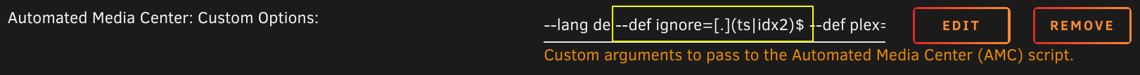

@cbr600ds2
if u can identify them ...
here a sample, i ignore 2 filetypes as sample, .ts and .idx2 files are here ignored
and may a tip for filebot related things, there is a filebot forum with alot howto's and a discord where the author is very helpful and active, just as note ... for filebot specific questions how todo this or that ...
if u want to move them "untouched" this would also be possible etc etc ... filebot can also trigger a script to run with any command and so on ...
