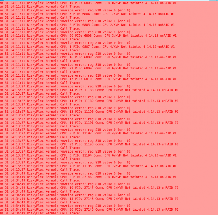

Sooo, I upgraded to 6.40 Stable with no issues, apart from 1.
My 2012R2 Seabios VM refuses to start when using hyperthreaded CPU selections. CPU Cores Pinned at 100%
The errors I recieve in the log - attached.
The only way it can boot is if I deselect the HT part of the CPU.
The CPU is a Xeon E5 2670 v3 sitting on an Asrock Extreme 4 X99.
I've not enabled anything different from 6.35 where evrything was working perfectly. I've had no lockups or anything along those lines.
I did read that somebody did have this issue during 6.4RC and was asked to update to the latest RC.
Is this something I can fix by updating to 6.4.1RC?
