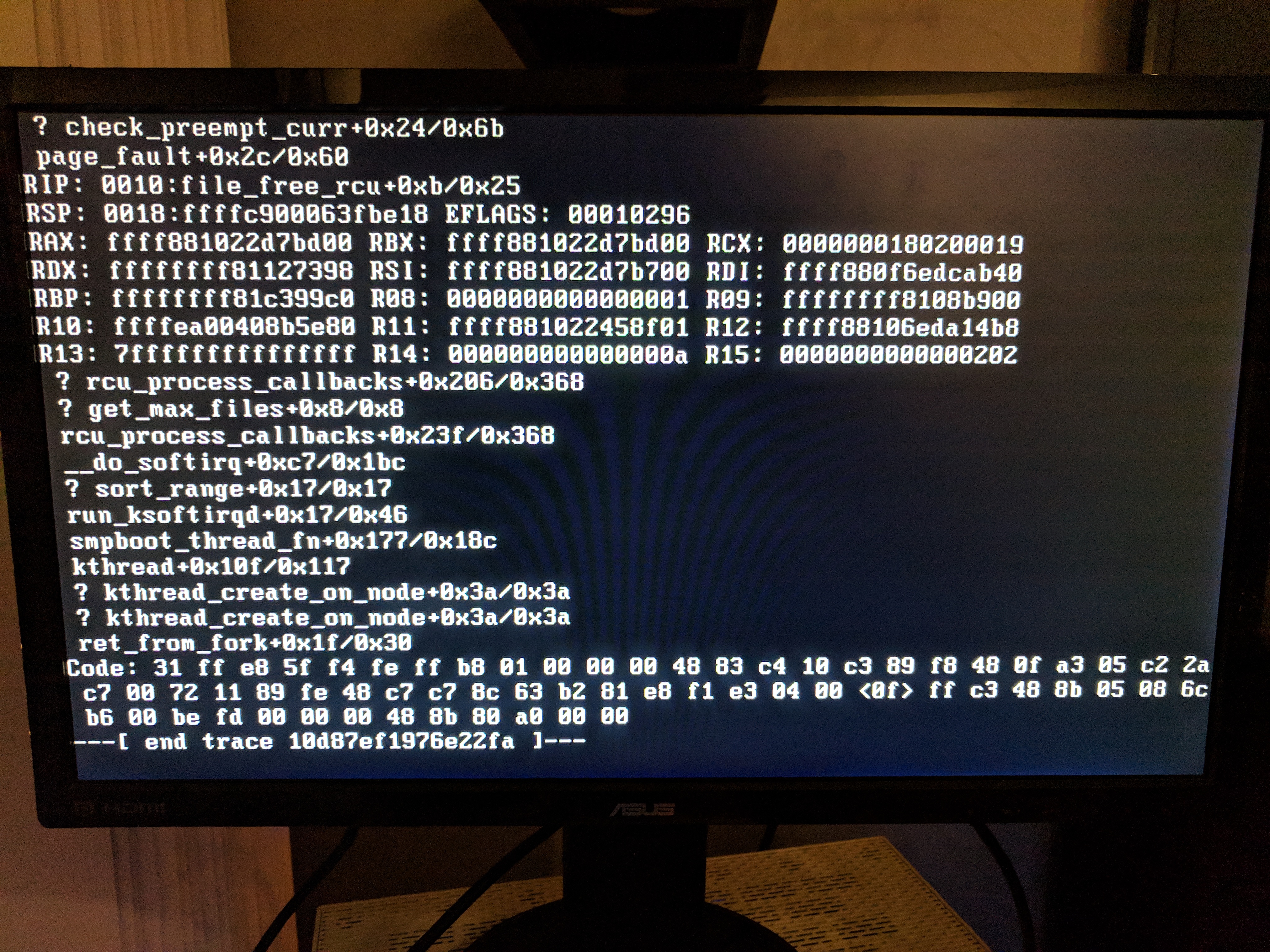

My unRaid server have been running great after I've upgrade from 6.3.5 (?) to 6.4.0 but yesterday I upgrade the BIOS on my MSI - Z270 XPOWER GAMING TITANIUM (MS-7A58) motherboard
From: Version: 7A58v13 Release Date: 2017-07-24
To: Version: 7A58v14 Release Date: 2017-11-27
Source: https://www.msi.com/Motherboard/support/Z270-XPOWER-GAMING-TITANIUM#down-bios
and at the same time I installed a heatsink on my M.2 disk (EK-M.2 NVMe Heatsink - Black) since unRaid keeped warning about its temprature.
After this my unRaid server freezes after a short while when I start my array and it starts the Parity-Checks.
The picture (Screen1.jpg) shows what I saw yesterday before I went to bed and it was still there now when I got home from work.

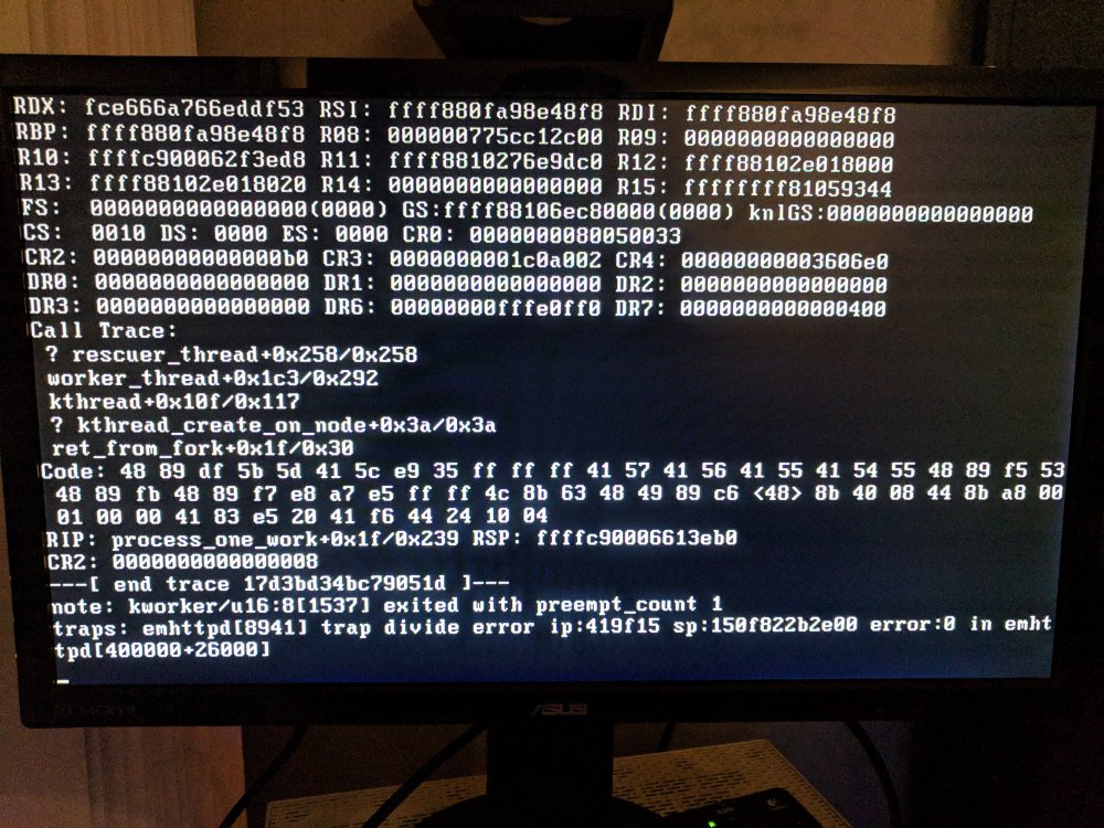

Now I've rebooted the server and pulled the syslog & diagnostics files and tried again. Now I saw that it stopped at 1.2% (Parity-Checks) and the screen showed as in Screen2.jpg
Any idé?
Thank you!

I noticed that (sometimes) after a reboot my M.2 is missing sometimes and it comes back after another reboot.
Edit 2
After I reseted the bios for the 2nd time and only enabled Intel-VT(?) and a couple reboot I got it to work again.
But after all this I had to re-do my cache pool and all of my container and VMs were gone.
I'll let it run over night and If I don't update this post, you can consider it "solved".
