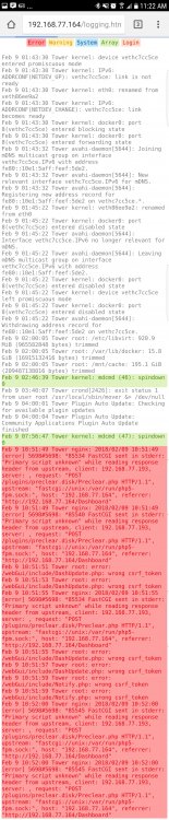

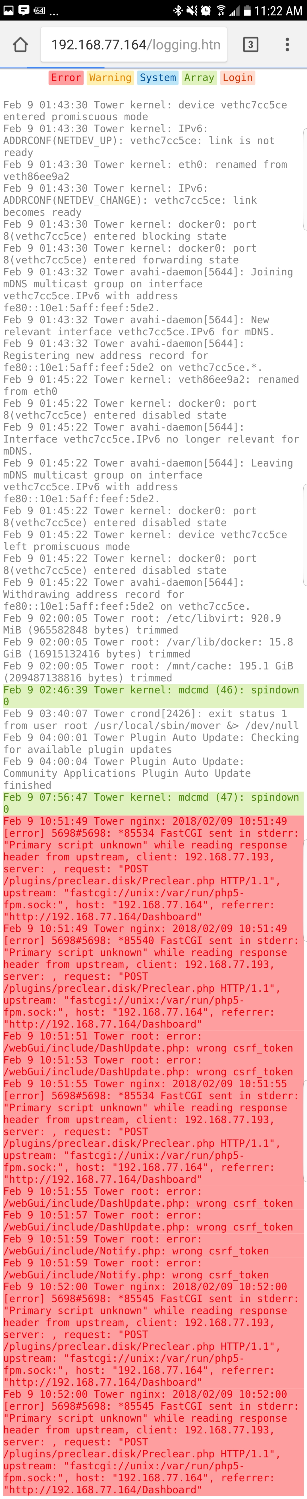

I'm getting issues with this as well. The logs show errors that seem to relate to the preclear plugin. I attached he'd a screensjot of logs which may not be ideal but I'm on mobile and it's my only option at the moment.
Which unRaid version?  Preclear is incompatible with 6.4.1 and must be uninstalled.  Preclear itself though has problems with other unRaid versions for certain users.
