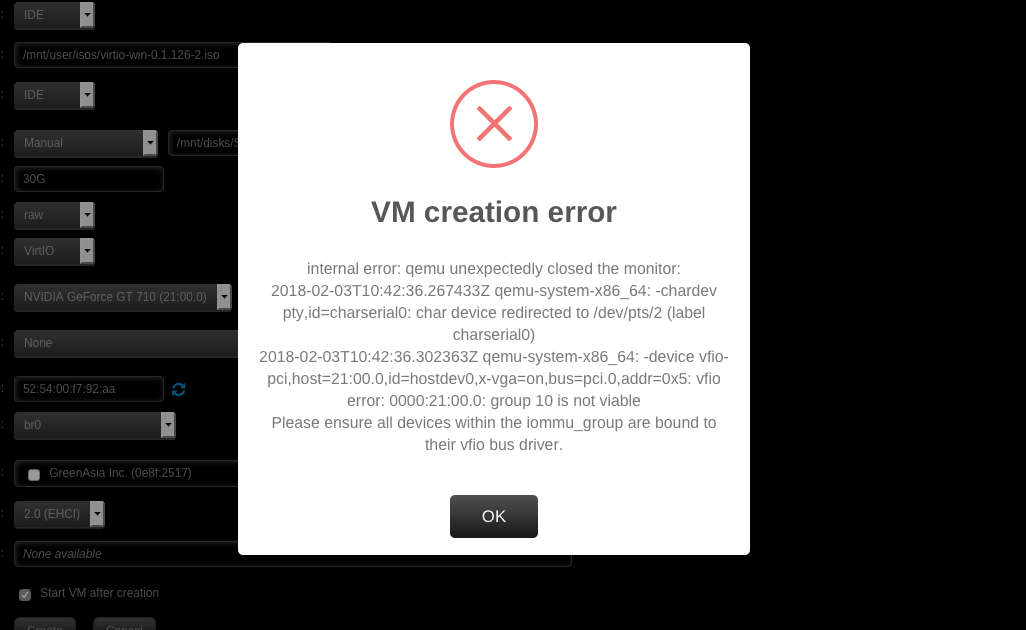

tmoran000 Posted February 3, 2018 Share Posted February 3, 2018 (edited) I am having some issues with creating a VM and using the GPU instead of the VNC graphics. I am getting an error when I try to create the VM when selecting the the GPU. Now to be honest I may be misunderstanding the use of the GPU instead of VNC but let me explain my self incase im wrong When I want to use my VM from my laptop and say there is a video playing I get tremendous glitching. That is with a device on the same network. It does this with all of the VM's I am running. I am under the impression that If I use the GPU for graphics that it will be better. But I have 2 questions. 1 Am I understanding this right and is it possible. I am assuming it is. And 2 once I would have it set up, How would I remote into the VM if VNC is not running and RDP is not set up? Below is my current error on set up when choosing the Nvidia GPU instead of VNC Edited February 4, 2018 by tmoran000 Quote Link to comment

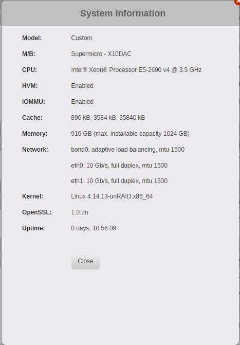

Siwat2545 Posted February 4, 2018 Share Posted February 4, 2018 Can you take your INFO screen shot (An example of my server is attached) I need to make sure that you have HVM and IOMMU Enabled Quote Link to comment
SSD Posted February 4, 2018 Share Posted February 4, 2018 11 minutes ago, Siwat2545 said: Can you take your INFO screen shot (An example of my server is attached) I need to make sure that you have HVM and IOMMU Enabled Wow! That is a heck of a lot of ram! 2 Quote Link to comment

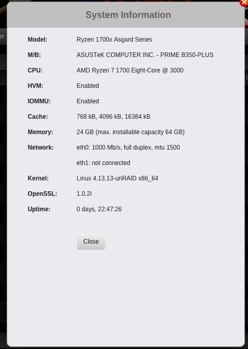

tmoran000 Posted February 4, 2018 Author Share Posted February 4, 2018 here ya go Quote Link to comment

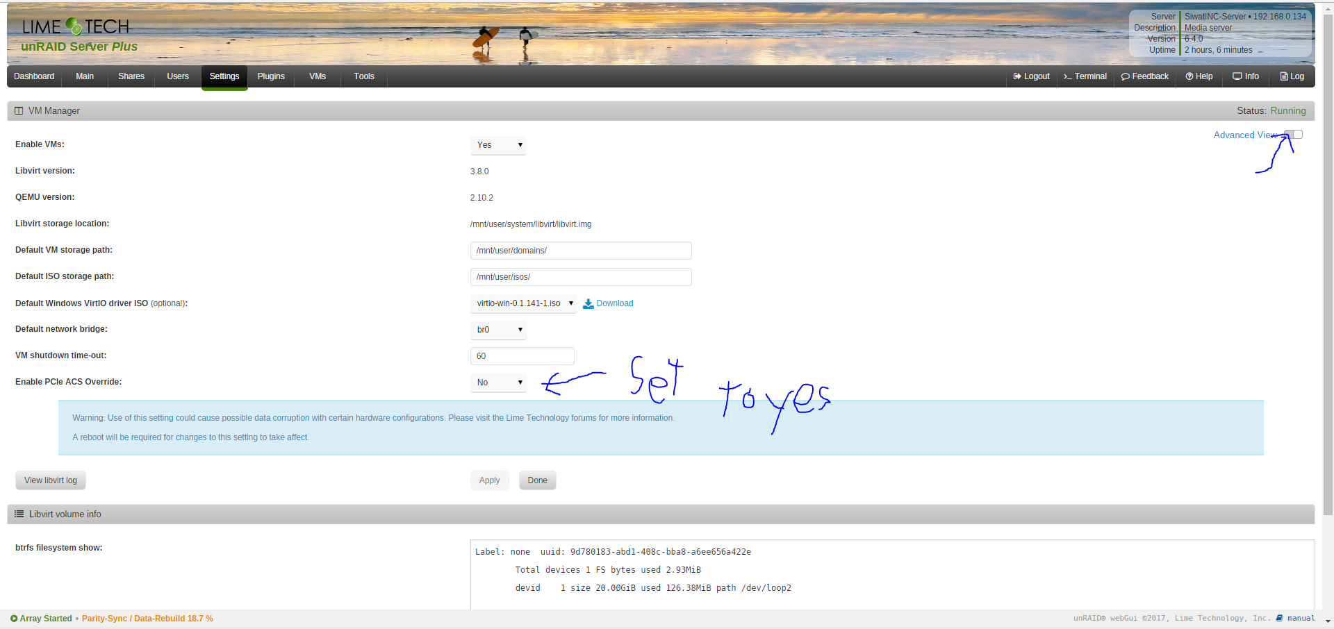

Siwat2545 Posted February 4, 2018 Share Posted February 4, 2018 (edited) I see the issue your device is in the same iommu group, Please enable PCIe ACS Override and reboot your system Edited February 4, 2018 by Siwat2545 1 Quote Link to comment
tmoran000 Posted February 4, 2018 Author Share Posted February 4, 2018 (edited) Checking out how to do that. * Found it, Rebooting Edited February 4, 2018 by tmoran000 Quote Link to comment
Siwat2545 Posted February 4, 2018 Share Posted February 4, 2018 See the picture I just edited in Quote Link to comment
tmoran000 Posted February 4, 2018 Author Share Posted February 4, 2018 I enabled it. And am Rebooting now. Quote Link to comment

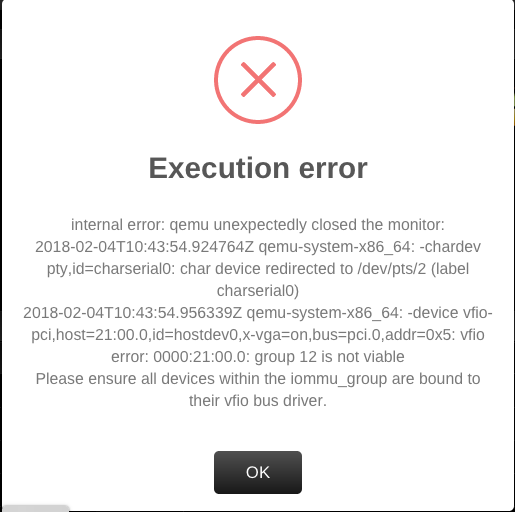

tmoran000 Posted February 4, 2018 Author Share Posted February 4, 2018 I did so and unfortunately I got the there error when I try to start the VM Quote Link to comment
