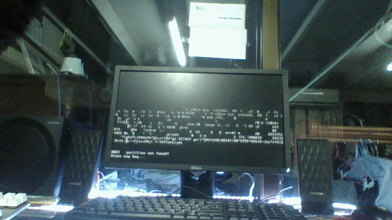

I updated my unraid os  and bad things happen It won't boot
to me it seem like my usb boot drive is corrupt because when I tried coping files from the usb drive it say "this file is corrupted and unreadable"
is there any ways to fix this without losing any of my data ?
[Boot Screen attached]
You haven't lost your data!   Provide us with some details about the drive composition of your HD setup.  Parity type, number of data drives, number of cache drives?  Where you running any VM's?

The File that I can't copy is domain.cfg, syslinux.cfg, the whole /config/share folder, bzroot
Hopefully, you now have backed up as much of your Flash Drive as you can read.  The run chkdsk on that Flash Drive.  Hopefully, it can be repaired.  If it can be, do so.  Delete any file segments that it finds.  (If it can't be repaired, we will have to take another tack. ) Here is an important bit of reference material for as we move forward:
