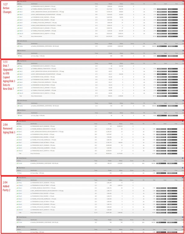

This is the array now. It's building parity for parity disk 2 but shows 5.04 TB free in the array. Am I reading this correctly?

I have a before picture, but it is on my computer. Before I added parity 2, free space showed 1.46 or something TB free. I just made the change this am.

Ok.  My apologies.  It seems I have made so many changes recently that I lost track of how much space there was available in my array.  It looks like I simply confused the amount of free space I had on the new disk 7, with the total space available in the array.  See the history attached.
