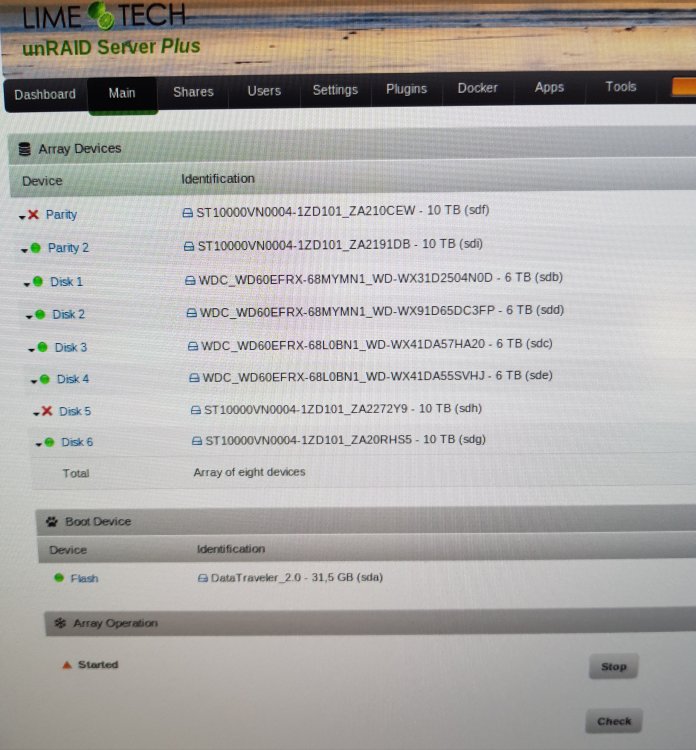

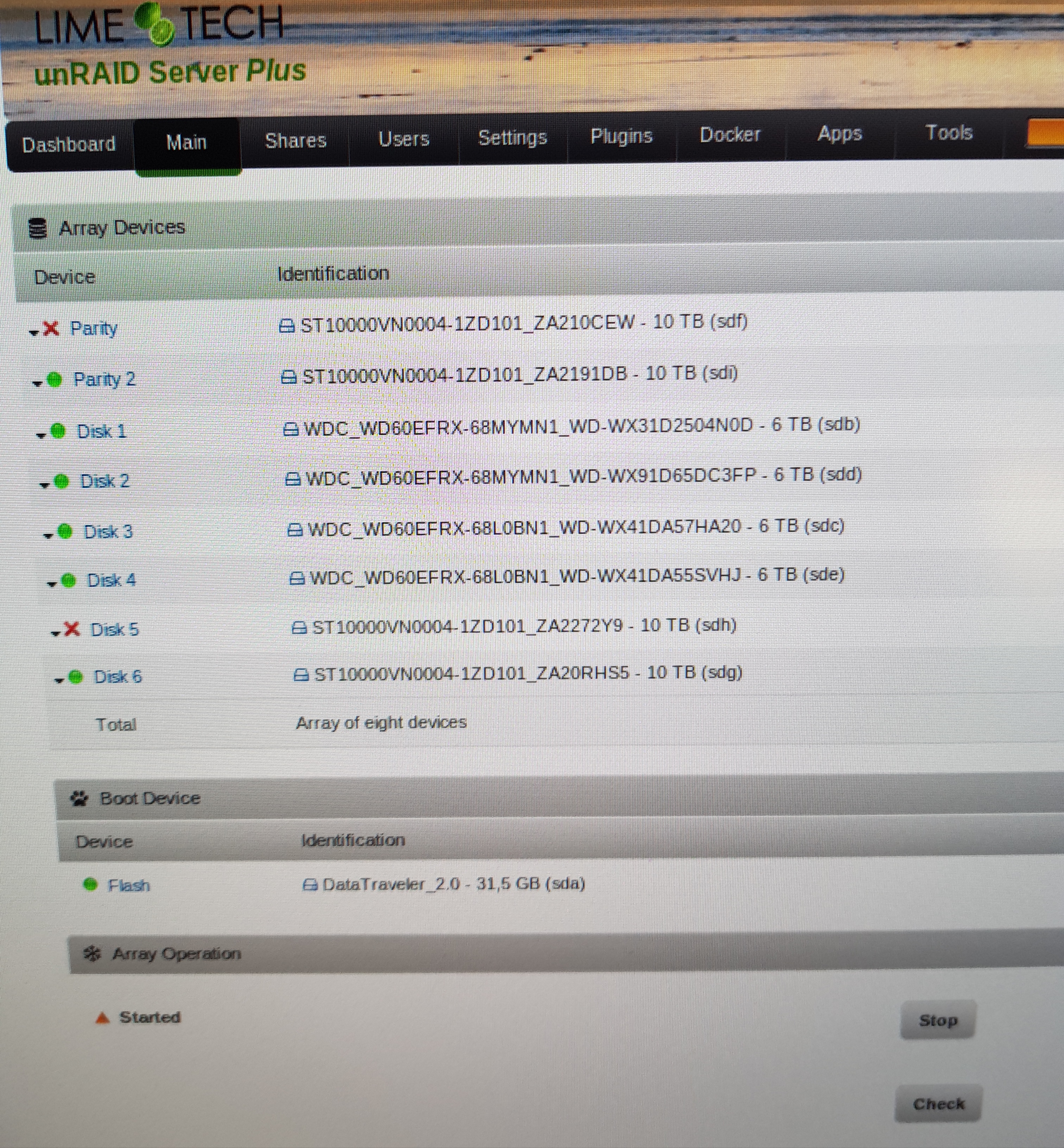

"Screenshot" of my array before the total failure, with a failed data drive and a failed parity. This is where I attempted to rebuild my data drive then my parity off my working single parity:

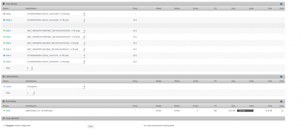

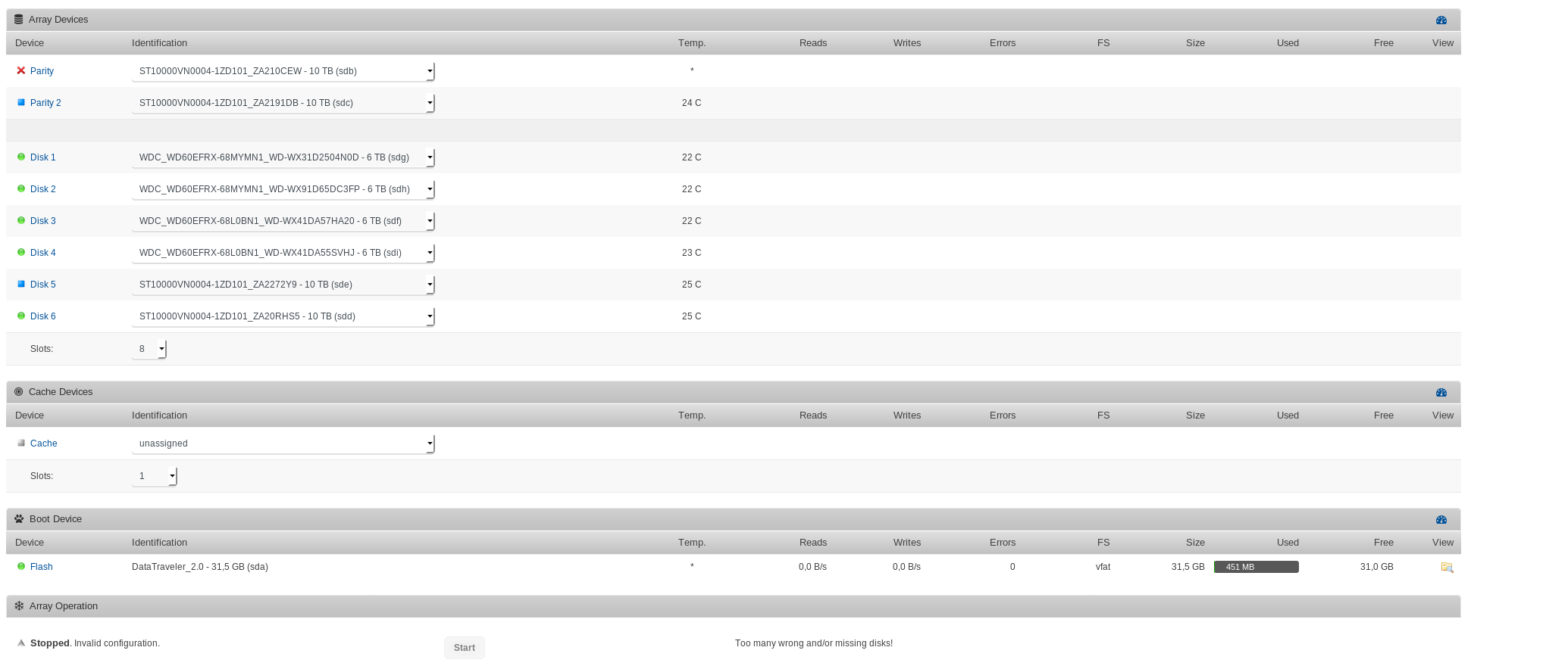

Screenshot of my current array status now I have my new HBA:
5a79cf5778452_Screenshotfrom2018-02-0615-51-13.thumb.png.a754b9c1fa166b035a3f4ad4aefe2494.png
As you can see, my previously valid 10TB parity drive, ending in 1DB is now unassigned. meaning I have no parity data to rebuild my data drive off.
My hope is, can I tell unraid that the data on the parity drive 1DB is, in fact valid and to add it to my array without wiping the parity data, as that is currently the only drive I have that has valid data on it so I need that to rebuild my failed data drive ending in 2Y9.

But your 2nd screenshot seems to indicate parity2 and disk5 are new???

Afraid so! Screenshot1 shows the before broken HBA state of my array, with parity2 operational, but parity1 down. So by my logic I'd need to rebuild disk5 off parity2, but parity2 is showing as unassigned and new to unraid

OK, I get it now after looking at screenshot 1 again. Parity2 has always been parity2. So OK let's go back to this post from johnnie. Sorry for my confusion.
