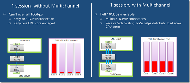

I have the same question. I'm not able to get RSS enabled between my Unraid server and my Windows 10 client which is needed to use Multichannel = Multicore = maximum 10G performance:

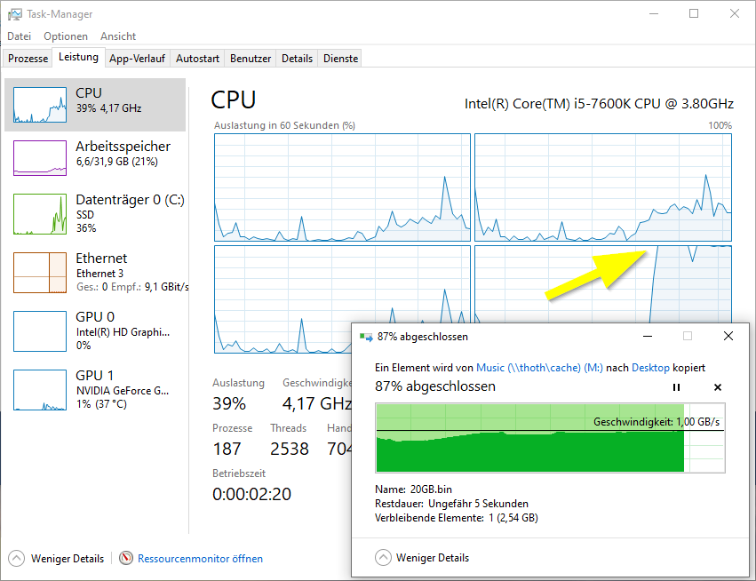

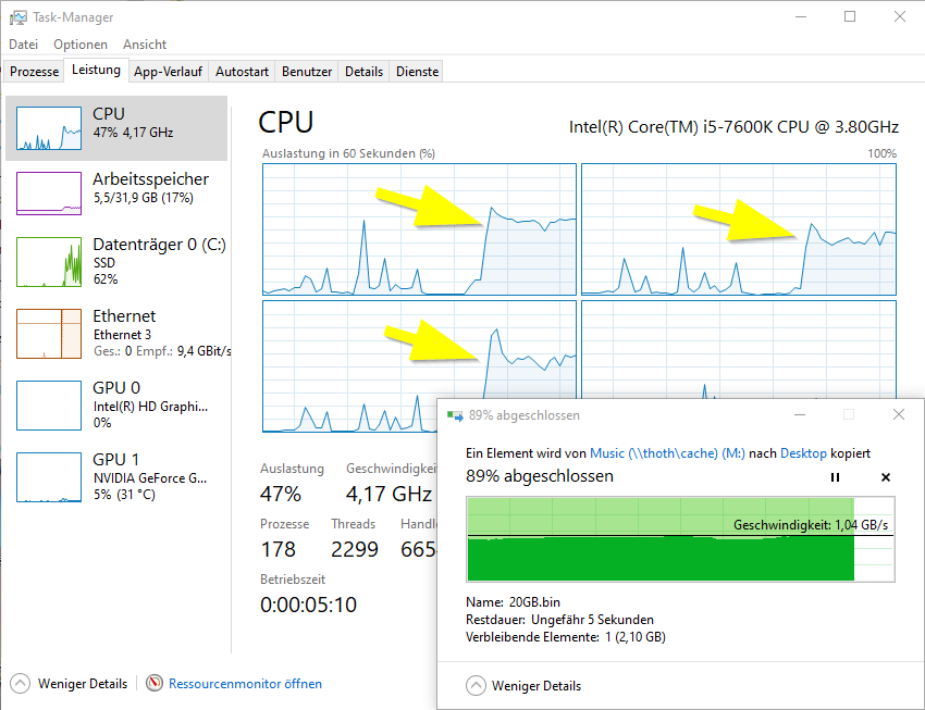

Client Test Results
The client clearly benefits of RSS. The 4th CPU core is not overloaded anymore, the Client runs absolutely smooth, now. Love it.
RSS disabled (Client lags)
RSS enabled (no lags)
Conclusion
RSS is a must. It helps distributing the load evenly across the clients and servers CPU. By that the client and server are able to transfer faster. Once set up, it works automatically with all Windows Clients since Windows 8.
