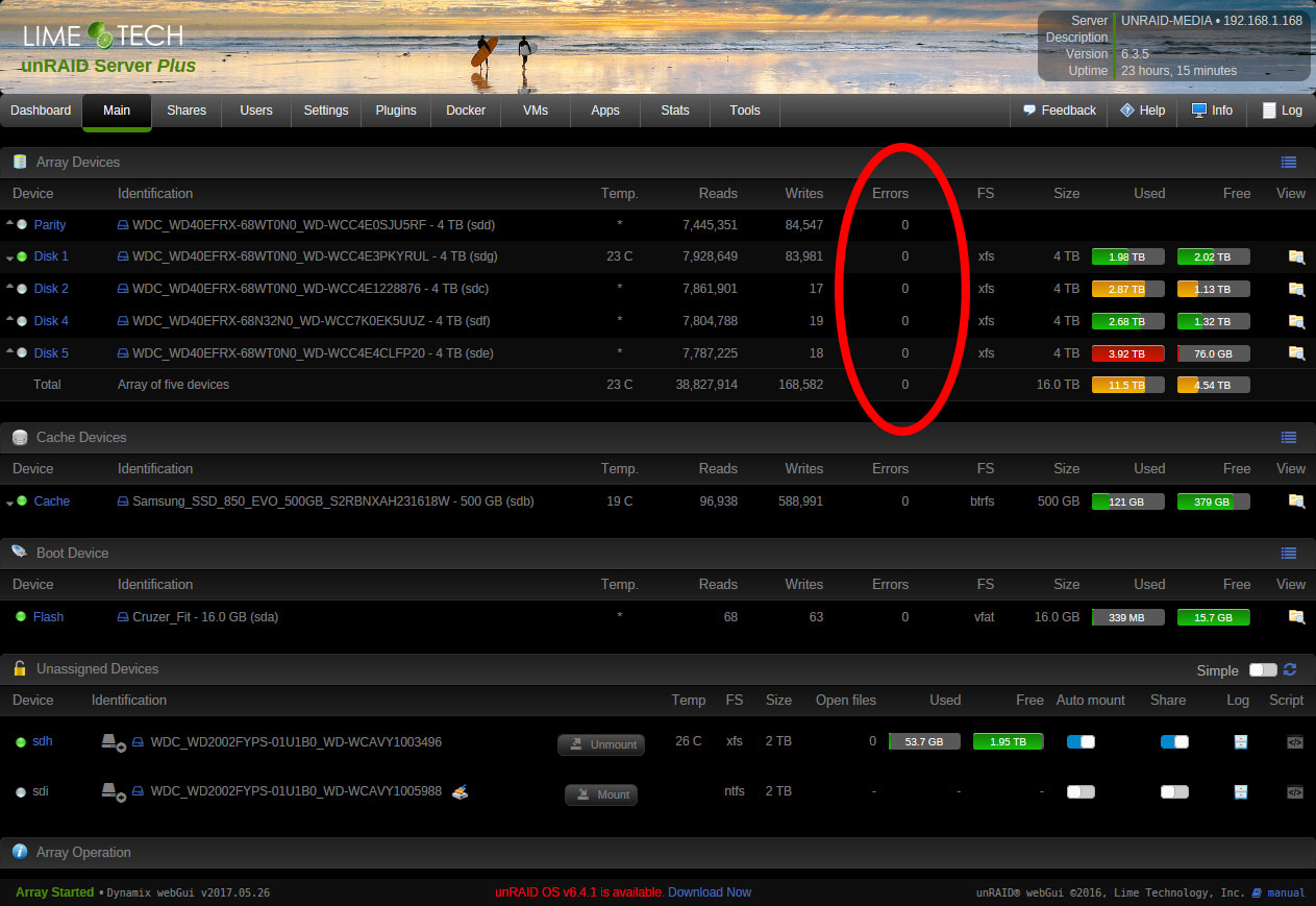

Where are my errors???
After a power failure and a parity check I got this: 732 errors.
Event: unRAID Parity check
Subject: Notice [UNRAID-MEDIA] - Parity check finished (732 errors)
Description: Duration: 10 hours, 47 minutes. Average speed: 103.1 MB/s
Importance: warning
But I'm unable to see where those errors are.
Attached diagnostics file also.
Thankyou
Gus
unraid-media-diagnostics-20180207-1005.zip
Edited by zzgus
The circled are read errors, you got sync errors, which are normal after an unclean shutdown and there's no way of knowing which disk they came from, likely parity, in any case you just need to make sure it was a correcting check.
