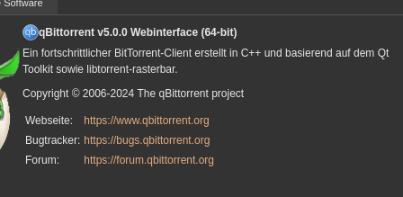

QBittorrentVPN - how can i get on a newer qbt version than 4.6.0?
Just use the right container and update it ?
binhex/arch-qbittorrentvpn thats the container I use and it's up to date
