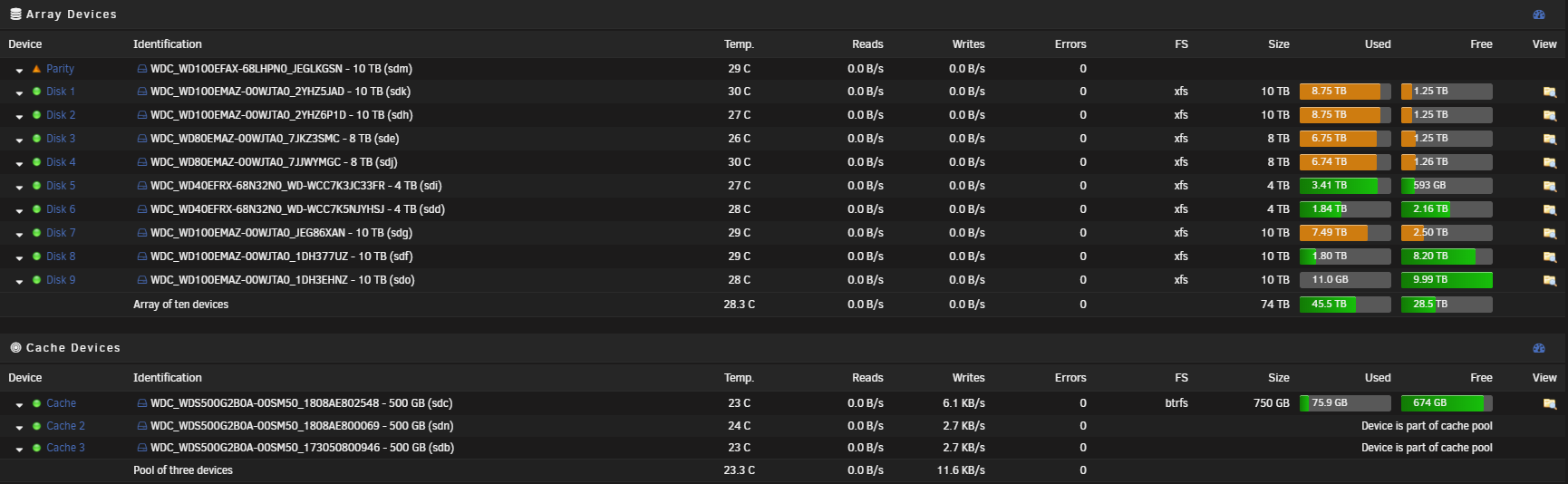

I'm hoping that the highly intelligent folks on this thread will able to assist.
I just installed my first HBA (LSI 9211-8i) flashed to IT mode. X399 Threadripper 2950x with (2) 8x and (2) 16x PCIe slots. HBA is on an 8x slot with GTX 1050 on a 16x slot next to it.
I'm getting 9 days 15 hours ETA on my rebuild of a 8TB disk.
Read speeds on the array seem to be capped around 57MB/s. Writes are at 8.2MB/s.
8TB Seagate IW Parity Drive (MB port)
2x 500GB EVO 950/960 Cache drives (MB port)
4x 8TB WD Red data drives
3x 3TB WD Red data drives
I'm not too familiar with IOMMU groups to know what I'm doing or looking for...
Questions:
- Can I stop the parity sync/rebuild to check my BIOS settings?
- Do I need to look at anything in the IOMMU groups?
tower-diagnostics-20180915-1502.zip

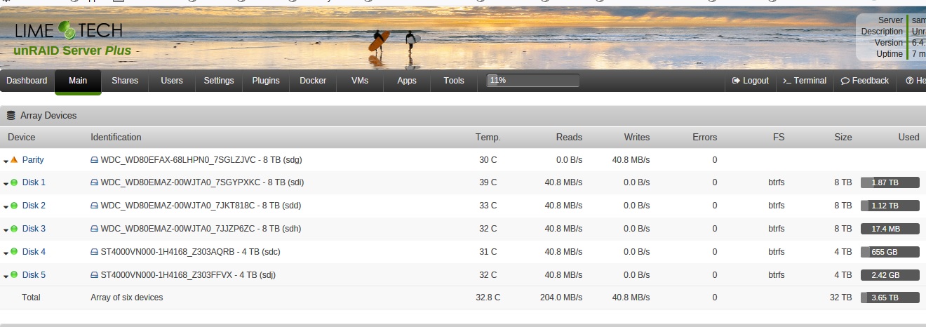

I'm experiencing what I consider slow Parity Disk rebuild, 50MB/s.  I replaced my parity 1 disk with a bigger disk and I plan on replacing party 2 disk with a bigger one in the next month or two so I can start using bigger disks.  I upgraded my computer recently to a Supermicro 24 bay system.
Primary Specs:
CPU: 2x Intel Xeon E5-2690 V2 Deca (10) Core 3Ghz
RAM: 64GB DDR3 (4 x 16GB - DDR3 - PC3-10600R REG ECC)
Hard Drives: Not included, visit our store to purchase 1 Year Warranty drives at low price
Storage Controller: 24 Ports via 3x LSI 9210-8i HBA Controller Installed closer to all 3 PCI-E Slots near power supply so Customer can Install his Dual Graphics card
NIC: Integrated Onboard 4x 1GB Ethernet
Secondary Specs: Chassis/ Motherboard
Supermicro 4U 24x 3.5" Drive Bays 1 Nodes Server
Server Chassis/ Case: CSE-846BA-R920B (upgraded to 920W-SQ PS quiet power supplies)
Motherboard: X9DRi-LN4F+ Rev 1.20
Backplane: BPN-SAS-846A 24-port 4U SAS 6Gbps direct-attached backplane, support up to 24x 3.5-inch SAS2/SATA3 HDD/SSD
PCI-Expansions slots: Full Height 4 x16 PCI-E 3.0, 1 x8 PCI-E 3.0, 1 x4 PCI-E 3.0 (in x8)
* Integrated Quad Intel 1000BASE-T Ports
* Integrated IPMI 2.0 Management
24x 3.5" Supermicro caddy
I don't see a reason for the parity rebuild to be only 50 MB/s.  I'm including my diagnostics file.  I did the:

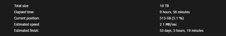

ive been trying to figure out why my parity rebuild is taking so long. i get its 10TB and i have 45.5 TB of data but its going so slow. i have had much faster rebuilds and checks with the same amount or close to the same amount of data. Here are some captures and my diagnostics
thank you for the help and the read.
