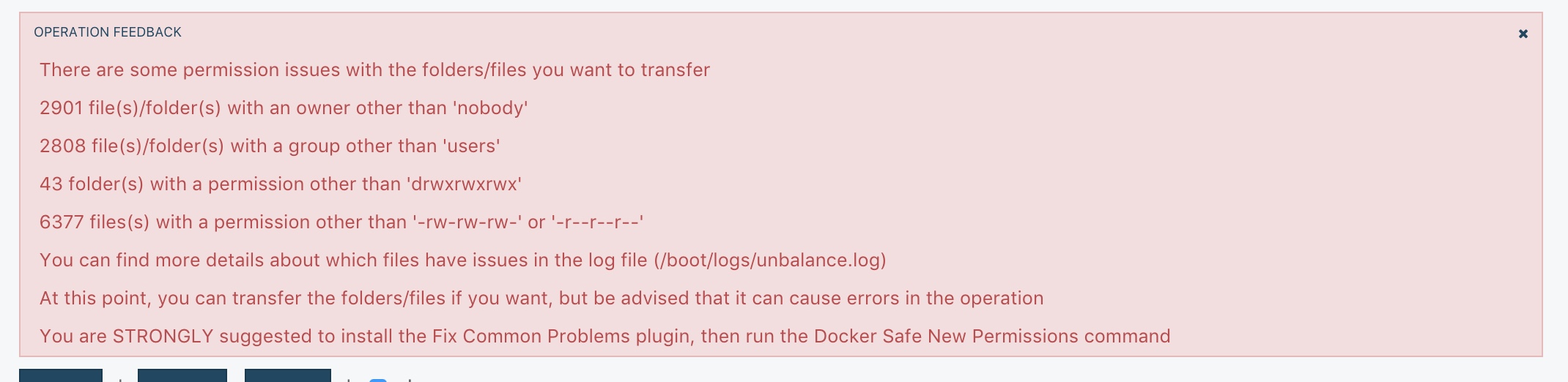

Thanks, I tried using unbalance and I received an error that recommended I run the "docker safe new permissions" command. I ran Tools => Docker Safe New Params a few times but I still get the same unbalance error. Is there more forceful way to run it this? I can tell that they are folders I manually copied stuff to about 6 months ago so I bet I was responsible for the permissions being a little screwy.
Sorry, I don't use unbalance, you can post in that support thread, alternatively you can use midnight commander (mc on the console) and move data from /mnt/disk3 to /mnt/disk1 and 2
