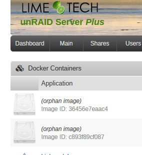

If you switch to the advanced view you can see the orphaned images of your old dockers so you know what you're missing, but unless you have backups you might have to try and remember your old path / port mappings.

Thanks for this, but do you have any idea how to find what these two orphaned images are? I can't seem to remember them all, and I can't seem to find out with the ID's...
You can't really tell what they were once they are orphaned; however if you go to the Apps tab, click on the green stacked bars and select Previous Apps it will show you the Dockers and Plugins which are no longer installed.  You can select them from the list and they will be reinstalled with all the settings/configuration they had at the time they were uninstalled/orphaned.
