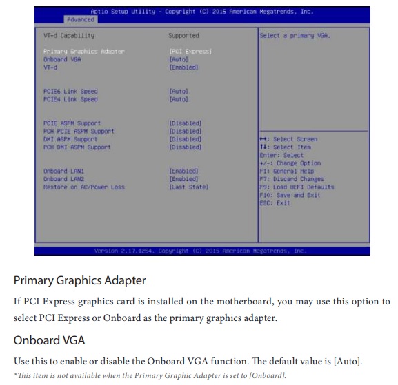

February 15, 20188 yr Author I looked at the manuals from Asrockrack site and not a word there about intel HD graphics, just this: correct if I'm not right If i set primary graphics adapter to onboard (i need it for passthrough), onboard vga option became inactive and i have Aspeed(primary)+Pci-e( vm passthrough) and no HD Graphics! But if i set primary graphics adapter to pci-e, onboard vga option became active and allow to use hd graphics??? Is intel hd graphics works only when primary adapter is pci-e??? my mind is broken %) Perhaps a board like the Supermicro i look at X11SAE-F Edited February 15, 20188 yr by vanes

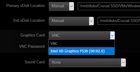

February 16, 20188 yr 2 hours ago, Jessie said: Unless things have changed with 6.4, you can't pass through the onboard graphics. You can use it for the unraid cmd line interface. But plugin cards must be used for pass through. If you are referring to the AST2400 or other "onboard graphics" for IPMI, this is probably true. If you are referring to CPU integrated graphics, it appears that it can be passed through. I am not passing through any graphics card to my Windows 10 VM, but, here are the options I have in the VM configuration: And here is a discussion started by jonp on passing through integrated graphics: As the OP explained, he does not want to pass through integrated/onboard graphics, he will pass through a discrete PCIe card to his VM. He is just trying to figure out if a motherboard with "onboard graphics (AST2400 for IMPI)" can also utilize the "integrated graphics" in his CPU for Plex transcoding. The only board I have with IPMI (C226 chipset) specifically states that integrated graphics cannot be used because of the AST2300 for IPMI. I don't know if that changes with a C236 chipset and AST2400.
February 16, 20188 yr 20 hours ago, vanes said: correct if I'm not right If i set primary graphics adapter to onboard (i need it for passthrough), onboard vga option became inactive and i have Aspeed(primary)+Pci-e( vm passthrough) and no HD Graphics! But if i set primary graphics adapter to pci-e, onboard vga option became active and allow to use hd graphics??? Is intel hd graphics works only when primary adapter is pci-e??? my mind is broken %) This is how I interpret this as well. If Primary Graphics Adapter is set to "Onboard" the ability to enable or disable "Onboard VGA" is not displayed since you cannot disable the Primary Graphics Adapter. If the Primary Graphics Adapter is set to PCI Express, you can enable/disable "Onboard VGA." However, I assume the "Onboard VGA" referenced here is the AST2400. This implies to me that the same statement made about my C226 board with AST2300 still applies. With "onboard graphics" from an AST2300/2400, integrated graphics from a CPU cannot be used. I wish I could test this, but, I cannot with the boards I have since my C236 board lacks IPMI/AST2400. As I said in a previous post, I can find no way to utilize the HD 4600 graphics in the i5 4590 CPU in my C226/AST2300 board. Because of the AST2300, no drivers are loaded by the BIOS for the integrated graphics even though I can load i915 there are no /dev/dri/ card0 and render128 drivers available for the integrated graphics. @vanes You might get a better response if you posted your question in one of the threads about enabling hardware transcoding in Plex. Perhaps someone there who has enabled hardware transcoding with IGD/QSV also has an IPMI board with AST2400/onboard graphics and can provide a more accurate answer.

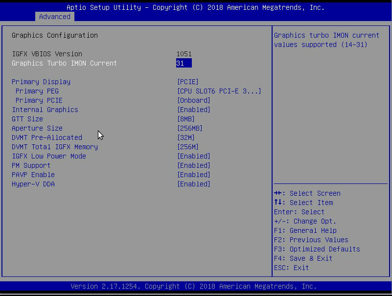

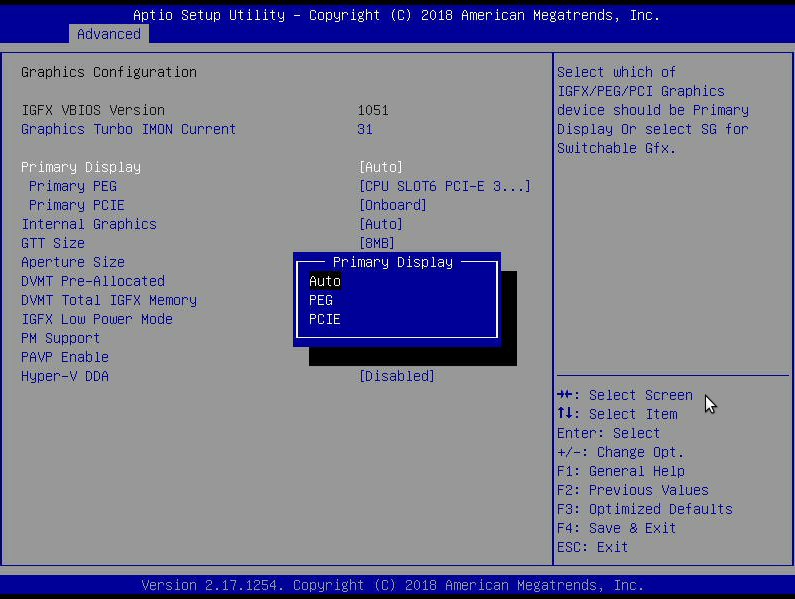

February 16, 20188 yr Author My common sense dictates that I need MB that support ipmi and have hdmi or displayport output =) i read supermicro x11-sae-f manual and found that there are tons of vga/graphics/ settings: https://www.supermicro.com/manuals/motherboard/C236/MNL-1820.pdf Onboard VGA Enable/Disable (JPG1) Primary Display Use this feature to select the graphics device to be used as the primary display. The options are Auto, IGFX, PEG, and PCIE. Primary PEG This feature allows the user to select the primary PCI Express Graphics (PEG) slot. The options are Auto, CPU SLOT6 PCI-E 3.0 X16, and CPU SLOT4 PCI-E 3.0 X8 (IN X16). Primary PCIE (PCI-Express Graphics) This feature allows the user to specify which graphics card to be used as the primary graphics card. The options are Auto, Onboard, PCH Slot3 PCI-E 3.0 X1, and PCH Slot7 PCI-E 3.0 X1. Internal Graphics Select Auto to keep an internal graphics device installed on an expansion slot supported by the CPU to be automatically enabled. The options are Auto, Disabled, and Enabled It is necessary to study all this for a longer time, but it seemed to be that this board can do what i want..... I will just need to set iGFX as a primary display and all will work! @Hoopster , Thank you very much for your responsiveness. Edited February 16, 20188 yr by vanes
February 16, 20188 yr 19 minutes ago, vanes said: It is necessary to study all this for a longer time, but it seemed to be that this board can do what i want..... I will just need to set iGFX as a primary display and all will work! Yes, this looks very promising. I think this board may give you the options you need. I am sure others have or will have the same needs you do with respect to IPMI, integrated graphics and PCIe discrete graphics pass through. Let us know how it goes.

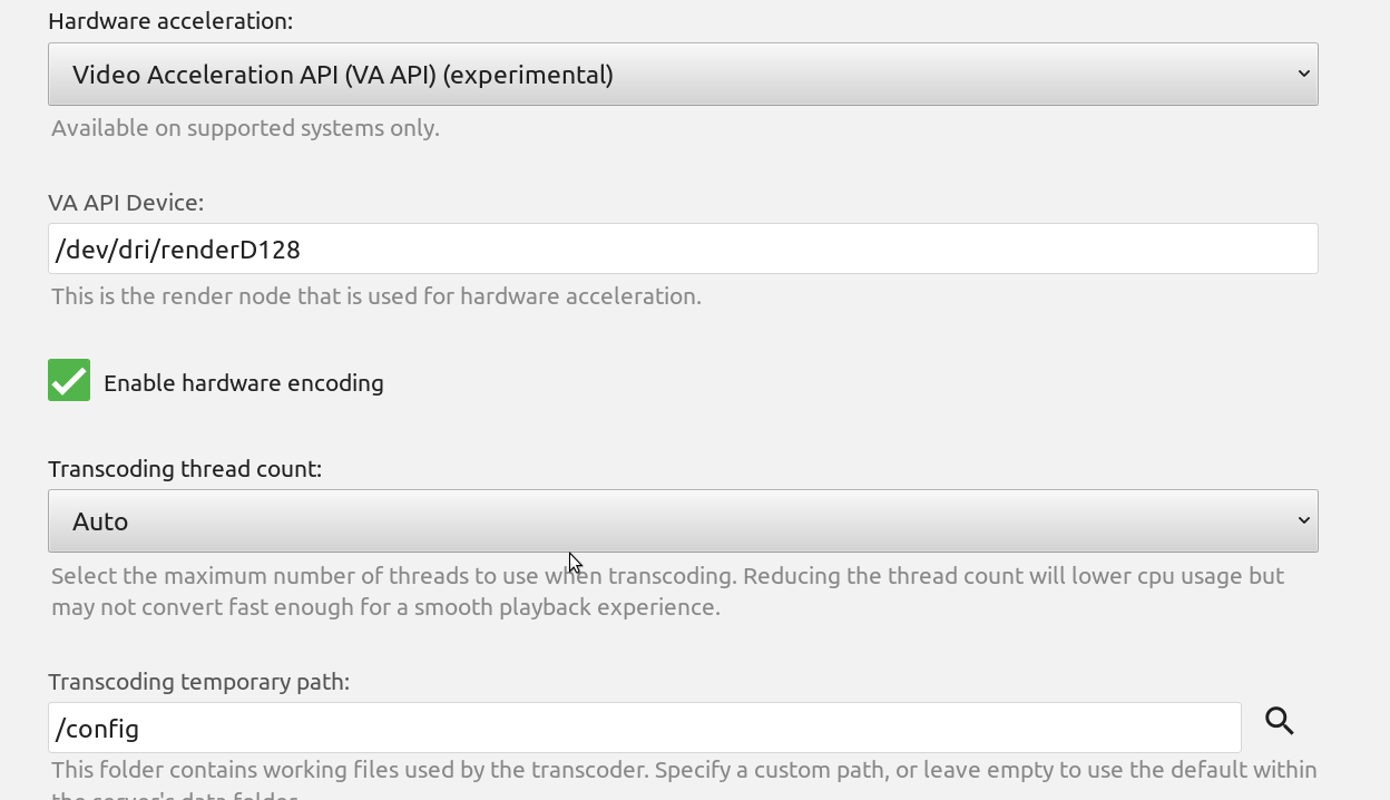

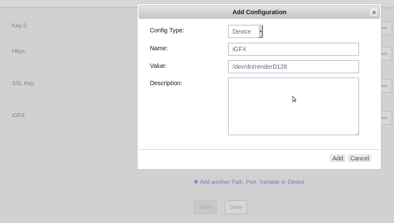

April 1, 20188 yr I can confirm this works with a Supermicro X11SSH-F c236 chipset and an Intel Xeon CPU E3-1245 v6 on unRAID 6.5.1-rc3. Initially I had trouble getting /dev/dri to show up but removed nomodeset from the syslinux append line and no need for i915.alpha_support=1. My BIOS is Version: 2.1a which is needed for the Xeon v6: BIOS lies as there is no IGFX option but here's my current config below: In my go file I added this: #enable module for iGPU and perms for the render device modprobe i915 chown -R nobody:users /dev/dri chmod -R 777 /dev/dri I'm not sure if this is the proper way to do it but in my EmbyServer docker I added the device /dev/dri/renderD128 with +Add another Path, Port, Variable or Device And in the Emby transcoding section I have it setup like this: And this is is what htop looks like before and after. This is transcoding a 1080p to 720@1Mbps and also one movie was direct playing since someone started a movie. without hardware acceleration: with hardware acceleration: Also console redirection may not work with the iGFX as the main graphics in unRAID but will work up until unRAID loads plus all other IPMI functions do work. I think other c236 boards will work like the X11SSA-F, X11SSI or X11SSM-F. I was looking at the X10SLH-F also which is a c226. Also Emby does have a Quicksync option. I tried just adding the/dev/dri to the docker but I couldn't get that to work. I was able to get VAAPI to work as shown above. So if anyone knows a better way let me know. Edited April 1, 20188 yr by dmacias

August 1, 20188 yr Author i915 is not loading by default! To activate it add this to go file On 4/1/2018 at 8:58 AM, dmacias said: #enable module for iGPU and perms for the render device modprobe i915 chown -R nobody:users /dev/dri chmod -R 777 /dev/dri if I turn i915 off, I cant use intel hd graphics for plex/emby hardware transcoding sorry for my English ? Edited August 1, 20188 yr by vanes
