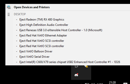

OK, maybe a daft question but how do I "safely remove"  the card in Windows 10?   I can't see any option to do that.
You have never safely removed a USB drive?
There is an icon of a thumb drive on the right side of the task bar. Clicking this will give you a pop-up with some devices to remove.
I don't have this icon unless a USB drive is plugged in??  Even when I plug in a USB drive, it only shows me the USB drive.  I'd never heard of "ejecting" a graphics card, hence me asking :)

Have you installed the virtio drivers and guest agent?
This is how it looks here when clicking the USB icon.

OK thanks, I see them now.
I don't suppose you know any way to script the eject do you?  Google shows me how to script eject of a drive letter, but not a device.
