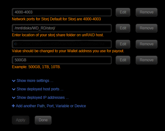

SETUP REQUIREMENTS:
    1.   TCP ports 4000 open on host and setup on container (should be set below)
          Ports 4001-4003 are used to tunnel a connection if 4000 is closed, but this typically results in no data being shared.  Port(s) 4001++ are used when running multiple nodes.

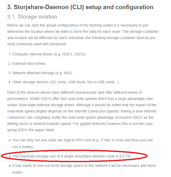

    2.   Path on host for Storj data to sit.  IE: make a user share,  /mnt/user/storj  or similar.
    3.   Your Ethereum-based wallet address.
    4.   The max allowed space STORJ can take up on the host; remember to make it less than space available on host.  (500MB, 1000GB, 1TB, 8TB   Note 8TB is maximum size per node)

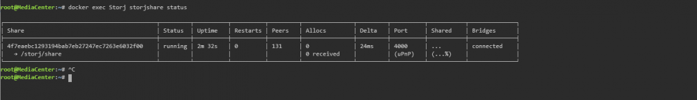

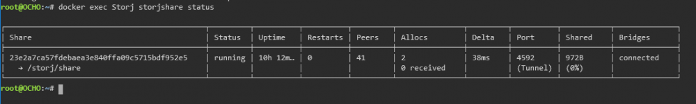

STORJ DAEMON STATUS:  (In your command line)
docker exec Storj storjshare status

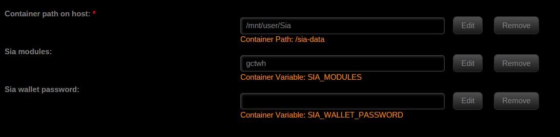

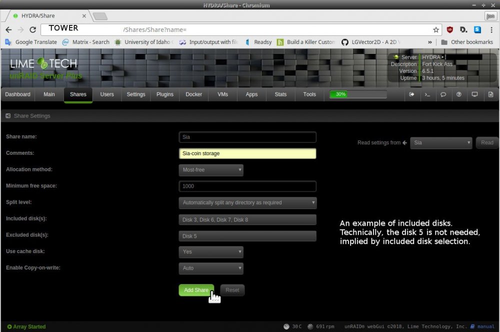

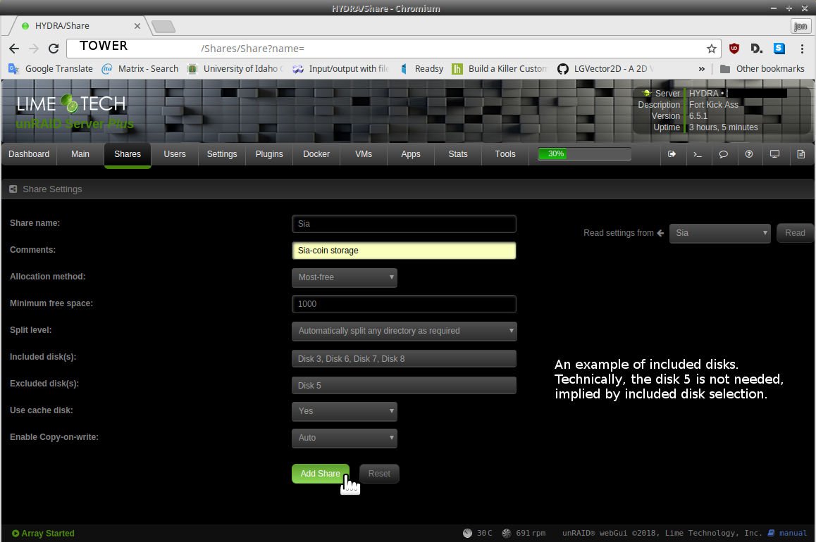

SETUP:

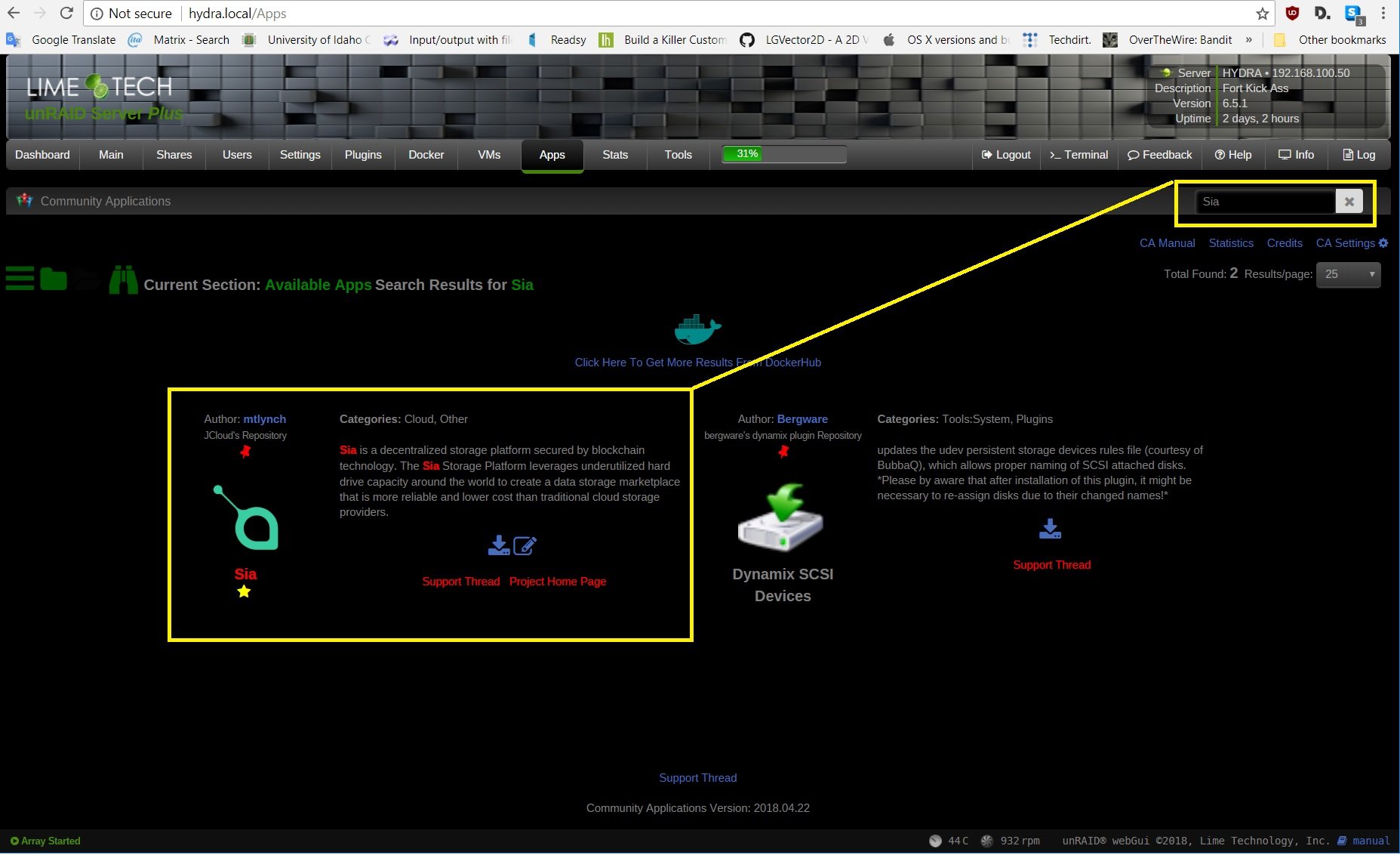

 1.   User share for Docker data, I just called it, “Sia”:
Example
2.  Punch hole in firewall for outside to your docker's ip address, TCP ports 9981 and 9982.
   DANGER! : Sia also uses TCP port 9980 for command & control, do NOT expose 9980 outside of your network! Failure to follow this rule can result in wallet and Sia host hijack.
3.  Download the Sia client from download URL, if you want a GUI experience.
4.  Setup Sia template and docker container on unRAID using CA store.

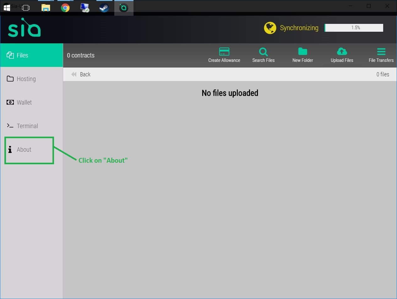

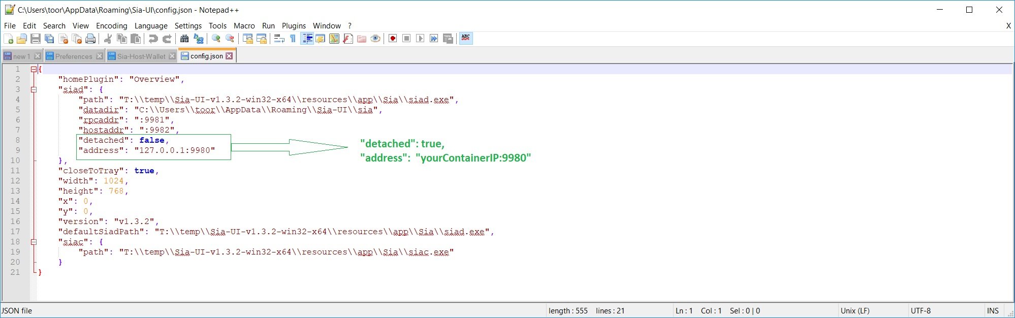

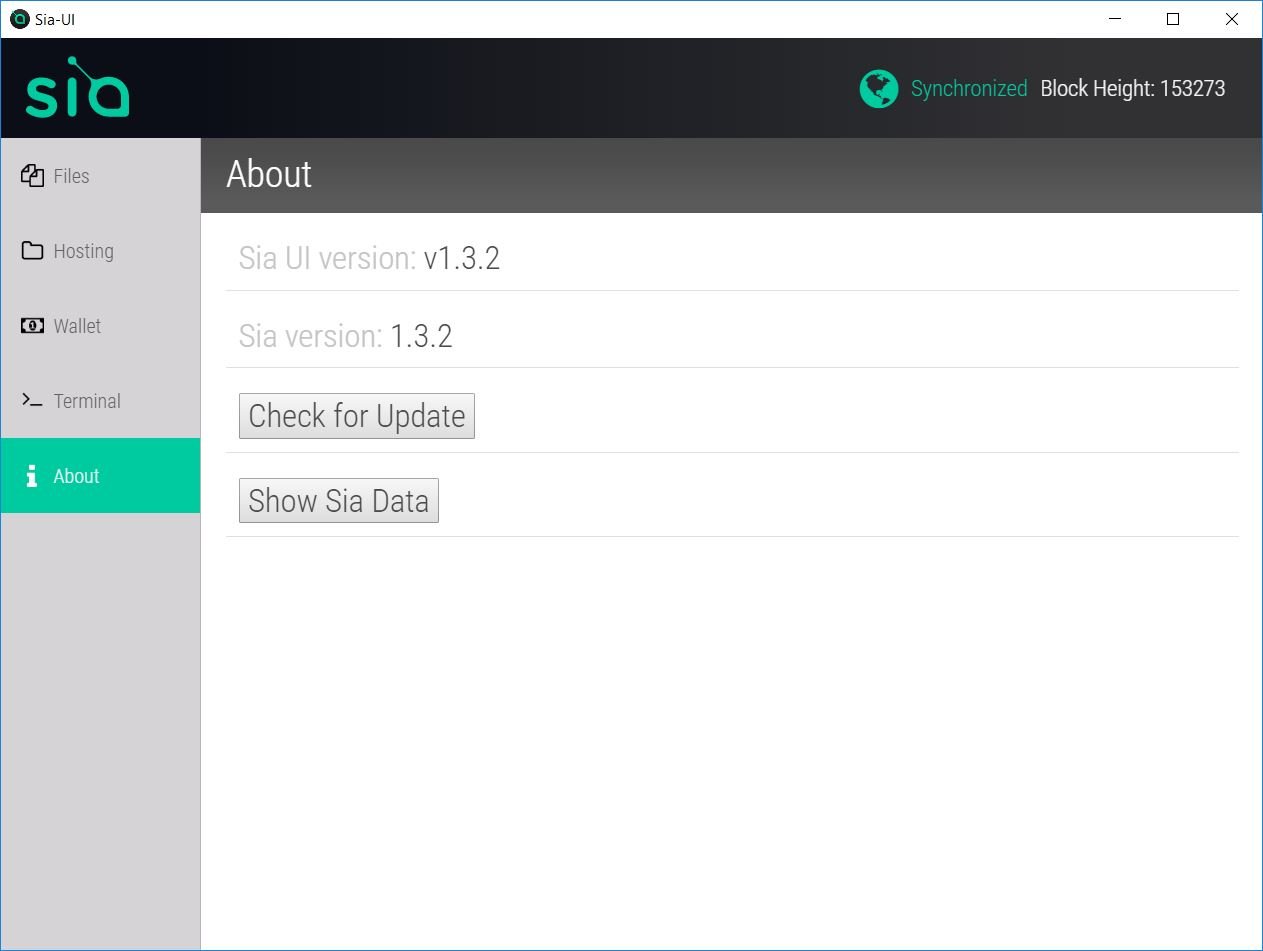

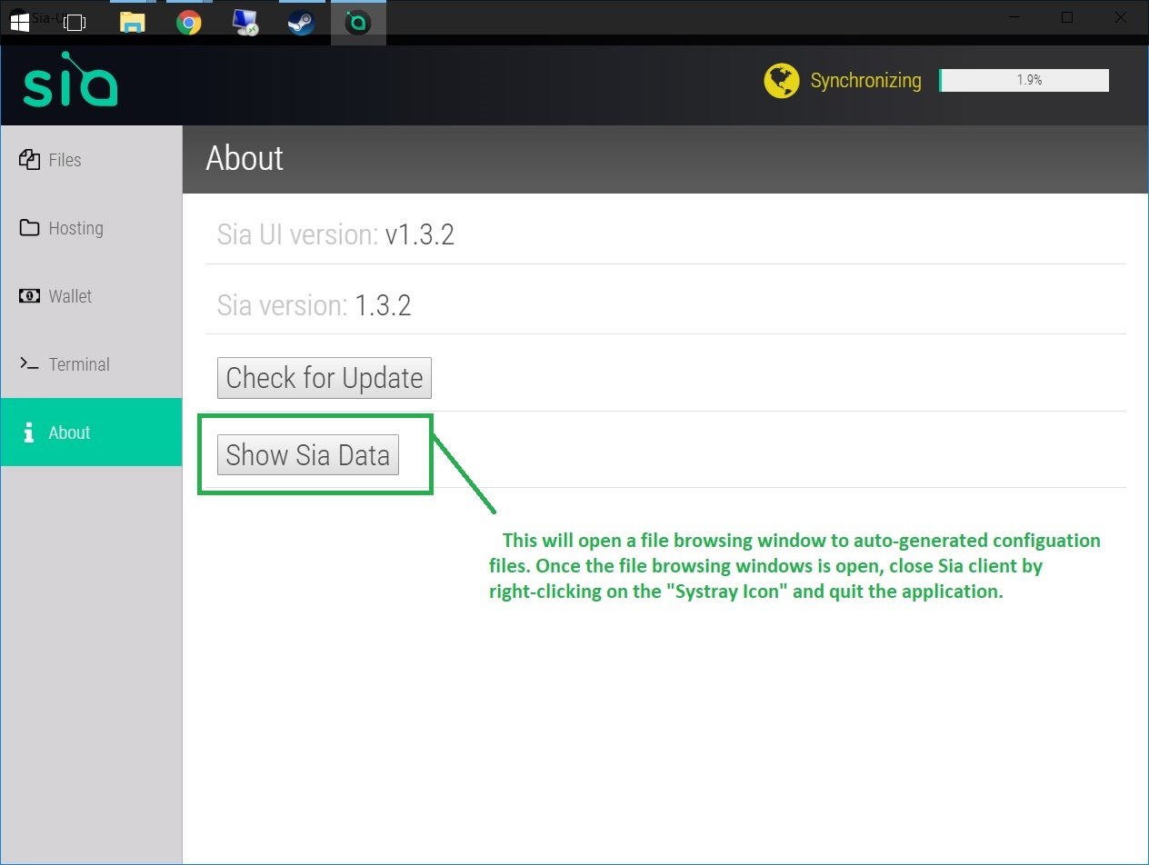

5.  For GUI clients, running on a VM or on the LAN:
Start the Client and Click on "About"Sia0.thumb.JPG.c7239b44a43057a45eb29743a672c259.JPG

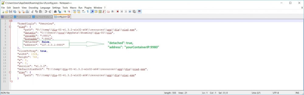

After closing Sia client, and the file manager opened to Sia's configuration files, edit the config.json file
Change "detachted": false, to    "detached": true,
In the "address" line change "127.0.0.1" to your IP address of your Sia container.
Save config.json file.
When you Restart Sia, it should connect to your docker:

I installed this docker when released & followed the guide to get operational...but it doesnt seem to be doing anything?
I have 500gb shared on my UD drive w/ the access mode set to R/W slave, ports 4000-4003 on pfsense opened and mapped to internal IP
Daemon says it is connected but I dont see any data being stored.  Any tips?
On 2/18/2018 at 5:51 PM, DaLeberkasPepi said:
ok i found the problem now!
i had to create the storj on every drive i wanted to use so for me to be able to use the 12TB i had to create the folder on at least 3 of my 4TB drives. Then it could properly recognise the available space available to storj
I think you may be running into a limitation of the storj CLI
See attached doc from storj FAQ/guides
Looks fine to me, looks like you've been allocated two units, but you're correct, you haven't gotten any data yet. As far as I'm aware, this is nominal behavior, but just in case Storj community has an active chat channel, Storj Community jump page.  You could post screenshot of the status, and ask the question, if there is something wrong they'll know for sure. If there is something that needs to be tweaked on the template, certainly can do that.
Have you updated the config of storj in the storj share? If you open the config there is good documentation where your public/DDNS should be entered.
yeah i noticed that also, thanks for posting it here for the rest. I still dont know why also my storj docker uses tunnel despite the fact that i also forwarded the ports in pfsense to the docker....

15 minutes ago, Jcloud said:
The Docker reports tunneling due to a choice I made making template,  If you want to remove that tunnel, in the template settings change "Network Type" from, "Bridge" to "Host" and then remove "Storj network ports" (which is a port forward from host to container, the source of your tunnel).
Im not sure, but i think thats wrong!
Tunnel means it cant reach the port. Thats for sure. But it has nothing to do with network type bridge or host.
Its because your standard config is "wrong".
I changed it this way:
"rpcAddress": "EnterYourStaticIPorDNS.de",
  // Port to bind for RPC server, make sure this is forwarded if behind a  // NAT or firewall - otherwise Storj Share will try to punch out
  "rpcPort": 4000,  // doNotTraverseNat: true requires you to have an external ip address.
  // You can use a proxy to gain an external IP address.  // doNotTraverseNat: false Enables NAT traversal strategies
  // first UPnP, then reverse HTTP tunnel  // if that fails. Disable if you are public or using dynamic DNS
  "doNotTraverseNat": true,
After i just c hanged this. And port forwarded port 4000 - 4003 to the unraid machine, all is working without tunnel. No need to change network type, but i guess, you could change it if you want it.
Just btw u also have a typo in the descriton from the docker template, there u say port forward port 400- 4003 ;)
Edited by nuhll

I have set it up and it looks like it's working, right?
Do I have to do something else? or now is just a matter of waiting? xD
Looks right. If you don't want it throught uPnP see Nuhll note about editing confi.jason file. Might be worth double checking, peaking at the config.jason file to make sure everything looks right in there. It's all waiting now. :)   For web interface, not with what Storj provided, and I'm not that good at programming to write my own at this time. I like to use console history to just re-exec the command, or could make it into a shell script simply enough.
