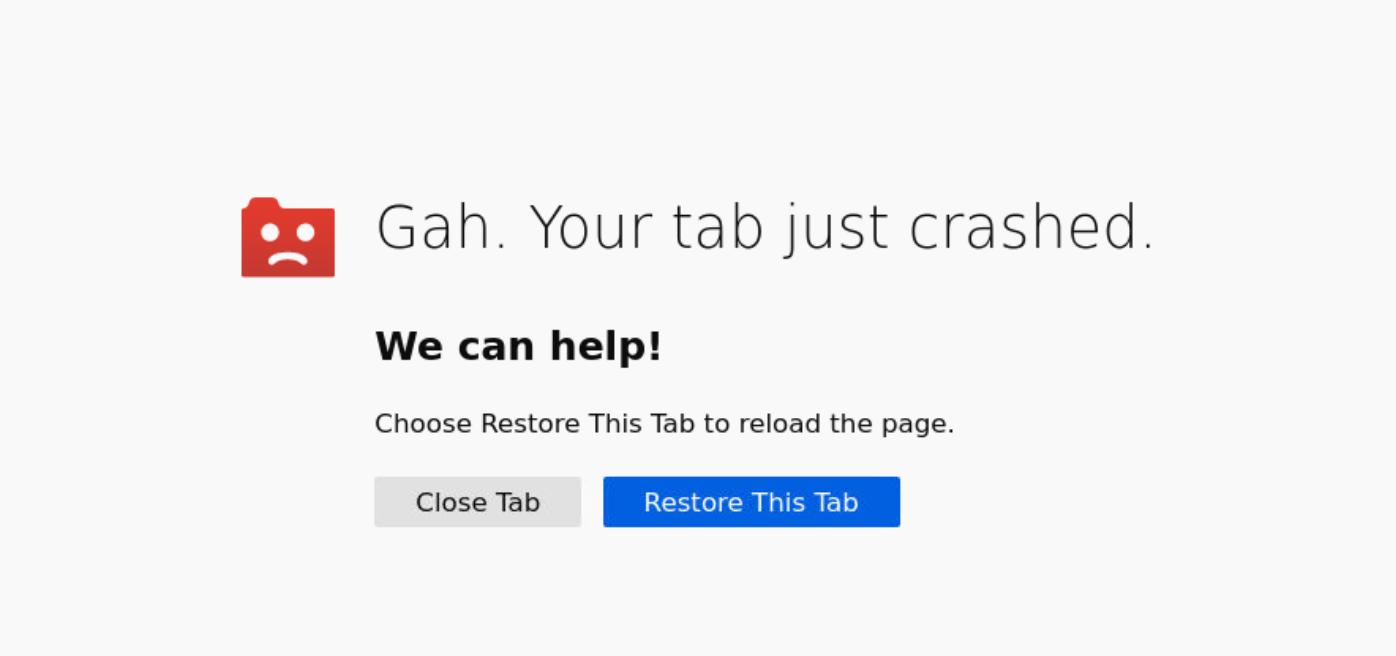

hey all, anyone having trouble with latest up date?  when i try youtube i get this error
I also noticed this issue.  I'm looking at this....
