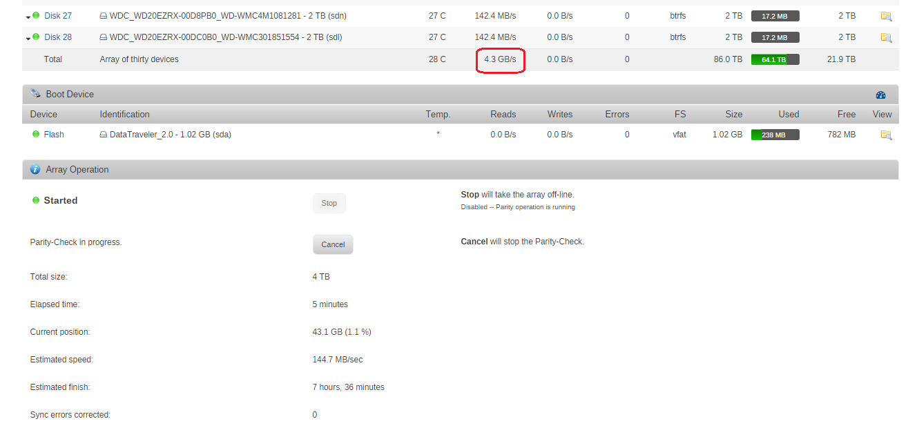

What are the best parity scan speeds seen for unRAID?
As fast as the hardware allows it, this is my 30 drive array, limit here are the WD green drives that max out at 150MB/s:
5a89ae382eef6_Screenshot2017-04-2713_59_34.thumb.png.fe773a277f2af69f1bb4fbdd4b1a5e74.png

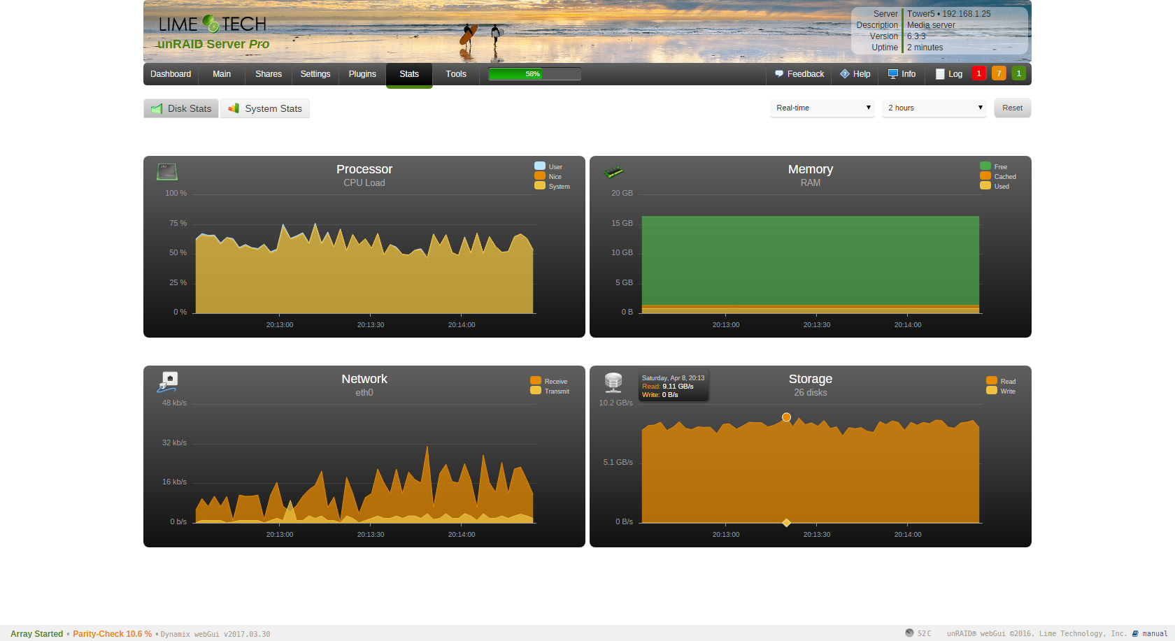

And this is my record, when I had the SSD only array:
5a89ae92d9eb3_Screenshot2017-04-0820_14_26.thumb.png.de643aba7710af7b1da78189893823d9.png
Note that the 26 disks on the stats plugin is a bug, it was a 30 disk array, parity check ran close to 300MB/s

That screenshot is from some time ago, that server now has thirty 2 and 3TB drives and less capacity than it was at the time, 76TB, it acts as backup of another server with 21 x 4TB drives and the same total capacity.
