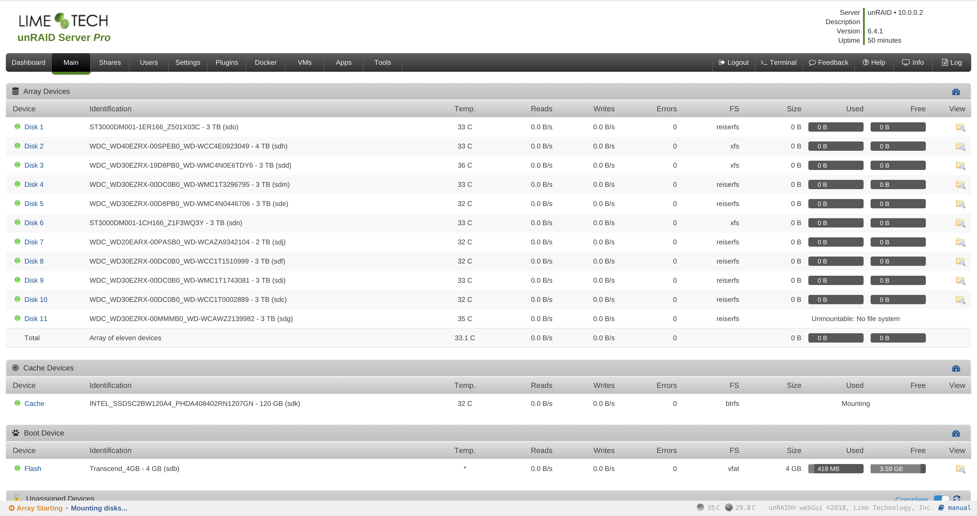

I'm having an issue getting my server started.
Last night i upgraded from 6.3.5 to 6.4.1, everything seemed to be going well and working smoothly until today when i woke up. I noticed my server was inaccessible.
I had put a new (second hand) motherboard and CPU in my server months ago and have had a few crashes since then. I only just updated the BIOS to the latest version (it was a 2012 board on its release version). Perviously i had been running a ASUS P6T and i7 920 from 2008 (24/7 for 8+ years).
Reason why it crashed aside its now not mounting disks and starting the array.
So far i have updated the BIOS to the latest version (in an attempt to help with crashes, maybe). I have booted into safe mode to ensure its not plugins causing the issues. But i'm unsure of whats next.
Any help to point me in the right direction would be appreciated.
unraid-diagnostics-20180218-2344.zip
Disk11 is not mounting, run reiserfsck on it.
To get it up and running i removed disk 11 from the config, theres nothing i need on that disk currently. I restarted the array and its up and running. Cache disk is fine.
