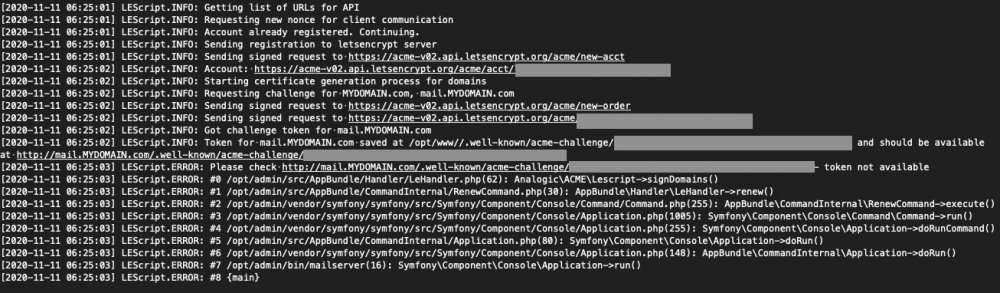

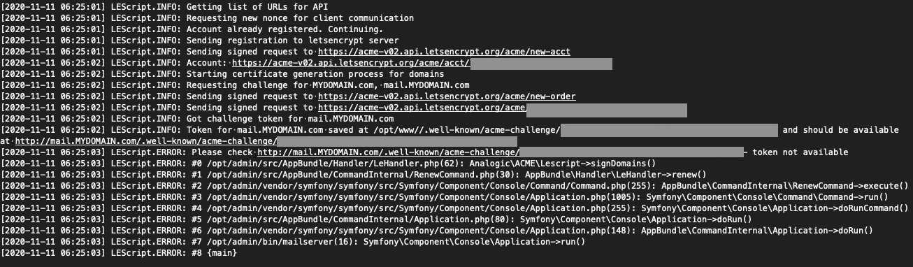

I can't create valid certificates using Poste.io's built in function (within web GUI). I don't know how to set up either of the two to work together. Any help?
I'm using Poste.io docker and I also have Letsencrypt docker for cloud and other stuff.  I couldn't find premade certificate file in UNRAID->apps->letsencrypt->nginx-> proxy-confs.
It's really annoying since my iOS devices keep bringing up pop-up "invalid certificate". Even after clicking "cancel" the prompt just keeps coming back.
Error message emailed by post.io are:
I get another message (emailed) that says:
Does anyone have a simple solution on how to make this work?
Snapshots (images) of solutions are more helpful than textual explanations.

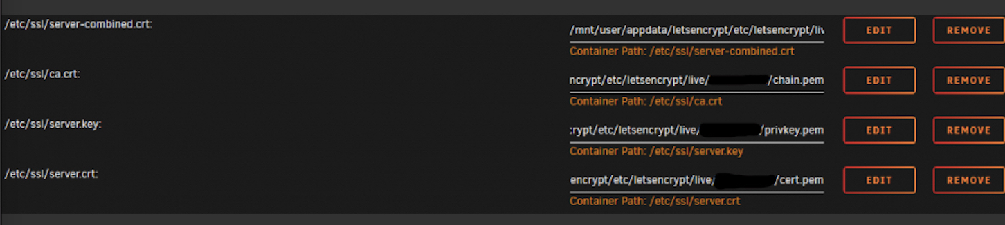

I ended up mounting the default certificate files in the docker directly to the certificates from my letsencrypt docker:
To be explicit with my volume mounts for SSL working:
/data/ssl/server.crt → /mnt/user/appdata/letsencrypt/etc/letsencrypt/live/mailonlycert.DOMAIN.com/cert.pem
/data/ssl/ca.crt → /mnt/user/appdata/letsencrypt/etc/letsencrypt/live/mailonlycert.DOMAIN.com/chain.pem
/data/ssl/server.key → /mnt/user/appdata/letsencrypt/etc/letsencrypt/live/mailonlycert.DOMAIN.com/privkey.pem
I do not recall the exact details of why the above is optimal but I suspect that Poste is handling making it's own full chain cert which results in some cert mangling if you do give it your fullchain cert rather than each separately (various internal services inside the docker need different formats) - I believe that without the mounts as above the administration portal will be unable to log you in.
As I mentioned further up in this thread you can alternatively mount .well-known folders between your Poste IO and letsencrypt docker - this will not work if your domain has HSTS turned on with redirects to HTTPS (or this was the case with the version of letsencypt in the docker a while ago as it was reported here: https://bitbucket.org/analogic/mailserver/issues/749/lets-encrypt-errors-with-caprover )
But as I mentioned further up in this thread you can also mount .well-known folders between your Poste IO and letsencrypt docker - this will not work if your domain has HSTS turned on with redirects to HTTPS (or this was the case with the version of letsencypt in the docker a while ago as it was reported here: https://bitbucket.org/analogic/mailserver/issues/749/lets-encrypt-errors-with-caprover )
  1. How did you add this:
    1. Is this, Variable, Path, Prot, Label or Device?
  2. What did you do in letsencrypt to issue certificate (I issue one for bitwarden, nextcloudetc)
    1. Did you add in "Sudomains": "mail"? (next to "nextcloud,sonnar,bitwarden...")
    2. Did you have to do anthing else on DNS provider (my MX record is enabeld)?
    3. Did you have to add .config file within letenscrypt? I see no existing template
  3. when I navigate to /etc/letsencrypt/live I don't see the 3 .pem files. Why?
    1. There is only etc/letsencrypt/live/nextcloud.MYDOMAIN.COM folder, but the folder is empty

1 - Yes these are paths.
2 - I added mail.domain.com - naturally you need to have setup your CNAME / MX records and forward ports in your router/network gateway to the Poste.io server. If you wish for the web GUI of poste.io also to be accessible externally you will also need to setup the correct reverse proxy with SWAG. I don't know what you mean by .config
3 - I blanked the folder in the screen shot as I do not want to share my domain name, but yes the subfolder with your domain name / subdomain name is where the PEM files should be if you have setup SWAG correctly to get SSL certificates. If you are lacking certificates you have probably got it setup incorrectly.

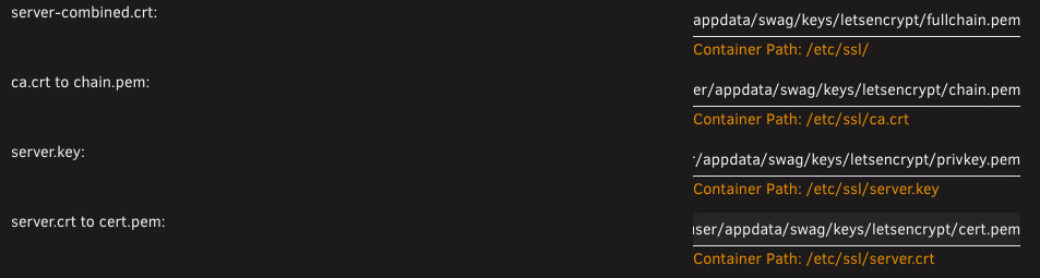

The guide may pertain to Letsencrypt docker (which is not maintained any longer and has been migrated to SWAG docker).
Your screen shot has 4 lines, what is the FILE NAME (!) of the first path? Line ends with /liv....?????
I assume it's fullchain.pem???
But that needs not be true because there is also priv-fullchain-bundle.pem file.
Your screen shot (below) shows path to swag...as /mnt/user/appdata/letsencrypt/live/SUBDOMAIN.DOMAIN.COM/*.PEM
In swag, this directory is empty  -> if you SSH into it from Docker command line, it will be empty.
The keys are stored in following directory: /mnt/usr/appdata/swag/KEYS/letsencrypt/*.PEM

What happens in practice is following:
  1. Upon generation of certificates (when swag docker is restarted), the content in the following folder /mnt/usr/appdata/swag/KEYS/letsencrypt/  disappears (is deleted by swag docker) and then new files appear, namely all certificates newly issued. The certificates in that folder have timestamp that is few seconds older than when swag docker was restarted.
    1. In other words this statement from your refernce is simply NOT true:
      1. /etc/letsencrypt/archive and /etc/letsencrypt/keys contain all previous keys and certificates, while /etc/letsencrypt/live symlinks to the latest versions.
        1. /etc/letsencrypt/keys does not contain all previous keys, because I verified this ( looked at exitigng keys frst, then restarted swag server, and the new keys in this folder were definitvly different (along with file time stamp being newer). There were no traces at all from "old" certificates.. This may be how swag docker is implemented.
  2.  Folder /mnt/user/appdata/letsencrypt/live/ has certificates only for cloud.mydomain.com....but for not other subdomains or other domains.
  3. When I point Poste.io to folder  /mnt/usr/appdata/swag/KEYS/letsencrypt/, Poste.io correctly restarts, there are no more warnings on iOS/Mac devices such as "the identity of the server yyz.com cannot be verifiied....". The aforementioned error was occurring for all 3 mail domains, for over 1 year on all of my devices.
So if your solutions works for you great (using  Letsencrypt docker), but my solution works for me (using swag docker), as evidenced by resolution of the problem that prompted me to post to begin with,  and might work for others using swag docker and poste.io.

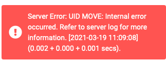

Noticed I can view messages but I can not longer delete messages. Here's the log files (logs on a recreation so time stamps are a bit off) and a screenshot.
==> mail.log <==
Mar 19 11:10:22 ce466793ae2b dovecot: imap-login: Login: user=<[email protected]>, method=PLAIN, rip=192.168.55.11, lip=127.0.0.1, mpid=14851, TLS, session=<LugE9OW9toLAqDcL>
Mar 19 11:10:22 ce466793ae2b dovecot: imap([email protected])<14851><LugE9OW9toLAqDcL>: Error: Mailbox INBOX: link(/data/domains/mymailserver.info/xaositek/Maildir/cur/1615003435.M382342P32606.3b20f19fac1b,S=6950,W=7251:2,S, /data/domains/mymailserver.info/xaositek/Maildir/.Trash/tmp/1616170222.M693717P14851.ce466793ae2b) failed: Function not implemented
Mar 19 11:10:22 ce466793ae2b dovecot: imap([email protected])<14851><LugE9OW9toLAqDcL>: Logged out in=155 out=1173 deleted=0 expunged=0 trashed=0 hdr_count=0 hdr_bytes=0 body_count=0 body_bytes=0
Mar 19 11:10:22 ce466793ae2b dovecot: imap-login: Login: user=<[email protected]>, method=PLAIN, rip=192.168.55.11, lip=127.0.0.1, mpid=14856, TLS, session=<It0F9OW9uILAqDcL>
Mar 19 11:10:22 ce466793ae2b dovecot: imap([email protected])<14856><It0F9OW9uILAqDcL>: Logged out in=318 out=4258 deleted=0 expunged=0 trashed=0 hdr_count=6 hdr_bytes=1802 body_count=0 body_bytes=0
==> mail.warn <==
==> syslog <==
