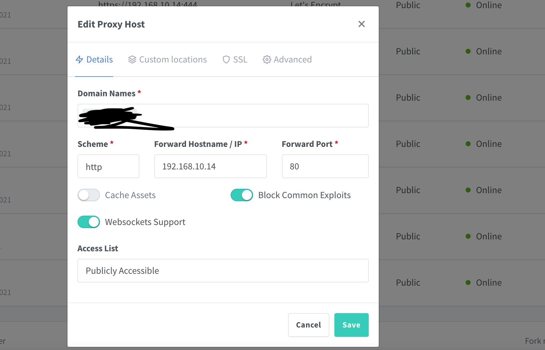

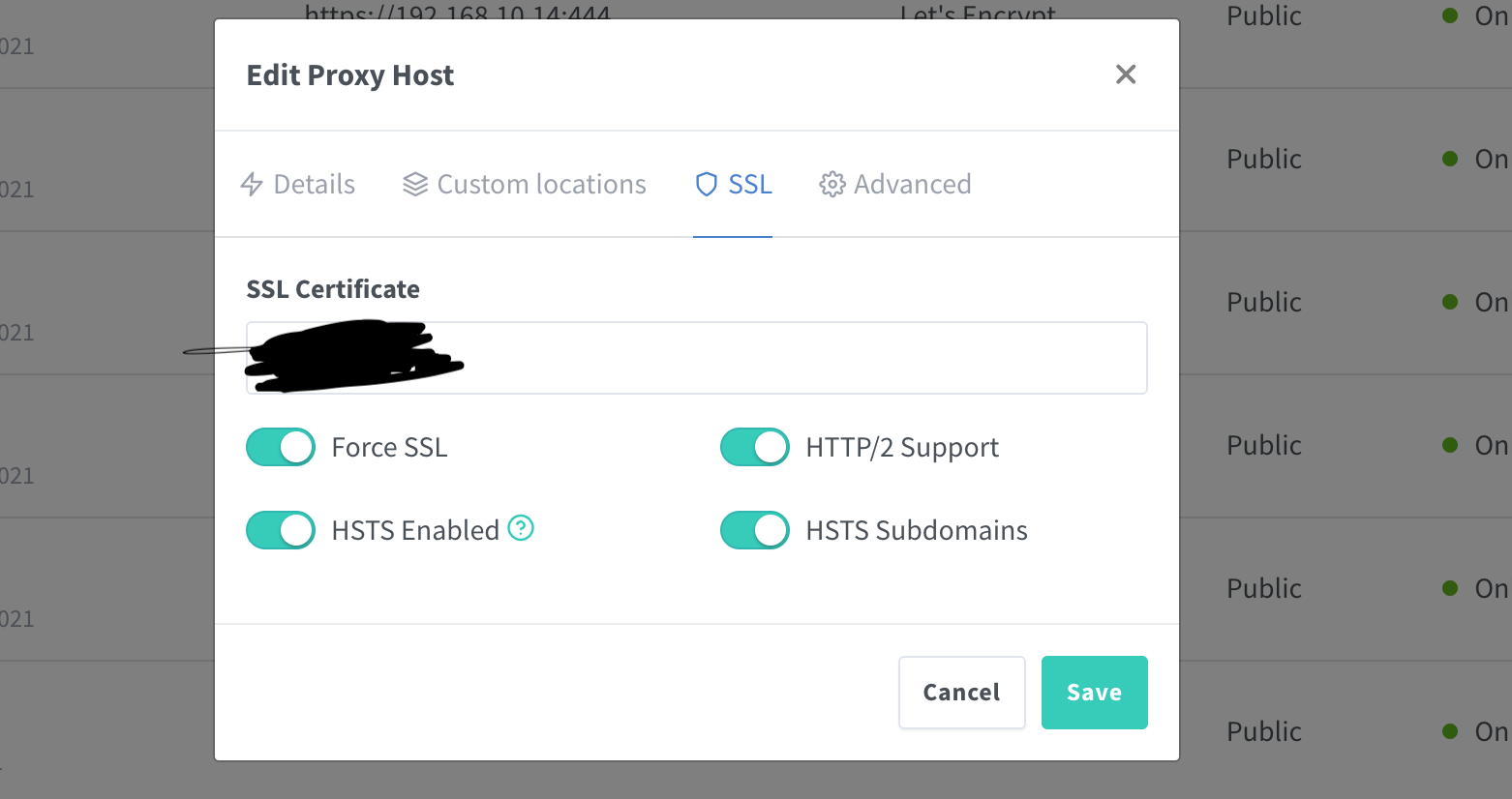

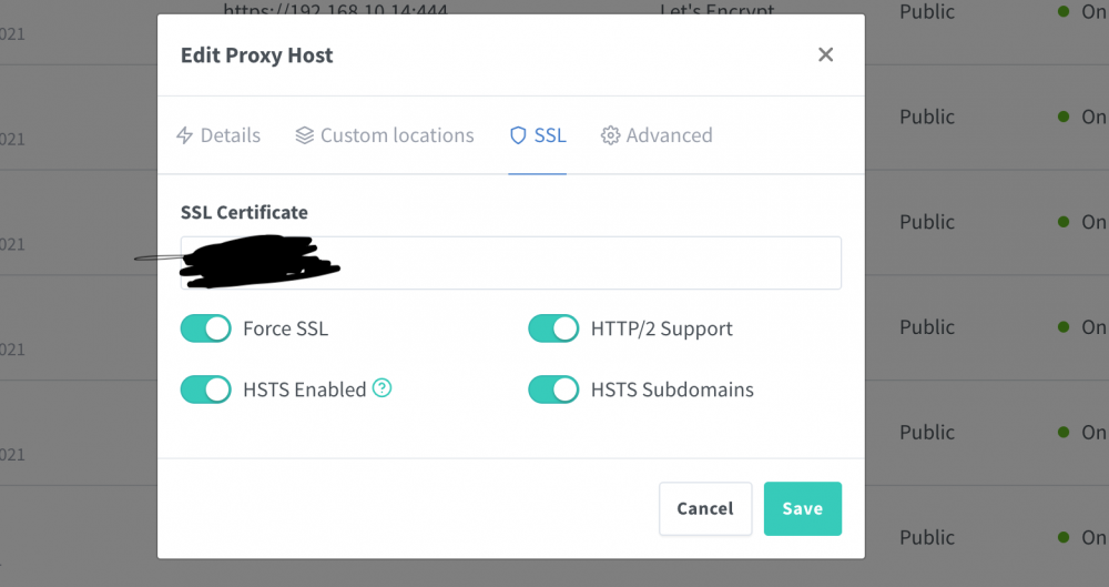

On 10/4/2021 at 11:26 PM, hjaltioj said:
Does anyone know how i can use Nginx Proxy Manager for the webmail??? I got everything working except webmail. Webmail onlu works locally via the ip:port :(
I use Nginx Proxy Manager and webmail work fine, only Let's Encrypt challenge token exchange test dosen't work. For send mail i use mailjet because i don't know why my port 25 is blocked.
