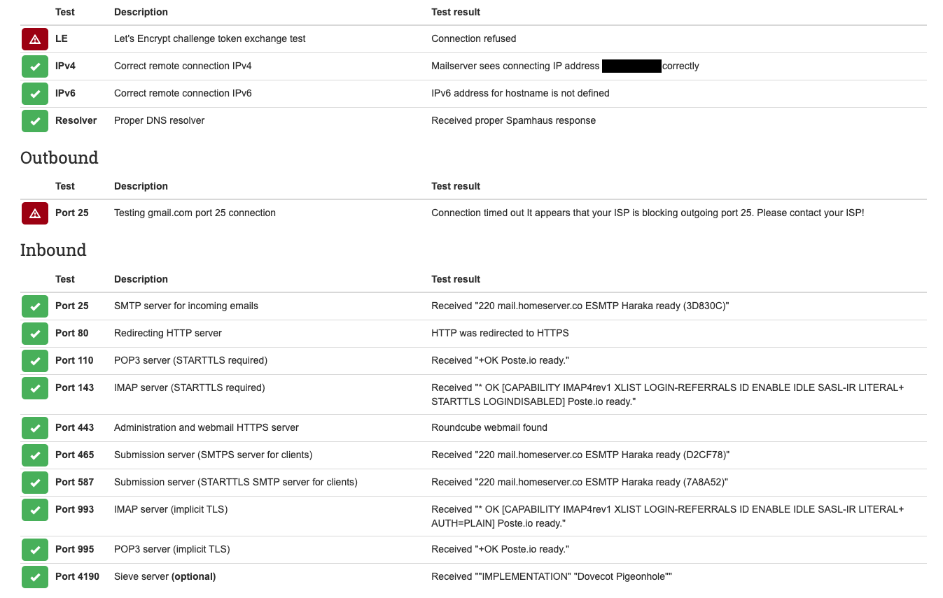

Hello there sorry for the disturb *specially at this hours eh*
But i got an error after have setuped my domain name who work nicely, when he test for the Let's encrypt challenge i just got an error i have search an hours for fix that and didn't found anything, so if someone got to know how to fix that :/

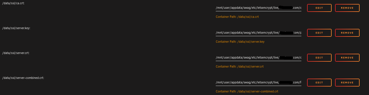

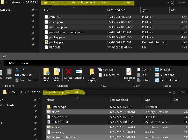

On 8/1/2022 at 10:56 PM, HKruger3324 said:
Morning,
Take a look at this link. This is how I set it up:
https://mattlapaglia.com/self-hosted-email-server-with-unraid-and-poste-io/
Mapping the cert files from Swag fixed it! Thank you!
On 8/26/2022 at 1:32 PM, Monnier Adrien said:
I have the same issue, has it been solved?
Yes! See the above post to map the cert files. That worked for me just now.
Although, I'm using Swag, which uses a different path for the files:
/mnt/user/appdata/swag/keys/letsencrypt/
instead of:
/mnt/user/appdata/NginxProxyManager/letsencrypt/live/npm-33/

My certificate is good but i also encounter the problem.
After several tests with poste.io, I realized that the problem probably comes from the DNSBL function with zen.spamhaus.org because I have the same problem when I activate it on Docker-mailserver, all incoming mails are rejected.

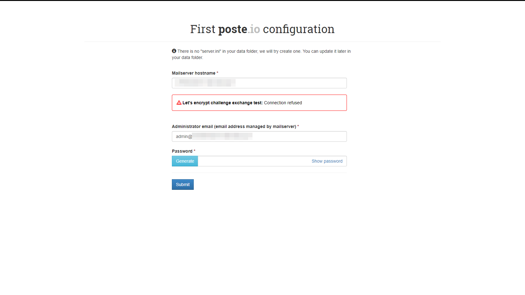

Im unable to reach the webui admin page.
10.0.0.111:8280 redirects me to https://10.0.0.111/admin/install/server
When i try  https://10.0.0.111:8280/admin/install/server it says it cant provide a secure connection.

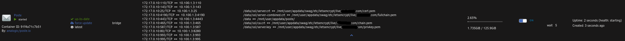

Anyone else having the docker fail to start after the latest update?
I'm on Unraid version 6.12.6, and noticed the docker wasn't started yesterday, after updating the night before.
The docker just says "Execution Error" and "Server Error" on the same popup whenever I try to start it.
I even tried reinstalling using the 2.4.10 version, but still got the same result.
EDIT: Wanted to mention that it was working fine before the docker updated.
EDIT 2: I was able to delete the container, reinstall it with the cert paths pointed to the correct locations in Swag (it changed, and broke it I'm guessing), and now it starts. I can see the files get copied, but I can't get to the web UI. It just says 404 Not Found. I've tried with and without the "-e "HTTPS=OFF" parameter. I even tried changing the container paths to be "/etc/" instead of "/data/", but still no luck.No clue what else to do.
EDIT 3: I finally figured it out! It was missing port 8280 from the URL when accessing the web UI. Interestingly, it randomly started doing that automatically when accessing it locally form Unraid. I just noticed it now once it started working. I had to edit the Swag proxy-conf to fix accessing it via public URL.
Edited by carnivorebrah

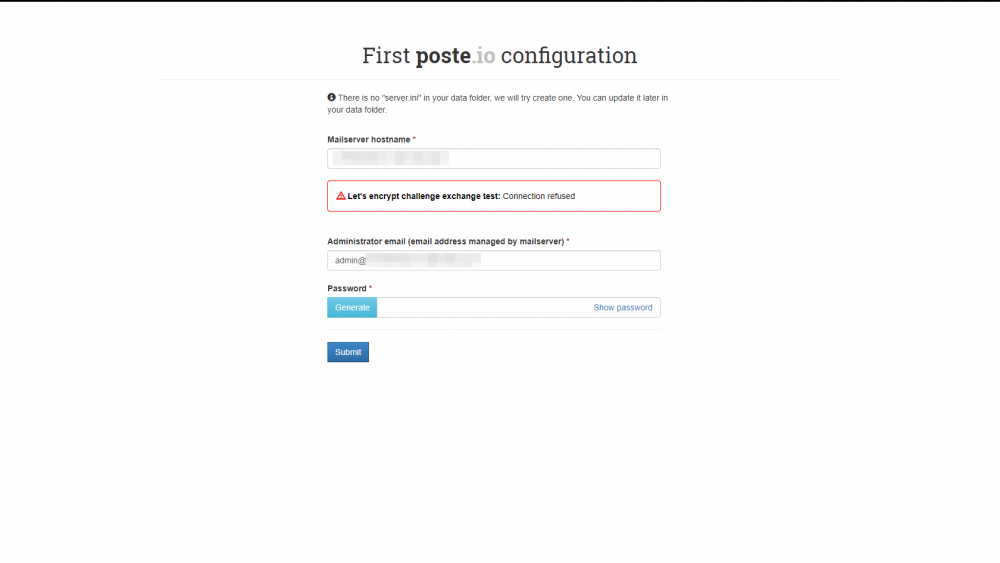

I've had poste working for quite a while but after I switched my reverse proxy to traefik, I have had issues keeping poste working properly. Currently, mail.homeserver.co letsencrypt certificate is issued using traefik with ports 80 and 443 being handled by traefik. I then have ports 25,110,143,465,587,993,995,4190,8080,8443 forwarded directly to the container. With this configuration, I have attached a screenshot of the connection diagnostics. But when I attempt to add the mail account to a device, the device says the certificate is untrusted because it's expired. I think poste doesn't like the fact that traefik holds the TLS certificate for mail.homeserver.co. I tried to use tls passthrough in my traefik config to allow poste to handle the tls certificates for simplicity but this way I am unable to access the host. If I attempt to issue new certificates using the poste admin panel, it keeps failing. Can someone help me figure out to fix this?
