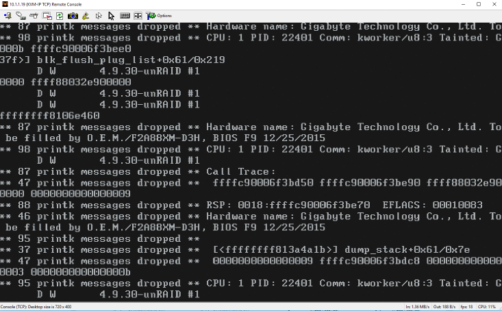

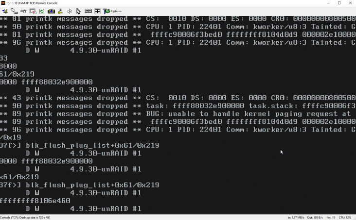

Came home from vacation to find my unRAID server in a tizzy.  Not sure if it overheated or just had a brain f-rt.  It was locked up - no network, no drives accessible, no web mgmt accessible and spewing the follow errors on console screen (couldn't capture the text):
5a8b0cdea2606_2018-02-1812_30_28-10.1.1.19(KVM-IPTCP)RemoteConsole.png.b729fdeca10ca5305ea0468c14d56753.png

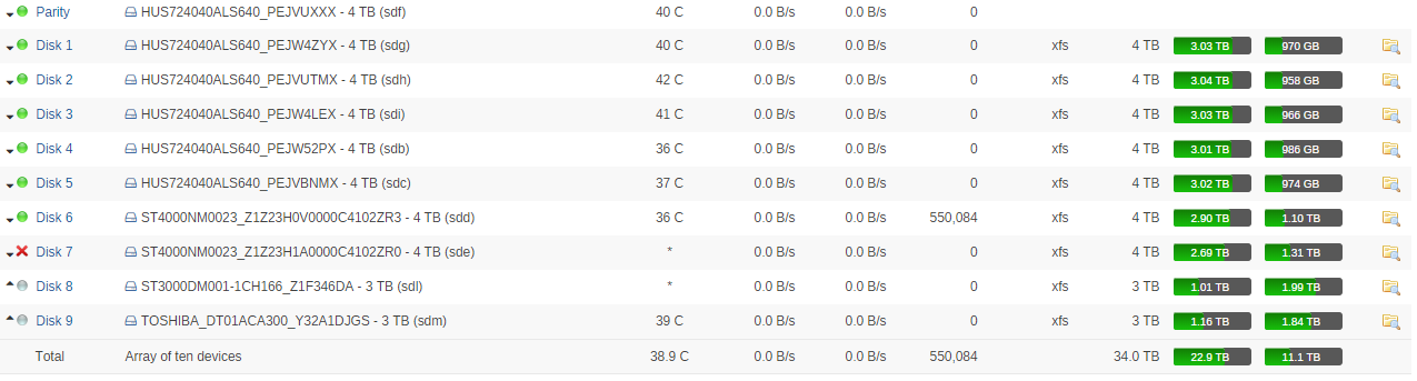

Upon restarting the server, I have one disk disabled and one disk showing errors.  Array is started and is accessible, but I'm afraid to write data until I get this figured out.
Grabbed a diagnostic and attached here.  Wondering if anyone sees something I don't.  Just starting the troubleshooting process and wondering if I should focus on Disk 6 or 7 first.

Problem in two disks at the same time would point to a cable/power problem, since they share the same miniSAS cable that would be the first thing to replace if you have a spare, then if it looks stable you need to rebuild the disable disk, using the old disk or to play it safer using a new spare.

Don't have a spare mini-SAS cable, but just ordered one.  I shutdown and re-seated all cables and power to the drives and booted up again.  Disk 6 is no longer seeing errors, but I'm guessing it only resets the counter to 0 on reboot.  Should I run a parity check while Disk 7 is disabled to see if Disk 6 is still having issues?

You can, if there are more errors it won't damage anything, and if there aren't you should also be able to rebuild the disable disk, check that contents on the emulated disk look correct before rebuilding on top of the old disk (or use a new disk)
I'd suggest taking the time to check out the simulated disks in unRaid. (When disks are kicked from the array, they are simulated using parities and the other data drives in the array). Check to make sure the simulated disks contain files, and don't appear unformatted. And I'd check a small sampling of files for accuracy, including some of the newer files copied to the disks.
If they look perfect, you could restore data to the kicked disks. But I don't recommend it. The kicked disks are likely perfect (or near perfect), and if anything goes wrong with the rebuild, they are your plan B. You could rebuild one to a new disk, and if it works, rebuild the second to the disk that is already successfully rebuilt. That would be my suggestion.

Thank you for the suggestions.  I'm in the process of doing a parity check again to verify Disk 6 that had tons of errors.  Also taking your suggestion and looking at files on the simulated disk.  So far all the newer files are fine and parity check is 50% done with no errors.
I suspect this was either a cable, controller, or (less likely) heat issue that caused the crash and kicked the disk.    I'll report back with my continued results.

So just following up on this thread.  Powered down the server and re-seated all the power and SAS cables.  I ran SMART short and long tests on both Disk 6 and 7 and they passed.  Decided to re-add Disk 7 to the array.  It's now rebuilding and so far no errors or issues.
I'll be replacing the SAS cable this week when the replacement cable shows up just to be sure.
