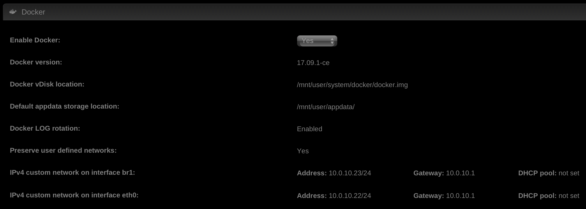

Thanks @bonienl for the followup. Perhaps this has something to do with the way the "custom" networks are being discovered then? Here is my Docker settings in UR:
5aa58cc9601f1_ScreenShot2018-03-11at4_08_27PM.thumb.png.97062f696fdda4afdd346dba21505dd2.png

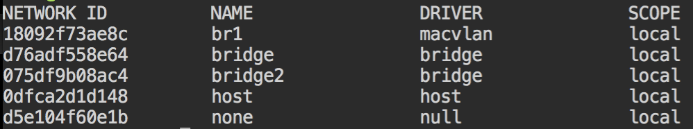

But you will notice here, that I have another customer network named "bridge2":
5aa58d321525b_ScreenShot2018-03-11at4_09_57PM.png.d3ced68d31d933598c9c9090ebd8475c.png

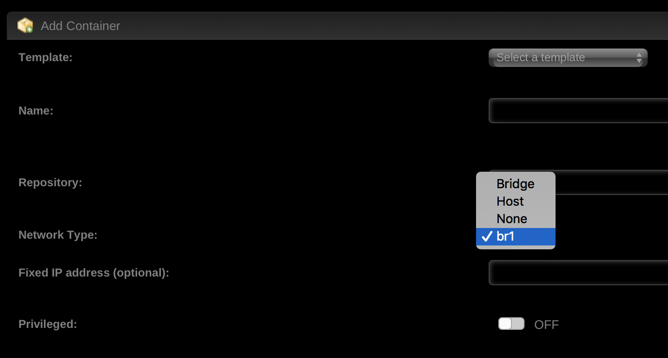

But this custom network is not showing up:
5aa58d610b30b_ScreenShot2018-03-11at4_10_55PM.thumb.png.06b180cc478768efc30b3af8d294c83c.png

The current implementation only looks for additional macvlan custom networks. You have a second custom bridge network which is not included.
And eth0 is not created because it has the same gateway as br1, which Docker doesn't allow. You either remove the gateway from eth0, or give it a unique value.
