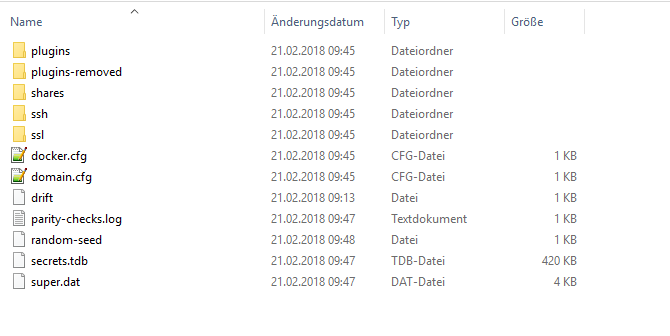

I try again - on the old defective bootstick are following dirs and files.
First picture is root. In all dirs in the root, except of the config dir are no !  files.
 In second picture are the dirs and files of config dir.
I hope i made it clear now.

My guess is those files were written after the move, since they have a recent timestamp and there are other files missing that should be there, such as the key file.
But most importantly, it looks like you still have super.dat, which is the disk assignments.
Make a copy of everything you still have on the original flash just in case there is something useful there. Most importantly, make a copy of super.dat because it is useful.
Then proceed as I said about preparing the original USB for a new install, but in addition to copying the key file to config, also copy super.dat.
Then try to boot up with it.
