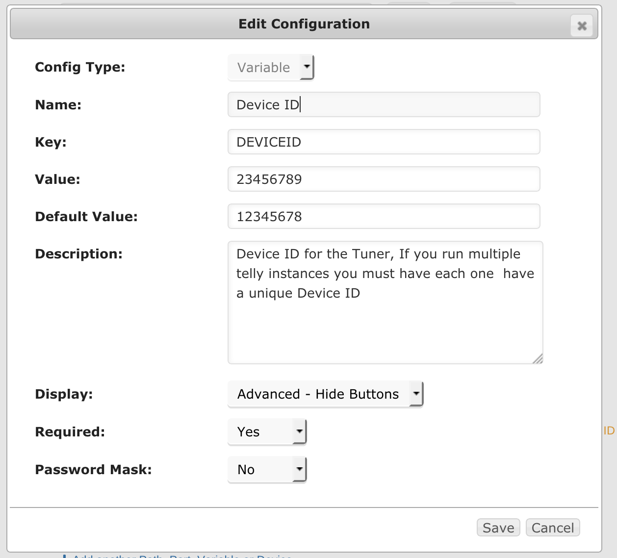

I did wonder if it was they were both called silicondust? but one is silicondust telly and the other is silicondust tvhproxy where do you change the ID I already looked in the docker template but couldn't see anything?
Can you try running telly with the `-deviceid 87654321` option?
ok, will report back shortly thanks!
5aa85ae3e3651_Screenshot2018-03-1318_10_18.thumb.png.4c20e41c9bdb144553d5254360fbfc45.png

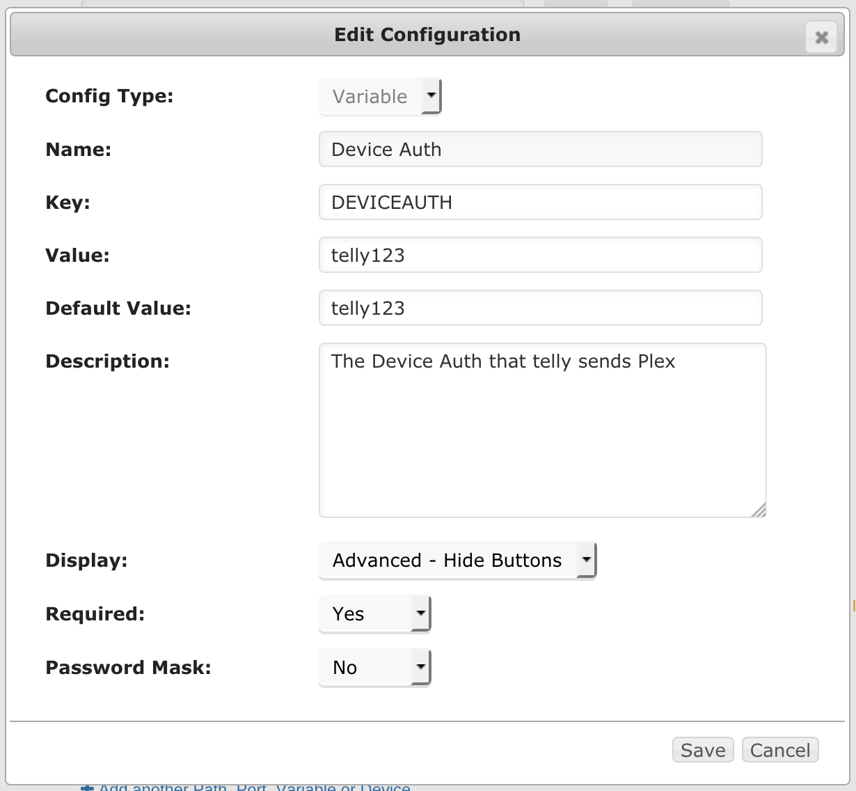

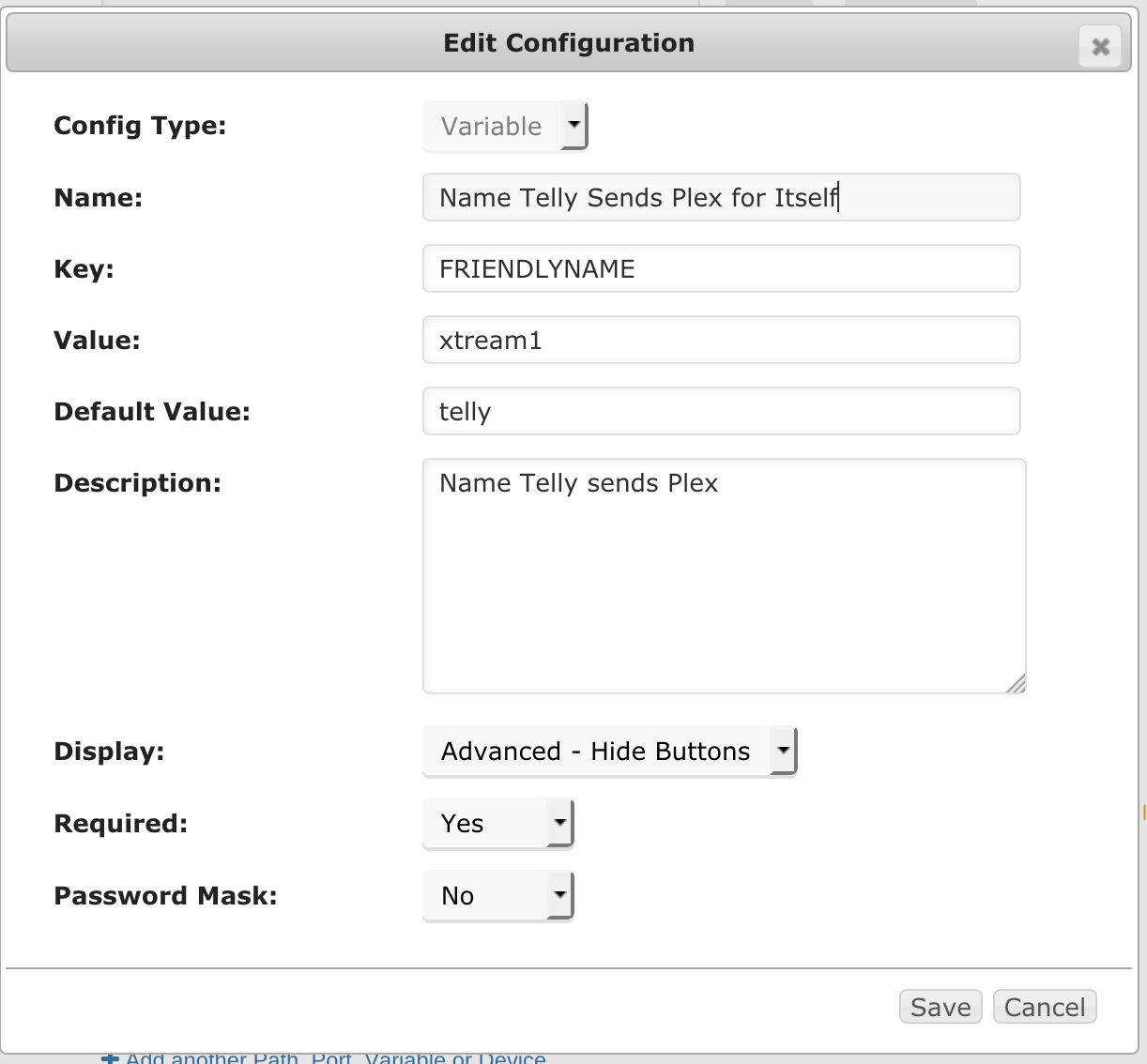

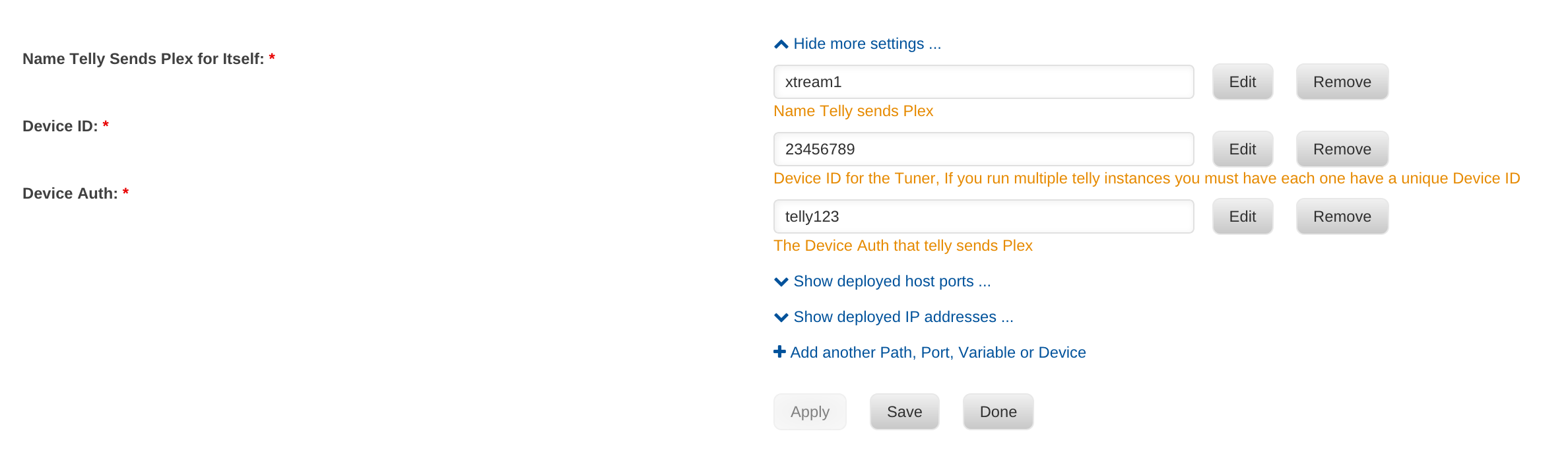

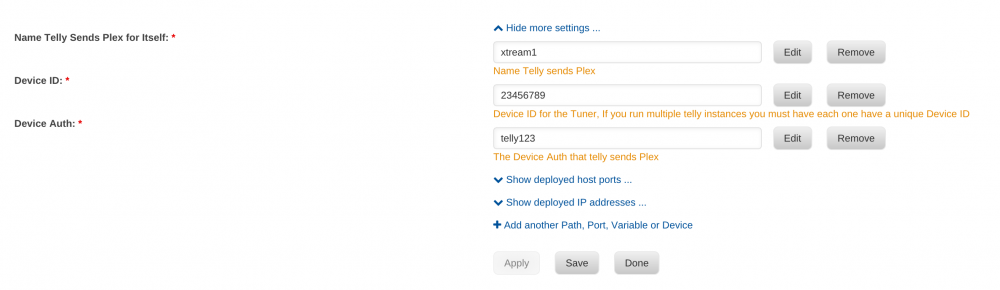

So maybe there is a new template, otherwise just add the variables but I have unique Device IDs and name and stuff.
how did you get that screen? I am in advanced view
I think I custom created those, can you check and see if the new template has those variables?    Otherwise just add the Device ID Variable to your template, im thinking maybe your template is older or it is not something that has made it to the official template yet.
5aa85c3352d7f_Screenshot2018-03-1318_17_45.thumb.png.39075f4f92c1df2cb288e6730a68910e.png5aa85d05299c0_Screenshot2018-03-1318_20_01.thumb.png.07f0d6a7918592fcb12790473e9c7b2d.png5aa85d3618819_Screenshot2018-03-1318_22_04.thumb.png.f7b72951b8a196c43fa1949837cf77ef.png
Edited by manolodf
Nice one mate, it is working after changing the device ID for telly so I can actually have two tuners now...
