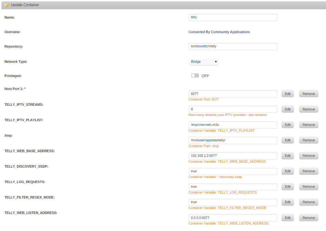

Telly config
Docker run command
Command: root@localhost:# /usr/local/emhttp/plugins/dynamix.docker.manager/scripts/docker run -d --name='telly' --net='bridge' -e TZ="Europe/Berlin" -e HOST_OS="unRAID" -e 'TELLY_IPTV_STREAMS'='8' -e 'TELLY_IPTV_PLAYLIST'='/tmp/channels.m3u' -e 'TELLY_WEB_BASE_ADDRESS'='192.168.1.2:6077' -e '--discovery.ssdp'='true' -e 'TELLY_LOG_REQUESTS'='true' -e 'TELLY_FILTER_REGEX_MODE'='true' -e 'TELLY_WEB_LISTEN_ADDRESS'='0.0.0.0:6077' -p '6077:6077/tcp' -v '/mnt/user/appdata/telly/':'/tmp':'rw' 'tombowditch/telly'

How come your using TVH with it, there's no need to that the whole point of Telly. Also the devs had said there is a bug with amd64 leaving a \ somewhere. This can affect some streams resulting in a 404 until they fix it.
thanks for the info, then i can quit trying ;)
