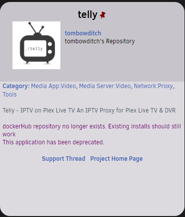

Can't find this in community apps anymore, is this still working?
Set CA to show DockerHub in searches, install from there.
I also cannot find this application. Any assistance?

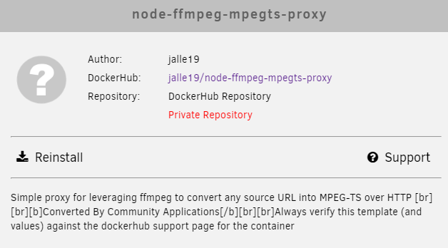

It's the one by jalle19:
Having said that, my advice is to do what I did, dump telly and the proxy and move to xTeVe. Far smoother and more reliable, using the built-in buffer in xTeVe there's no need for a proxy.
Hmm I see. Forgive me my 'skills' in the dept are not the greatest. I have been reading some guides and wiki's to see if I can get it figured out. I will do my best based on your screen above to start (using this container). See if I can get to at least where I can configure it. I get the container installed but I can't seem to connect to [IP][PORT] to start the configuration.
