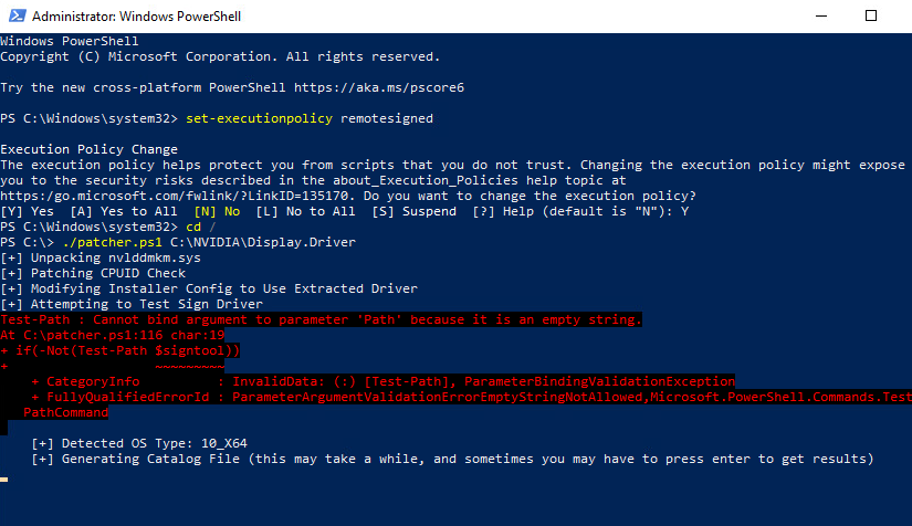

i tried to follow the steps in the 1st post but when cuda was extracted there wasnt a Display.Driver folder for the following powershell command
./patcher.ps1 C:\NVIDIA\Display.Driver
