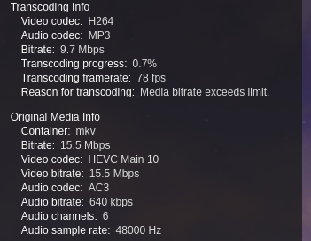

I did. playing a 15Mbps 4K HEVC Main 10 video to a 10mbps 1080p takes ffmpeg only about 12% on one core accdg to top inside the container, 50% accdg to the host.

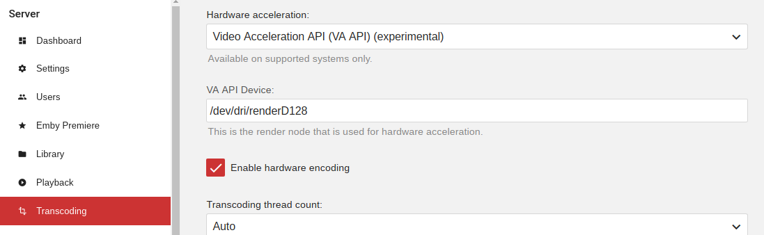

Are you guys using VAAPI instead of QuickSync?

I chose QuickSync jn Emby docker. Is this wrong?
Though I couldn't get an exact statement to quote here, poking around in the emby forums seems to indicate that under linux its better to use VAAPI to perform the HW accelerated decoding / encoding.
Try setting this in the embyserver
Just did that. Unfortunately, the same.

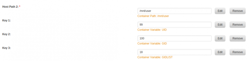

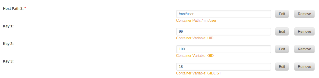

emby/embyserver:latest by default set GIDLIST to 2. Should I  change the value to 18?
Where do I place this line?  Extra Parameters for Emby?
It's an environment variable (here's my setting)
