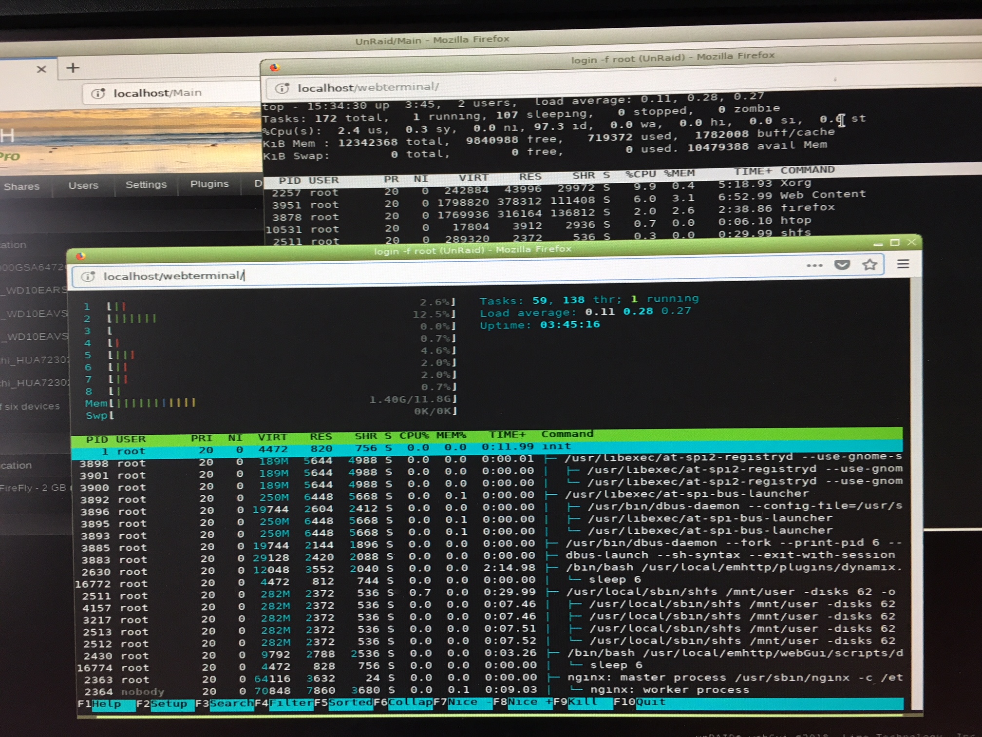

Well I spoke to soon. System froze with uptime 03:45:16 I have attached a screen shot. Since it is frozen I can do a diagnostics.  I did not have sil card installed so no cache so do docker so no fix common problems with maint mode. I have shut down and pulled 2x2GB dimms out s o running 8GB now. Will see what happens. IMG_2911.thumb.JPG.3525b69090980147f1444ed7189d8df3.JPG

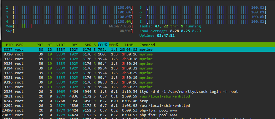

Thanks trurl, I found that after the boot. I am running the troubleshoot mode now while doing a mprime large test. Next step is to flash bios again. then pull all drives and cables boot to unraid and let it sit for a while. Have never booted to unraid with no drives but I assume I can.
So I let the mprime run for 2:30 hrs with no issues cpu should be good. I also have a I3 that I used before getting the E3 and put that in and it froze on that.  I then re-flashed the bios to latest and powered back on. Next will be to pull the drives.
